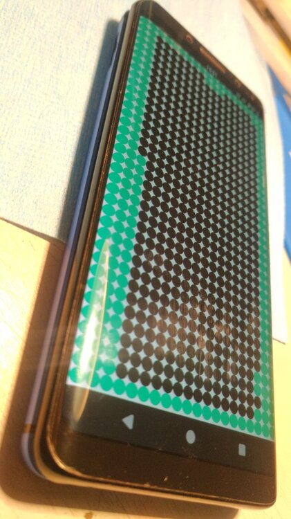

kif 1 Posted December 9, 2023 Share Posted December 9, 2023 (edited) Hi I have recently replaced the screen with one found on Aliexpress, it works but now i have an unresponsive margin on both sides! On this forum I have seen that the problem was known on the Pro1 (see: Display units with large tap-insensitive margin), and the solution was to restore the stock android and boot, that should calibrate the digitizer. I have tried the same on my Pro1X, without any success! So: Does any one know how to calibrate the digitizer on pro1x? Thanks. Edited December 9, 2023 by kif Typos 1 Quote Link to post Share on other sites
Hook 3,315 Posted December 10, 2023 Share Posted December 10, 2023 1 hour ago, kif said: Hi I have recently replaced the screen with one found on Aliexpress, it works but now i have an unresponsive margin on both sides! On this forum I have seen that the problem was known on the Pro1 (see: Display units with large tap-insensitive margin), and the solution was to restore the stock android and boot, that should calibrate the digitizer. I have tried the same on my Pro1X, without any success! So: Does any one know how to calibrate the digitizer on pro1x? Thanks. The problem is the fix for the Pro1 was a patch from the Screen manufacturer that requires Android 10 or less. FxTec was able to incorporate that patch into their version of Android 9. Since the Pro1x starts with Android 11, there is no way to patch the Elephone U screens for the Pro1x. At this juncture, at least as far as I know, there is no fix until FxTec is able to provide replacement screens. 1 Quote Link to post Share on other sites
Hook 3,315 Posted December 10, 2023 Share Posted December 10, 2023 There is one rather insane possibility for anyone who has both a Pro 1 and a Pro1x... install the display first in the Pro1 (probably wouldn't have to even glue it) and flash the firmware of the screen. Then remove it from the Pro1 and install it on the Pro1x. I'm no expert and I'm just guessing, but would that work, I wonder. 2 Quote Link to post Share on other sites
