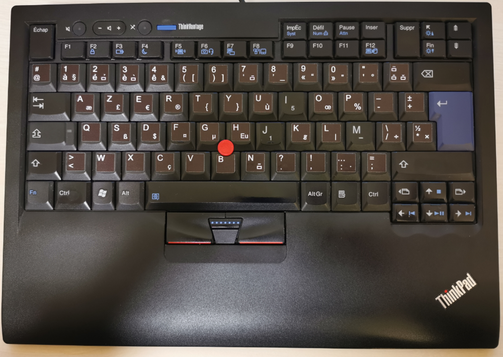

Slion 1,201 Posted March 24, 2021 Author Share Posted March 24, 2021 Converted one of my keyboards to that new AZERTY layout, three to go. It is so much better for typing French and foreign European languages. Since I've been living in Germany for over 16 years I do love the fact the the ß is on the keyboard. What's also really cool is easy access to Greek letters. Makes it a lot easier when writing math and science papers. αβδΔΓ love it… Easy access to ellipsis characters is also awesome. 😁 2 Quote Link to post Share on other sites
Slion 1,201 Posted March 26, 2021 Author Share Posted March 26, 2021 Updated new AZERTY layout proposal so that we have both minus and plus key directly accessible as those are often used as shortcuts. The missing star key primary character is now accessible using shit+plus. Quote Link to post Share on other sites
