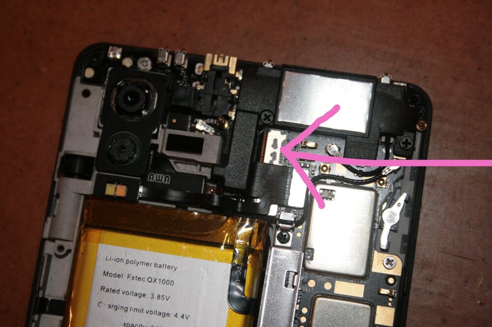

Kzin 33 Posted February 5, 2021 Share Posted February 5, 2021 Hi, just considering taking my pro1 apart, the main camera has stopped working (just shows black) then the app exits. I cannot see A connector in the Teardown photos, is it possible it could have come loose? 1 Quote Link to post Share on other sites
Slion 1,201 Posted February 6, 2021 Share Posted February 6, 2021 On 2/5/2021 at 2:11 AM, Kzin said: possible it could have come loose? I guess so: 1 Quote Link to post Share on other sites

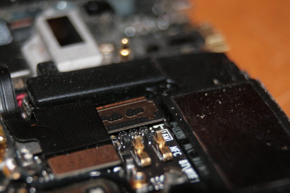

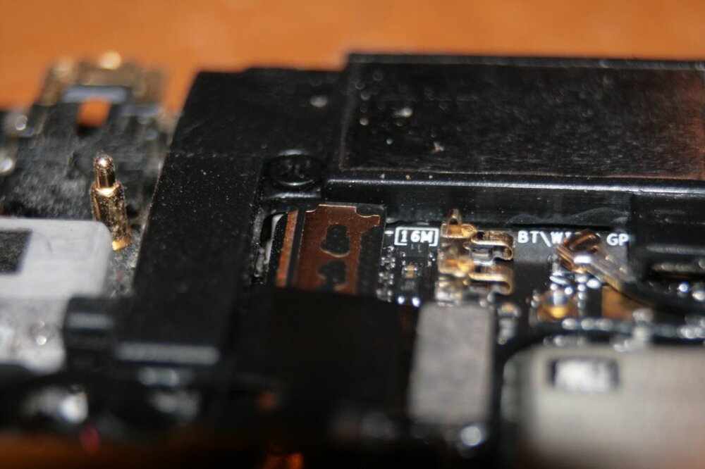

Kzin 33 Posted February 16, 2021 Share Posted February 16, 2021 Yup the Camera connector had come off, I had dropped the phone, it must have landed just right. its the one indicated with the arrow, there is another connector just below and to the right in the photo, once I disconnected that, the Camera connector popped up from the board. But it looks a bit askew in the close up photos. 3 1 Quote Link to post Share on other sites
