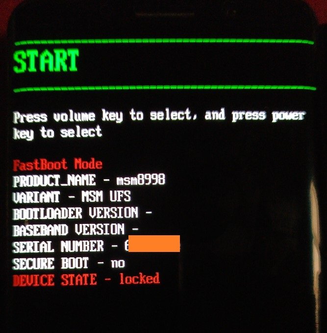

ThiccAl 3 Posted February 12, 2020 Share Posted February 12, 2020 (edited) So I enabled developer options, enabled USB debugging and enabled OEM unlocking. I opened my command prompt as administrator, entered the following: - adb devices (device showed up) - adb reboot bootloader (phone went into bootloader) - fastboot oem off-mode-charge 1 and it returned the following: C:\platform-tools_r29.0.5-windows\platform-tools>fastboot oem off-mode-charge 1 FAILED (Write to device failed (Unknown error)) fastboot: error: Command failed C:\platform-tools_r29.0.5-windows\platform-tools> I'm not stranger to rooting devices and messing with the bootloader, I have no idea what I could be doing wrong, hopefully someone here can think of something. my build number is 20200106110245. my fastboot menu shows the device state is locked, secure boot - no Edited February 12, 2020 by ThiccAl added a little more info Quote Link to post Share on other sites

EskeRahn 5,598 Posted February 13, 2020 Share Posted February 13, 2020 19 minutes ago, ThiccAl said: fastboot oem device-info FAILED (Write to device failed (Unknown error)) fastboot: error: Command failed C:\platform-tools_r29.0.5-windows\platform-tools> Hmm what does the screen look like, it sound like you are not in bootloader mode. It should look somewhat like my image above. What does fastboot devices say? ADD: Can it do a fastboot reboot Quote Link to post Share on other sites
ThiccAl 3 Posted February 13, 2020 Share Posted February 13, 2020 (edited) 31 minutes ago, EskeRahn said: Hmm what does the screen look like, it sound like you are not in bootloader mode. It should look somewhat like my image above. What does fastboot devices say? My screen looks exactly like yours, when I type fastboot devices, it returns with the serial number listed in the fastboot menu .... C:\platform-tools_r29.0.5-windows\platform-tools>fastboot reboot Rebooting FAILED (Write to device failed (Unknown error)) fastboot: error: Command failed C:\platform-tools_r29.0.5-windows\platform-tools> Edited February 13, 2020 by ThiccAl Quote Link to post Share on other sites
EskeRahn 5,598 Posted February 13, 2020 Share Posted February 13, 2020 21 minutes ago, ThiccAl said: My screen looks exactly like yours, when I type fastboot devices, it returns with the serial number listed in the fastboot menu How odd htat you are not allowed to request the device-info?!? Can you send a "fastboot reboot" ? 1 Quote Link to post Share on other sites
