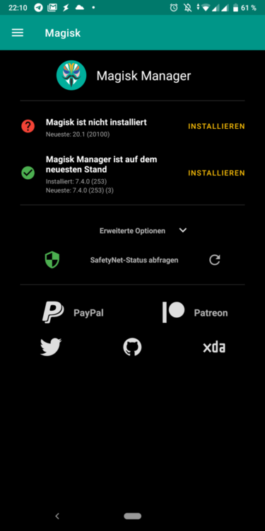

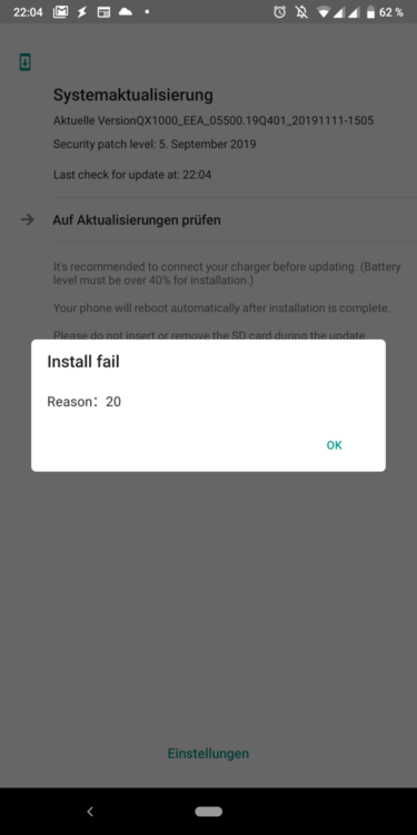

d 27 Posted December 10, 2019 Share Posted December 10, 2019 A few days ago, I flashed a patched boot image to boot_a. I used the image from here and patched it with the Magisk app. It worked wonderfully, I had root and the phone would pass safety net checks. After flashing the patched boot image, I backed up boot_b. Today I got the OTA notification and switched to slot b using fastboot --set-active=b and then rebooted and tried installing the OTA, I got the following error message: Install fail Reason: 20 Magisk is not active on slot b, so why can't I install the update? 1 Quote Link to post Share on other sites

d 27 Posted December 10, 2019 Author Share Posted December 10, 2019 Ah, damn. While reading your link I remembered that I've used Adaway and thus modified a system file. That is probably why the OTA fails. Thank you! Quote Link to post Share on other sites
mcdinner 375 Posted December 10, 2019 Share Posted December 10, 2019 Oo, adaway is enough to kill OTA? Think I have not used stock Rom in such a long time that I forgot all problems. 😄 Quote Link to post Share on other sites
d 27 Posted December 10, 2019 Author Share Posted December 10, 2019 Magisk does not modify any system files, but adaway modifies a hosts file, so the integrity checks fail. At least that's how I understand it. I'll be restoring the factory rom and then installing the OTA updates to slot a. Quote Link to post Share on other sites
