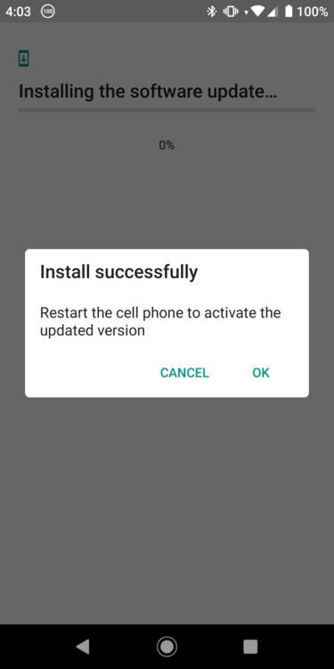

david 929 Posted March 5, 2020 Share Posted March 5, 2020 6 minutes ago, Laska said: Does anyone update with magisk root? I am rooted with magisk. I am doing a backup of my apps and settings before I do the update (just to be safe...that has nothing to do with being rooted). I'll then tell Magisk Manager to disable root, do the OTA, not reboot, and then tell Magisk Manager that the OTA is done, then reboot. If the OTA is flaky and forces a reboot in the middle of the update, I'll lose root and will have to manually re-root the phone. I'm hoping that doesn't happen. I should be able to report my results in the next hour. 2 Quote Link to post Share on other sites

david 929 Posted March 5, 2020 Share Posted March 5, 2020 (edited) 4 hours ago, david said: I am rooted with magisk. I am doing a backup of my apps and settings before I do the update (just to be safe...that has nothing to do with being rooted). I'll then tell Magisk Manager to disable root, do the OTA, not reboot, and then tell Magisk Manager that the OTA is done, then reboot. If the OTA is flaky and forces a reboot in the middle of the update, I'll lose root and will have to manually re-root the phone. I'm hoping that doesn't happen. I should be able to report my results in the next hour. It worked. OTA info screen: I then went into Magisk Manager and uninstalled it, telling it to restore the previous image. Next, started the download for the OTA: One interesting thing was that it automatically started installing after the download. I thought in the past that it gave you an option tap something to start the install after the download was done, but I could be mistaken about that. This means it is important to uninstall Magisk before even starting the download. It also showed 100% complete immediately after the download was complete and the installation started. However, there was a notification for the install, so I tapped on that and then got this screen: After a while, without any progress bar change, that changed to: Be very careful at this point. You aren't just responding "OK" to the message. If you tap "OK", it will restart the phone. I'm guessing "CANCEL" will not restart the phone, but I didn't test that. At this point, without tapping either button, I went back into Magisk Manager and told it to install Magisk, picking the "Install to Inactive Slot (After OTA)" option. It then did the Magisk install over the top of the OTA, in the inactive slot, backing up the boot image first, so that it is ready to do this whole process again with the next OTA: I then went back into the OTA screen and tapped "OK", causing it to reboot. That could have been done in the Magisk Manager screen with the yellow Reboot button or I could have manually done it with the power button. The method of reboot shouldn't matter at this point. After rebooting: And root was maintained, which is the whole point of this exercise. NOTE: You have to originally achieve root in the proper way for this method to work. And that proper way is for Magisk Manager to be given a non-patched boot image file that is identical to the one you are currently using. It will make a backup of that file (for later use in the OTA process) and will also create a patched version of that file. You then copy that patched file to your PC and use fastboot to flash it. (https://android.gadgethacks.com/how-to/make-ota-updates-easy-by-rooting-your-pixel-3-with-magisks-boot-image-patch-0189139/) If you don't go through the proper steps to acquire root with Magisk Manager, then you won't be able to use the Magisk Manager features to survive the next OTA update. SUB-NOTE: Technically there is a way to hack it and give Magisk Manager a backup boot image that it didn't backup itself, but I haven't tried that. https://forum.xda-developers.com/pixel-4-xl/how-to/guide-alternative-method-applying-ota-t4023175 If you attempt this, there has been a change to where Magisk Manager stores its backup images now. They are now at /data/magisk_backup_(hash)/boot.img.gz instead of having the .gz file right in /data. Also read the comments about changing the recoverymode variable in the config file to false if it is true. If anyone is in a phone state where they don't have root and have the 20200304 firmware on their phone, and they want to root it, let me know and I can upload the boot image for the 20200304 firmware so that you can have Magisk Manager patch it, etc. Edited March 6, 2020 by david 6 Quote Link to post Share on other sites
EskeRahn 5,596 Posted March 5, 2020 Share Posted March 5, 2020 8 minutes ago, david said: It worked. It would be easier to read if you sorted them chronologically... *LOL* 1 Quote Link to post Share on other sites
david 929 Posted March 5, 2020 Share Posted March 5, 2020 9 minutes ago, EskeRahn said: It would be easier to read if you sorted them chronologically... *LOL* I uploaded them from my phone and posted it as-is, and then edited the post on my laptop. You caught it in between my edits. :-) 1 1 Quote Link to post Share on other sites
Craig 1,435 Posted March 5, 2020 Author Share Posted March 5, 2020 @david just documented a walkthru of the procedure to update stock to the March 4th OTA while keeping magisk root: https://community.fxtec.com/topic/2849-new-ota-update-stamped-2020-03-04/?do=findComment&comment=46403 1 2 Quote Link to post Share on other sites

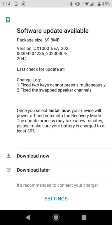

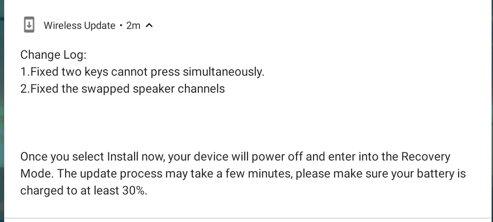

SirBaconIII 66 Posted March 5, 2020 Share Posted March 5, 2020 30 minutes ago, david said: It worked. Thanks for being the guinea pig here. I got this notification about the ota, and the part about it restarting to recovery to apply the update made me think this update would force a restart before installing. Glad to know that isn't the case. Quote Link to post Share on other sites
david 929 Posted March 5, 2020 Share Posted March 5, 2020 14 minutes ago, SirBaconIII said: Thanks for being the guinea pig here. I got this notification about the ota, and the part about it restarting to recovery to apply the update made me think this update would force a restart before installing. Glad to know that isn't the case. Yeah, I forgot to comment on that. That message was really weird. There is no "Install now" button to select. And why in the world would it go into Recovery Mode to install an OTA update to an A/B device, since the whole point is that you can install it while you are using the phone and not need to restart until you want to. :-) Quote Link to post Share on other sites
