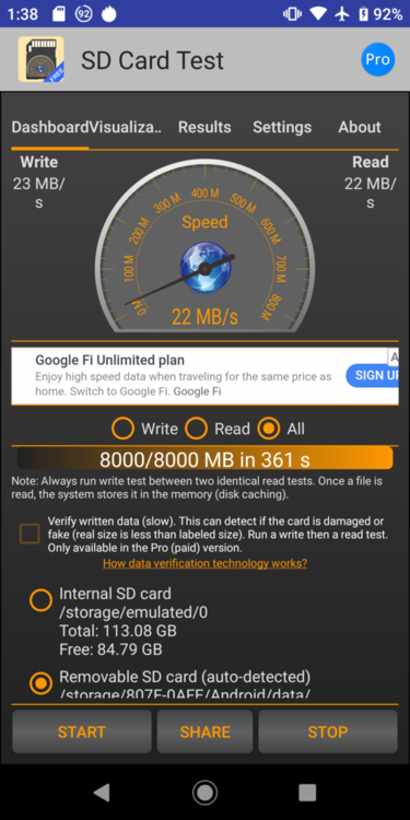

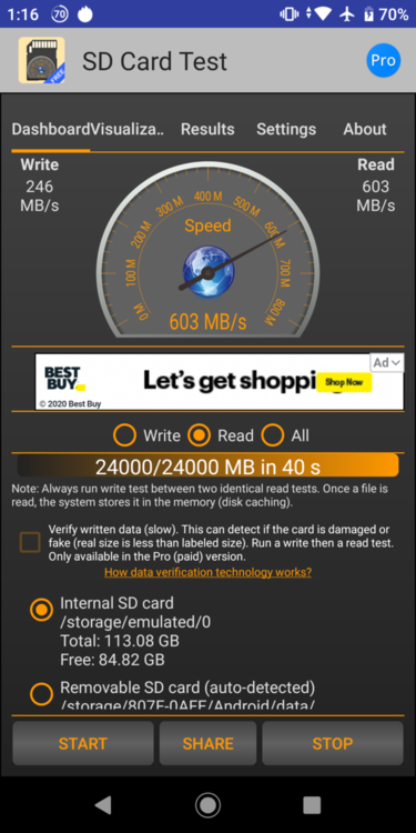

david 929 Posted January 28, 2020 Share Posted January 28, 2020 More test results from another app. The internal tests may be skewed due to caching. I don't know. But the external SD card shows the same slowness. For some reason the test starts out faster on the SD card and then slows down over time (for writes). I'm guessing caching has something to do with that. Internal storage: SD card: Quote Link to post Share on other sites
david 929 Posted February 11, 2020 Share Posted February 11, 2020 (edited) I have verified that the SD card is still operating very slowly on my Pro1, even with the latest OTA (20201006). It is unfortunate, because I'm pleased with the speed of everything else with this phone. The writes should be at least twice as fast and the reads should be about 3 or 4 times faster, with the card I'm using (even taking into account that SD cards are slower in phones than through USB 3 card readers on PCs). Edited February 11, 2020 by david Quote Link to post Share on other sites
