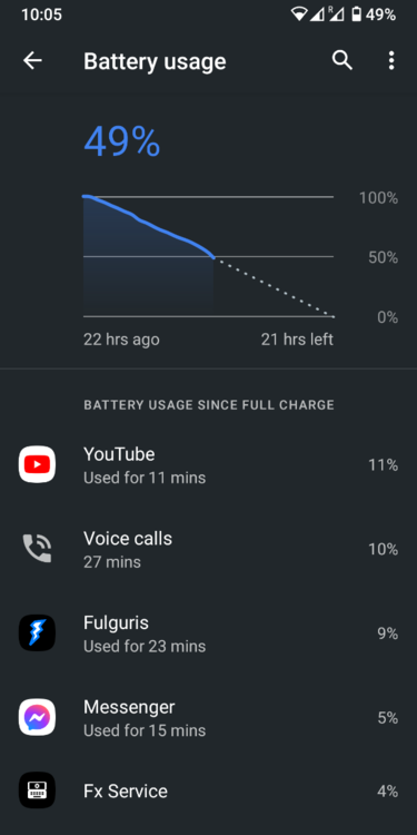

Slion 1,201 Posted October 13, 2021 Author Share Posted October 13, 2021 (edited) One thing you should know is that the smart case screen wake up feature using the proximity sensor causes a significant drain of the battery. My guess is that it somehow prevents the device to go into deep sleep. I reckon it could drain around 8% of the battery from a full charge. I simply disabled it. Edited October 13, 2021 by Slion 1 Quote Link to post Share on other sites
EskeRahn 5,598 Posted October 13, 2021 Share Posted October 13, 2021 1 hour ago, Slion said: One thing you should know is that the smart case screen wake up feature using the proximity sensor causes a significant drain of the battery. My guess is that it somehow prevents the device to go into deep sleep. I reckon it could drain around 8% of the battery from a full charge. I simply disabled it. I do not use it either. But thanks for the warning to those that do. (there are no measurable costs for the function detecting a close with the HAL-sensor though) 1 Quote Link to post Share on other sites
