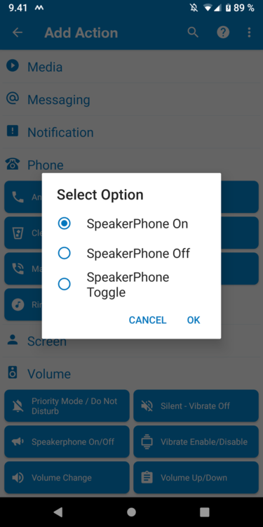

FlyingAntero 871 Posted August 9, 2020 Share Posted August 9, 2020 35 minutes ago, Slion said: I wished it would switch to speaker phone while opening the keyboard during a call. Phone app landscape mode support is also missing while on a call. I'm pretty sure E7 would do that too. That could also be done with MacroDroid and Keyboard/Button Mapper. Atleast there is a setting for it but I did not test it. 1 Quote Link to post Share on other sites

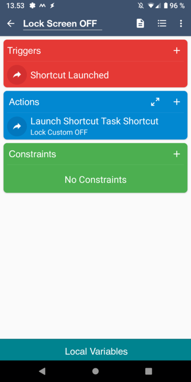

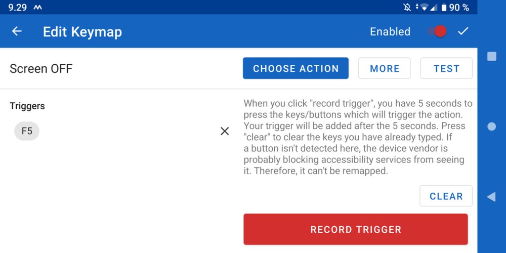

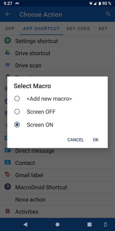

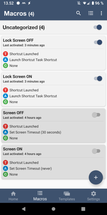

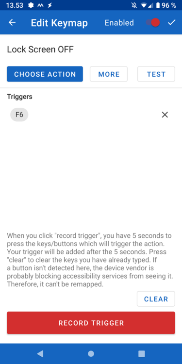

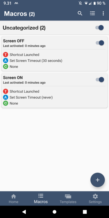

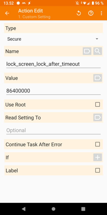

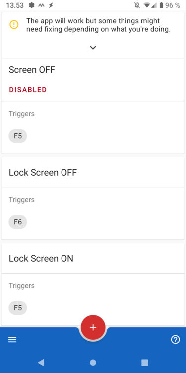

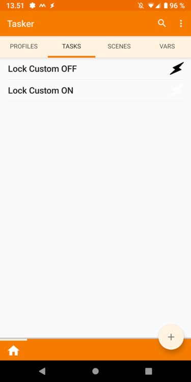

FlyingAntero 871 Posted August 9, 2020 Share Posted August 9, 2020 (edited) 8 hours ago, FlyingAntero said: This could be possible with Tasker. Please, check the guide from below for reference. Obviously the trigger has to be changed from WiFi to keyboard state. According to the comments the max delay for screen lock is 30min in Android Pie for AutoTools. Alternatively you can use Custom Settings action for longer delay. Permissions needs to be tweaked via ADB. Disable and enable your lock screen at will (No Root!) BTW, have you tried Smart Lock? It can be very handy also. This method works! I just tested it 😎. Here is a video. I will write a tutorial later if you guys are interested. The delay for screen lock can be as long as you want but the system is only able to show max 30min in the UI. Needed apps: Tasker MacroDroid Keyboard/Button Mapper For some reason Keyboard/Button Mapper is not able to launch Tasker shortcuts so I had to make MacroDroid macro that triggers Tasker. Then I used Keyboard/Button Mapper to trigger MacroDroid. Chain reaction: Keyboard/Button Mapper -> MacroDroid -> Tasker Edited August 9, 2020 by FlyingAntero 3 Quote Link to post Share on other sites
