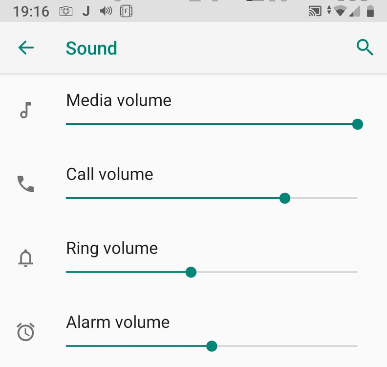

Oops. Today I do not hear the other persons when I receive a call. I hear my phone ring, answer it and it connects. The other person hears me fine. However I do not hear the other person. My current fix is to activate the "loud" speaker during the call by pressing the button. Then I can hear what the other person is saying.
I am wondering whether this is a hardware or software issue. Can I run a test to determine this? I am ready to try different things before I contact support.
Is there two different types of loudspeakers on the phone? Can I conclude something from the fact that when I activate the loudspeaker I can hear the other person?
I do not remember doing anything special with the phone in the past days. I connected a bluetooth headset yesterday. I have tried to create a silent mode sound profile with the app sound profile.
What I tried so far (Unsucessfull)
- Shut down restart.
- I did a small test in settings - sound. I adjusted the volumes for media, ring, alarm (see picture below). Every time I hear the new set volume. However when I adjust the volume for call, no sound happens!
- I deleted apps related to sound such as sound profile.
- I am not in "do not disturb mode".
- I cleared the cache of app "Phone"
- I unactivated "bluetooth" and reactivated it
I am on unrooted android stock with all updates.
