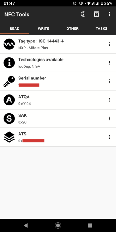

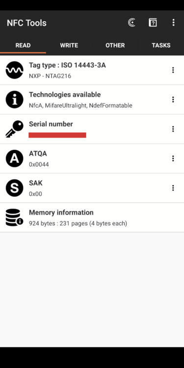

EskeRahn 4,891 Posted August 20, 2022 Share Posted August 20, 2022 I also read a NFC-tag on the late sample Pro1X. I have two other tags that can be read by the Pro1, but NOT the Pro1X. I edited the title slightly. This tag works on Pro1X, Pro1 (and Titan Slim also on stock Android 11) This tag I only managed to get to work once(!) a few times with the Pro1X after maybe once every 100 retry. Else i get "NFC read error. Try again." (Pro1 & Slim OK) Have not been able a really hard time to get this one to work at all on the Pro1X. (Pro1 & Slim OK)But I CAN get it working, holding it exactly right! 2 1 Quote Link to post Share on other sites
EskeRahn 4,891 Posted August 21, 2022 Share Posted August 21, 2022 I tried to look a little closer at the antennas The simple foil tag (outer circle about 25mm): Put light through the travellers card and the credit cards to see antenna structure of the two cards. (and recreated in paint, not exact measurements at all) This is the one that is seen but is really hard to get working And this one with a fairly complex antenna loop is usually completely ignored, but I CAN get it working, holding it exactly right! (all three works flawlessly on the Pro1) Quote Link to post Share on other sites
EskeRahn 4,891 Posted August 21, 2022 Share Posted August 21, 2022 I got all three working, after studying the antennas, and it is really picky on how it is placed for the credit cards with the 'large' antennas. 1 Quote Link to post Share on other sites
EskeRahn 4,891 Posted August 21, 2022 Share Posted August 21, 2022 Danish passports with chips has an antenna like the travellers card above, and has the same issues. Can be read by the Pro1X, but not easily. I would guess it is the same system for all (or at the least many) countries with passports with chips. 1 Quote Link to post Share on other sites
