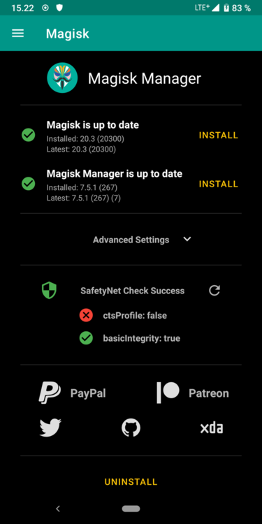

auvo.salmi 135 Posted March 12, 2020 Share Posted March 12, 2020 I was going to flash latest LOS image but tdm's repo seems to be down. So I decided to give a try to Magisk instead. Easy install with adb sideload, and seems that it works. Tested all my apps that didn't work due to 'rooted device', and all of them seem to work now. Magisk's safetynet test gives ctsProfile failure, is this something I have failed or is it related to SELinux state in LOS for example? Quote Link to post Share on other sites
