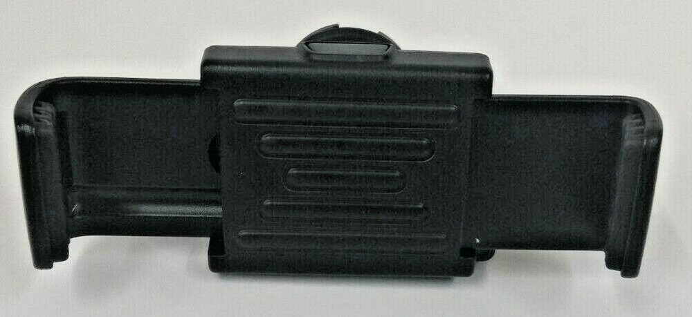

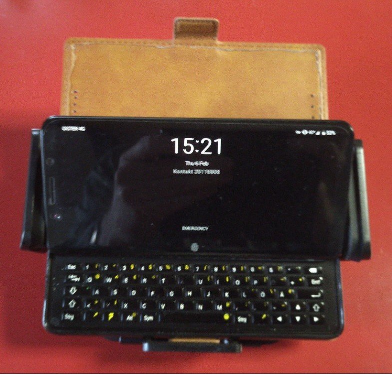

EskeRahn 5,592 Posted February 6, 2020 Share Posted February 6, 2020 A cheap tablet holder like this would also do the trick, looks a little huge if used closed. But if opened in a flip case it is just fine. Quote Link to post Share on other sites
brunoais 335 Posted February 7, 2020 Share Posted February 7, 2020 I don't have the phone yet but I intent to use the one I already own. It can rotate indefinitely and it can optionally grab just the main body while keeping the screen loose Quote Link to post Share on other sites
EskeRahn 5,592 Posted February 7, 2020 Share Posted February 7, 2020 1 hour ago, brunoais said: I don't have the phone yet but I intent to use the one I already own. Nice. Does it have some support plate that can swing out at the bottom? Otherwise it will have to hold quite firm for it not to slip down during small bumps and vibrations while driving? Quote Link to post Share on other sites
brunoais 335 Posted February 7, 2020 Share Posted February 7, 2020 8 hours ago, EskeRahn said: Nice. Does it have some support plate that can swing out at the bottom? Otherwise it will have to hold quite firm for it not to slip down during small bumps and vibrations while driving? It holds the phone firmly. To avoid sliding, it has rubber in 3 places. Both clamps and the back. Those stripes on the holders and stripes on the back are soft ("sticky") rubber. 1 Quote Link to post Share on other sites

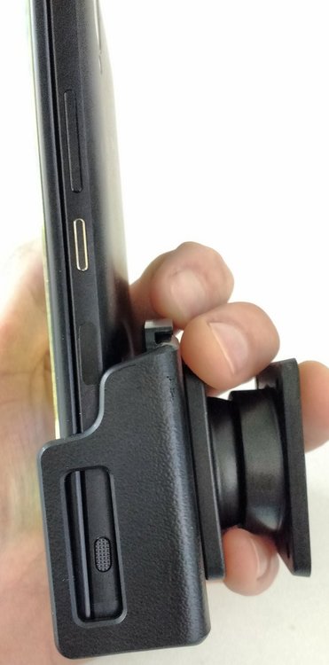

Rob. S. 1,667 Posted March 17, 2020 Author Share Posted March 17, 2020 4 hours ago, altwouss said: @Rob. S. What did you end up using? Unfortunately, I still don't even have the phone... My plan is to try the 711042 Brodit holder I already have, as the period for returns is long since over, and if it doesn't work out, I'll order the 511309 Brodit holder, too. Quote Link to post Share on other sites

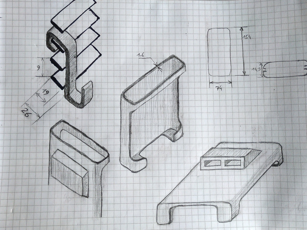

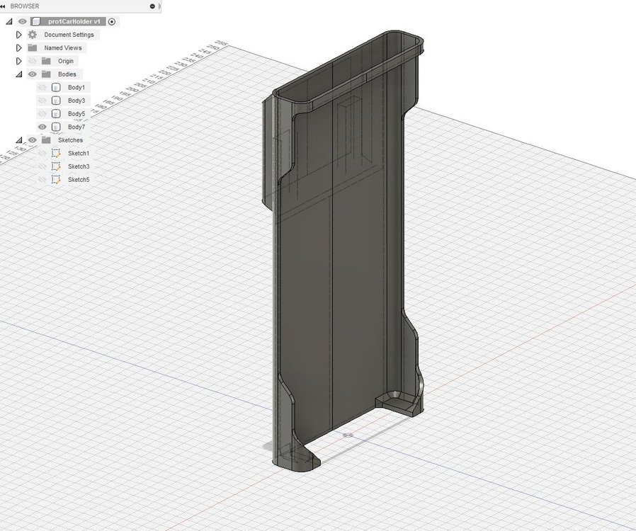

Muth 132 Posted March 22, 2020 Share Posted March 22, 2020 On 12/28/2019 at 6:58 PM, Rob. S. said: I guess this would be a case for a 3D printer. Unfortunately I'm not really into that... So, I give it a try. I draw something like that : To be hooked in the ventilation blades 4 1 Quote Link to post Share on other sites

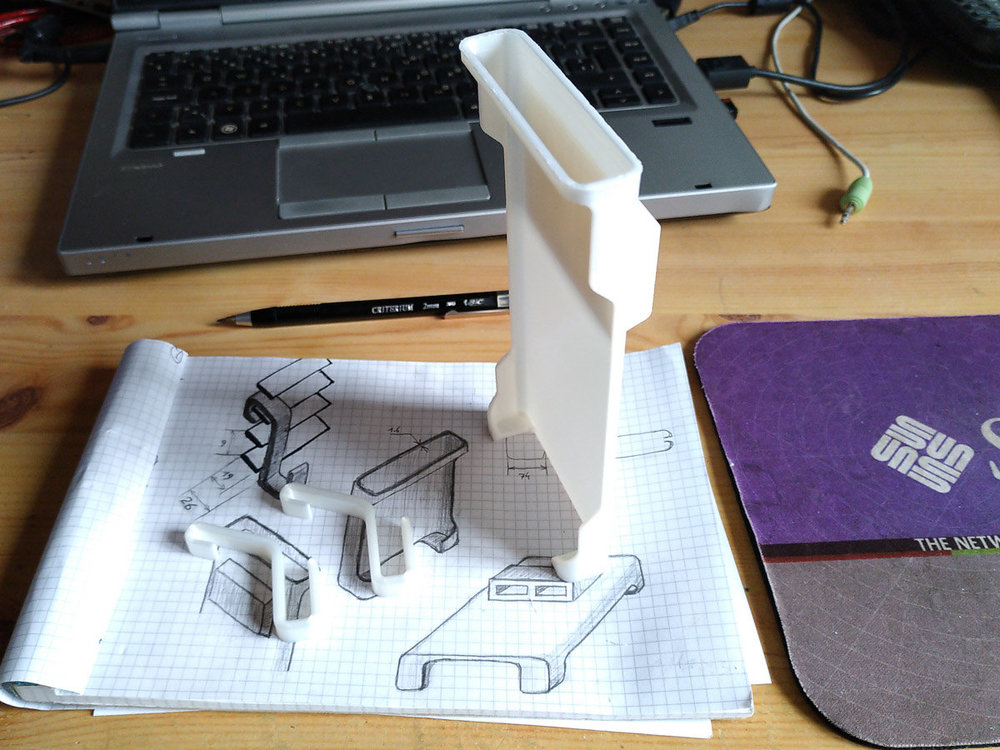

Muth 132 Posted March 22, 2020 Share Posted March 22, 2020 I used Fusion360: Printed on a Prusa I3 mk3: 6 1 Quote Link to post Share on other sites
Muth 132 Posted March 22, 2020 Share Posted March 22, 2020 Seem functional 5 2 Quote Link to post Share on other sites
Muth 132 Posted March 22, 2020 Share Posted March 22, 2020 And adapt quite well 10 1 Quote Link to post Share on other sites
Muth 132 Posted March 22, 2020 Share Posted March 22, 2020 3D Files are here : https://www.thingiverse.com/thing:4236222 (thingiverse is quite slow today) 10 Quote Link to post Share on other sites

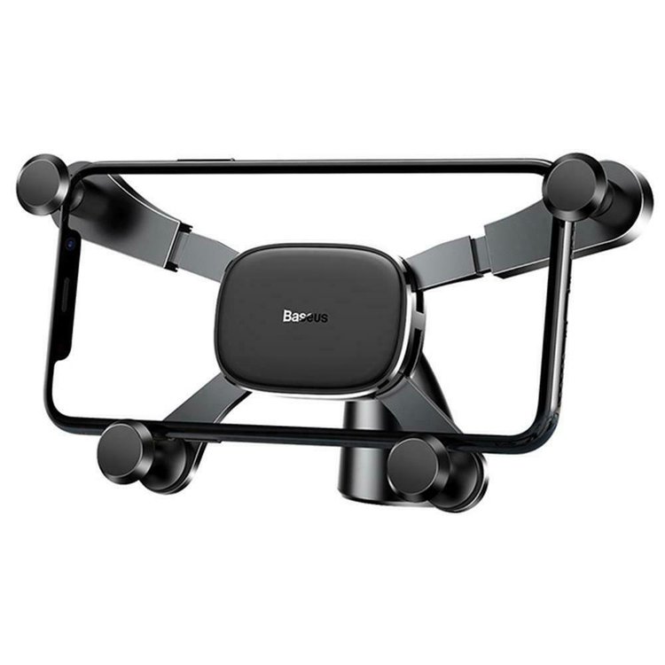

EskeRahn 5,592 Posted March 24, 2020 Share Posted March 24, 2020 I think the gravity idea is the best. Unfortunately most only do either landscape or portrait. And the landscape ones are not that common out there. I have found just two claiming to do BOTH though. I found this but also this kids friendly design. For both I assume the feet needs to be modified for the USB plug in portrait The pure landscape I only found in one version, e.g. sold here. Many of the portrait ones will interfere with the buttons and/or the USB plug, so a bit of search and trial&error can be expected. Ordered this. 2 Quote Link to post Share on other sites

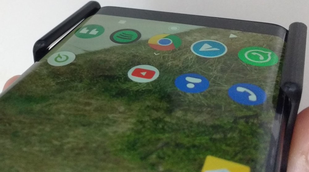

altwouss 22 Posted March 26, 2020 Share Posted March 26, 2020 (edited) So I got the holder, as you can see the buttons are fine with this one, you may need to be careful with the camera button though. You can even use the fingerprint unlock. So 9-13mm might still be a bit too much. I am going with it, as the room is only minimal I might fill the edges with some rubber feet I have lying around. But @Rob. S. yours might fit exactly. Edited March 26, 2020 by altwouss 2 1 Quote Link to post Share on other sites
