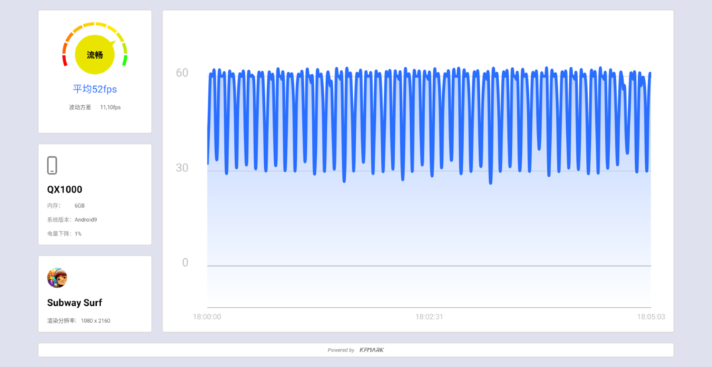

 monitored couple game sessions with KFMark and noticed that Pro1 has indeed some issues with gaming performance. The phone cannot keep up steady FPS during game play because CPU freqs goes up and down all the time. To me it looks like issue with kernel settings rather than throttling. Here are few gameplays compared to the Redmi Note 4 which has much weaker CPU. Both have FullHD(+) screen so results can be compared.
Light game: Subway Surfers
F(x)tec Pro1: average 52FPS (limit 60FPS)
Redmi Note 4: average 59FPS (limit 60FPS)

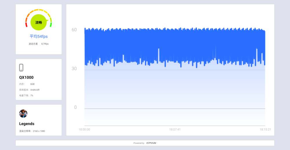

Heavy game: Shadowguns Legends (graphics settings LOW)
F(x)tec Pro1: average 54FPS (limit 60FPS)
Redmi Note 4: average 46FPS (limit 60FPS)

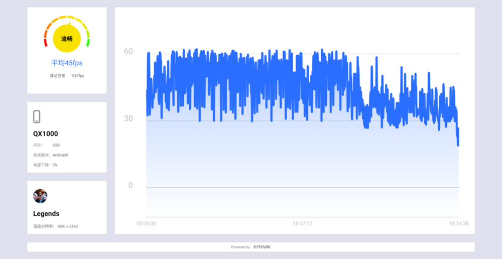

I tried to push Pro1 to its limits by setting graphics to max. Freqs still keeps going up and down but you can now see throttling after 10min of playing.
Heavy game: Shadowguns Legends (graphics settings ULTRA HIGH)
F(x)tex Pro1: average 45 FPS (limit 60FPS)
What I find most interesting is the very first one, the light game.  The redmi seems to handle it fairly well (excluding one glitch, probably some other process or something), whereas our phone is jumping all over the place and can't hold the line.
I'm super curious if lineage does this jumping up and down too.  I looked at the app you used, seems you install a magisk module then the 1.5 apk from github, is that what you did?  Havent looked for subway surfers yet, but imagine that's easy to find?
You can use KFMark without root also but then you need to use ADB via computer to activate monitoring. With root you can just use Magisk module to enable monitoring.
