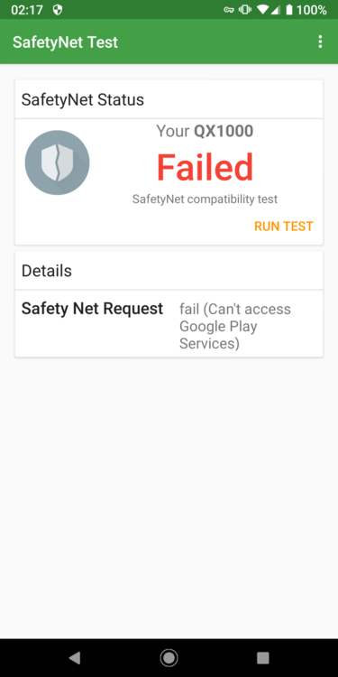

david 929 Posted March 6, 2020 Share Posted March 6, 2020 19 minutes ago, david said: Enabled it again and rebooted. Can see Netflix and pass SafetyNet. But again, requires running the test a second time before it succeeds. In fact, it fails exactly every other time and succeeds every other time. That was using the SafetyNet Test app. I downloaded SafetyNet Evaluation and it passes every time. Magisk Manager's built in checker has worked every time too. I have had the issue with SafetyNet Test failing sometimes in the past, and I think I tracked that down to that a given app can only do a check a limited number of times in a given unit of time. That app is probably more popular, so it exceeds this limit faster than other apps, hence fails sometimes. 1 Quote Link to post Share on other sites

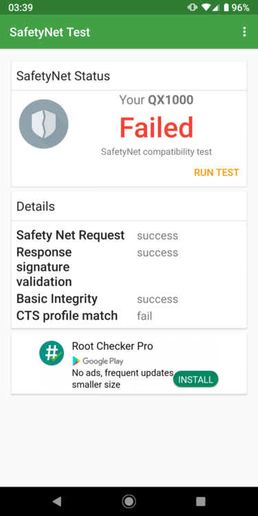

EskeRahn 5,598 Posted March 6, 2020 Author Share Posted March 6, 2020 8 minutes ago, Craig said: Safetynet Helper is an ad-free open source alternative for checking safetynet status. https://play.google.com/store/apps/details?id=com.scottyab.safetynet.sample It has worked before, answering red, and later green after it was fixed. But now: 1 Quote Link to post Share on other sites

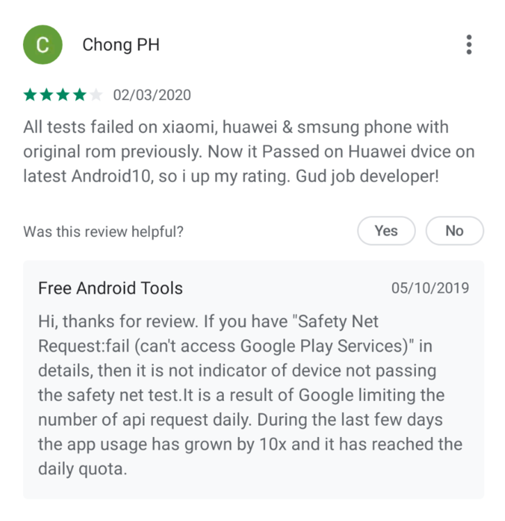

EskeRahn 5,598 Posted March 6, 2020 Author Share Posted March 6, 2020 Chen found this reply that might explain things.... 2 Quote Link to post Share on other sites
david 929 Posted March 6, 2020 Share Posted March 6, 2020 (edited) 6 minutes ago, EskeRahn said: Chen found this reply that might explain things.... Yes, that's what I mentioned above. Thanks for confirming. :-) But to be clear, that doesn't mean the latest OTA firmware is okay. It is still causing a problem with SafetyNet. Edited March 6, 2020 by david Quote Link to post Share on other sites
EskeRahn 5,598 Posted March 6, 2020 Author Share Posted March 6, 2020 4 minutes ago, david said: Yes, that's what I mentioned above. Thanks for confirming. 🙂 But to be clear, that doesn't mean the latest OTA firmware is okay. It is still causing a problem with SafetyNet. Yes we can get two results, both bad: 1 Quote Link to post Share on other sites
