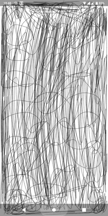

dt.white 62 Posted July 22, 2020 Author Share Posted July 22, 2020 OK, so I received my third display recently after a reversing of the decision by support to only send out a display after me taking a video of the second display with the light bleed. I am happy to say that this display is much better performing than the first two, however it still appears there are some, albeit small, dead zones at each side of the display. It does mean though that it is usable and I think that's the best I can hope for - would be interesting to see if other people who don't have a problem with their display notice any kind of dead zone on theirs? For reference, I've uploaded the videos for each of the displays (1,2,3) based on the order in which I received them, 1 being the one originally shipped on the phone, which you can find at https://1drv.ms/u/s!AvH5kRgzlbHGh90jura1HONnjRAIcA?e=Kd0eJT 1 Quote Link to post Share on other sites
VaZso 1,999 Posted July 22, 2020 Share Posted July 22, 2020 37 minutes ago, dt.white said: For reference, I've uploaded the videos for each of the displays (1,2,3) based on the order in which I received them, 1 being the one originally shipped on the phone, which you can find at https://1drv.ms/u/s!AvH5kRgzlbHGh90jura1HONnjRAIcA?e=Kd0eJT What program do you use for testing? Quote Link to post Share on other sites
dt.white 62 Posted July 22, 2020 Author Share Posted July 22, 2020 6 minutes ago, VaZso said: What program do you use for testing? Autodesk Sketchbook Quote Link to post Share on other sites
VaZso 1,999 Posted July 22, 2020 Share Posted July 22, 2020 47 minutes ago, dt.white said: Autodesk Sketchbook I don't see any problems with my display at all. 1 Quote Link to post Share on other sites
dt.white 62 Posted July 22, 2020 Author Share Posted July 22, 2020 Just now, VaZso said: I don't see any problems with my display at all. You're just rubbing it in now! 😒😂 2 Quote Link to post Share on other sites
