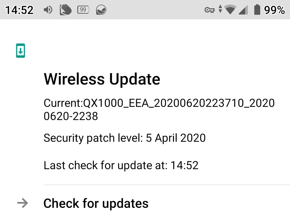

EskeRahn 5,593 Posted June 23, 2020 Share Posted June 23, 2020 Will be interesting to hear from any with this if they are offered (or can fetch) the new 20200620 software just released for OTA. 3 Quote Link to post Share on other sites
MickH 212 Posted June 24, 2020 Share Posted June 24, 2020 (edited) Update came in this morning Edited June 24, 2020 by MickH wrong image inserted. 1 1 Quote Link to post Share on other sites
