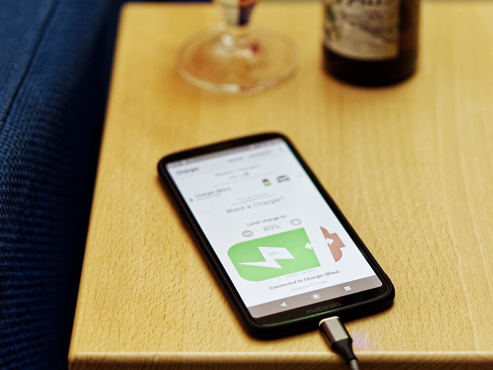

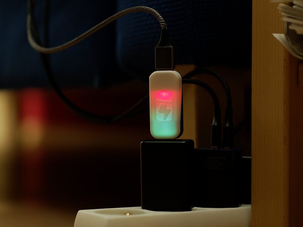

Rob. S. 1,667 Posted February 11, 2021 Author Share Posted February 11, 2021 (edited) Here's a small update. Got the "Chargie" today and the first tests are encouraging. The device seems very much thought through, so far everything works as expected, without much setup at all. The app is well designed and user-friendly. For us geeks, it keeps three hours or so of statistics about what actual charging power is being used to up the charge to the configured limit. If someone insists on quick-charging their phone even though it has a tendency to be detrimental to the battery health the "Chargie" is supposed to preserve, it does that, too, it is even compatible with the non-standard "Turbo Power" quick charge mode of my Motorola phone, which is a rare thing even for third-party chargers and cables. Max specs are 16V/6A. Edited February 11, 2021 by Rob. S. 2 Quote Link to post Share on other sites
