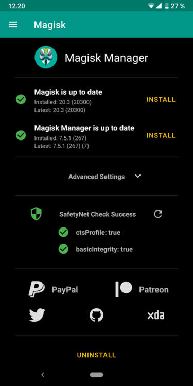

auvo.salmi 135 Posted March 16, 2020 Share Posted March 16, 2020 (edited) 2 hours ago, david said: Which version of firmware and which apps and which safetynet check app? Firmware.. Do you mean android version? Lineage, test9. What else? 😄 Or if you mean magisk, it should be the newest, 20.3 and 7.5.1. Safetynet check, just checked via Magisk. There is two points (see my post little bit above). ctsProfile was failed from the beginning, but the other was passed. Now both of them are failed, and apps like Outlook (there's some protection set by my employer) which detects root) now fail, but they were working before. Edited March 16, 2020 by auvo.salmi Quote Link to post Share on other sites

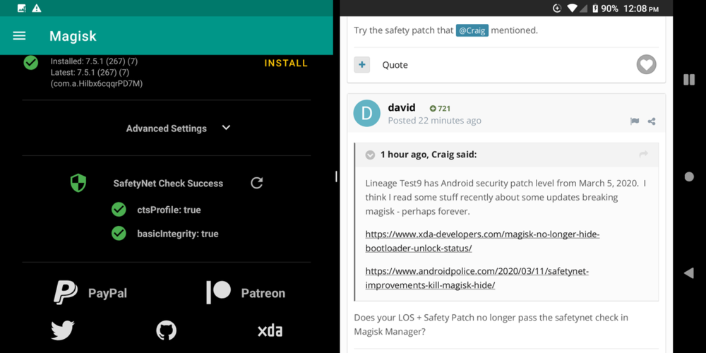

david 929 Posted March 16, 2020 Share Posted March 16, 2020 1 hour ago, auvo.salmi said: Firmware.. Do you mean android version? Lineage, test9. What else? 😄 Or if you mean magisk, it should be the newest, 20.3 and 7.5.1. Safetynet check, just checked via Magisk. There is two points (see my post little bit above). ctsProfile was failed from the beginning, but the other was passed. Now both of them are failed, and apps like Outlook (there's some protection set by my employer) which detects root) now fail, but they were working before. I meant stock firmware, because I forgot you were talking about LOS. But the version of the LOS build helps others to compare too. Try the safety patch that @Craig mentioned. Quote Link to post Share on other sites
david 929 Posted March 16, 2020 Share Posted March 16, 2020 52 minutes ago, Craig said: Lineage Test9 has Android security patch level from March 5, 2020. I think I read some stuff recently about some updates breaking magisk - perhaps forever. https://www.xda-developers.com/magisk-no-longer-hide-bootloader-unlock-status/ https://www.androidpolice.com/2020/03/11/safetynet-improvements-kill-magisk-hide/ Does your LOS + Safety Patch no longer pass the safetynet check in Magisk Manager? Quote Link to post Share on other sites
Craig 1,435 Posted March 16, 2020 Author Share Posted March 16, 2020 20 minutes ago, david said: Does your LOS + Safety Patch no longer pass the safetynet check in Magisk Manager? No, I pass. 3 Quote Link to post Share on other sites

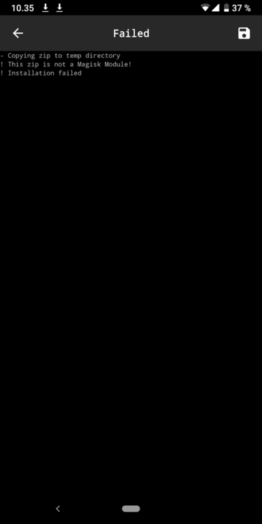

auvo.salmi 135 Posted March 17, 2020 Share Posted March 17, 2020 (edited) 17 hours ago, Craig said: I use a magisk module under LOS called safetypatch that makes it pass. I dont think re-flashing will do anything different. Besides bootloader & root, lineage test versions dont have selinux, unsigned, etc, so more reasons to fail. I tried the safetypatch. Tried to just apply the zip via Magisk modules, and got this. What am I doing wrong / how did you manage to do it? Edited March 17, 2020 by auvo.salmi Quote Link to post Share on other sites
david 929 Posted March 17, 2020 Share Posted March 17, 2020 2 minutes ago, auvo.salmi said: I tried the safetypatch. Tried to just apply the zip via Magisk modules, and got this. What am I doing wrong / how did you manage to do it? I installed it by searching for it under "Downloads" in Magisk Manager and installing it from there. 1 Quote Link to post Share on other sites
auvo.salmi 135 Posted March 17, 2020 Share Posted March 17, 2020 1 hour ago, david said: I installed it by searching for it under "Downloads" in Magisk Manager and installing it from there. Oh. Stupid me, apparently. Now it works! Thanks guys! 1 Quote Link to post Share on other sites
