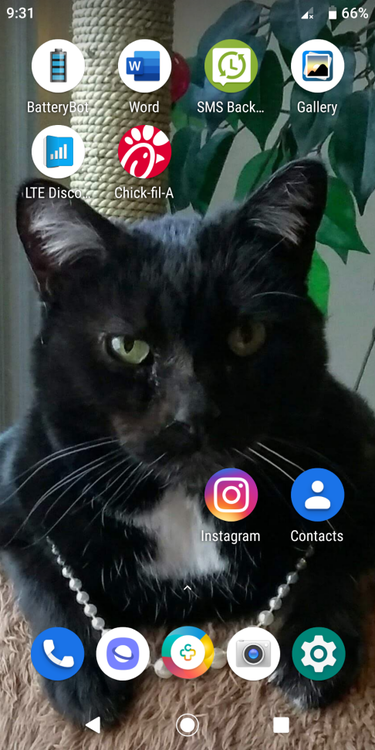

silversolver 849 Posted February 21, 2020 Share Posted February 21, 2020 On 2/20/2020 at 10:42 AM, sequestris said: I don't understand. What fish? Why don't you just touch the back button? KITTY! ❤️ 1 Quote Link to post Share on other sites
sequestris 711 Posted February 22, 2020 Share Posted February 22, 2020 20 hours ago, silversolver said: KITTY! ❤️ That's my Juni-cat. 2 Quote Link to post Share on other sites
netman 1,424 Posted February 22, 2020 Share Posted February 22, 2020 20 minutes ago, sequestris said: That's my Juni-cat. What is a Juni-cat? Quote Link to post Share on other sites
sequestris 711 Posted February 22, 2020 Share Posted February 22, 2020 11 minutes ago, netman said: What is a Juni-cat? Her name is Juniper. I call her Juni. Ergo, she is the Junicat. 2 Quote Link to post Share on other sites
