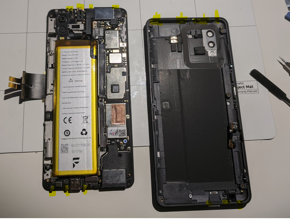

milp 27 Posted January 19, 2021 Author Share Posted January 19, 2021 (edited) I have already tried numerous new sims from other providers, they all worked even worse. However there are good news, i just disassembled the device and made sure all the contact-pads for the aluminum case (which seems to be the antenna itself, gorgeous engineering!) have better contact and all the coax cables are in place - now the 4g reception is a lot quicker and i finally can take calls from my desk again. I now have a similar amount of reception at my desk that i used to have with my old droid 4 🙂 So yeah if anyone else has those problems, you can disassemble it and just make sure the gold connectors touch the aluminium pads of the case by bending them VERY VERY slightly and carefully sanding down the aluminium pads of the case on it's inside. Seeing inside this phone made me fall in love even more. What a beautiful piece of engineering. And those phillips screws! ❤️ Edit: seeing how this can be a potential fix for bad reception - maybe we should collect such fixes in a howto section or some kind of wiki? Edited January 19, 2021 by milp 6 1 Quote Link to post Share on other sites
david 929 Posted January 22, 2021 Share Posted January 22, 2021 (edited) On 1/19/2021 at 6:35 AM, milp said: However there are good news, i just disassembled the device and made sure all the contact-pads for the aluminum case (which seems to be the antenna itself, gorgeous engineering!) have better contact and all the coax cables are in place - now the 4g reception is a lot quicker and i finally can take calls from my desk again. I now have a similar amount of reception at my desk that i used to have with my old droid 4 🙂 So yeah if anyone else has those problems, you can disassemble it and just make sure the gold connectors touch the aluminium pads of the case by bending them VERY VERY slightly and carefully sanding down the aluminium pads of the case on it's inside. Thanks for sharing this. I believe a lot of us have poorer reception with the Pro1 than with other phones. (as well as weaker wifi) I wonder how many of us have this issue just due to poor connections inside between the gold connectors and the aluminum that you mentioned. Do you happen to have any photos of the connectors and aluminum pads? Do you have any before and after screenshots of the signal strength? Maybe even marking up these images with arrows pointing to the parts in question would help. Edited January 22, 2021 by david 2 Quote Link to post Share on other sites
milp 27 Posted January 23, 2021 Author Share Posted January 23, 2021 (edited) I'll see what i can do, unfortunately i can't use the phone to take photos of itself while disassembled. But i had been planning on opening it up again to put a thermal conducting strip on the back of the battery, seeing how it warms up quite a bit during fast charging. I don't have any screenshot of the signal quality but beforehand you would almost never get any reception inside, walking by a radio/scanner you would not hear it transmitting. If i had any reception at all inside it was right at the window and then only like 1 bar of 4G, never anything else. Wifi connection was frequently lost. I would always find 3g access points after a lengthy manual search, but i would never be able to connect to them. Now i always have reception of some sort inside. And the levels are very comparable to what my droid 4 used to have. Edit: Quick update done from memory, i probably missed some points but you should get the general "scheme" of these connectors and the principle of how theyre supposed to contact eachother. I used some fine and some not so fine grained sandpaper and a small flat screwdriver. Also a set of pliers to oh so slightly nudge the gold contacts outwards. Please use care when doing this yourself, i don't take any responsibilities for damage - and i admittedly had ruined my fingerprint sensor cable when reinstalling it - which i don't mind that much since i wasn't keen on using it anyways - let that be a warning xD Edit2: Sorry i accidentally marked the headphone jack - please ignore that Edited January 23, 2021 by milp 1 3 Quote Link to post Share on other sites
VaZso 1,999 Posted January 23, 2021 Share Posted January 23, 2021 2 hours ago, milp said: Edit: Quick update done from memory, i probably missed some points but you should get the general "scheme" of these connectors and the principle of how theyre supposed to contact eachother. I used some fine and some not so fine grained sandpaper and a small flat screwdriver. Also a set of pliers to oh so slightly nudge the gold contacts outwards. As of gold-plated contacts, really should take care of not removing it together with other dust as it will be temporary good but will degrade soon after. So the very slim gold layer should remain in place. Basically, a piece of plain paper is enough instead of sandpaper and will do the job. 1 Quote Link to post Share on other sites
milp 27 Posted January 23, 2021 Author Share Posted January 23, 2021 oh yeah i should have mentioned it, you shouldnt sand those gold connectors down that much, just rough them up a tiny bit and nudge them to go outwards - the aluminium contact plates on the case side however should probably be sanded and roughed up a little 1 Quote Link to post Share on other sites
david 929 Posted January 23, 2021 Share Posted January 23, 2021 6 hours ago, milp said: oh yeah i should have mentioned it, you shouldnt sand those gold connectors down that much, just rough them up a tiny bit and nudge them to go outwards - the aluminium contact plates on the case side however should probably be sanded and roughed up a little That's how I understood your original post. Sand the aluminum, not the gold. Thanks for pointing them out in the photos. Regarding the fingerprint scanner, more information on that here: https://gelraen.github.io/fxtec-pro1-teardown/ That shows the cable here: Quote Link to post Share on other sites
milp 27 Posted January 23, 2021 Author Share Posted January 23, 2021 (edited) Yep, see that corner in the right circle? That's where i ripped it with my bigass "wurstfingers" as us germans would say xD By the way, for opening the case without a scratch, one of those shaving blades that have a grip on one side and a blade on the other, also used for scratching stuff from automotive glass panels, works very well. Edited January 23, 2021 by milp 2 1 Quote Link to post Share on other sites
