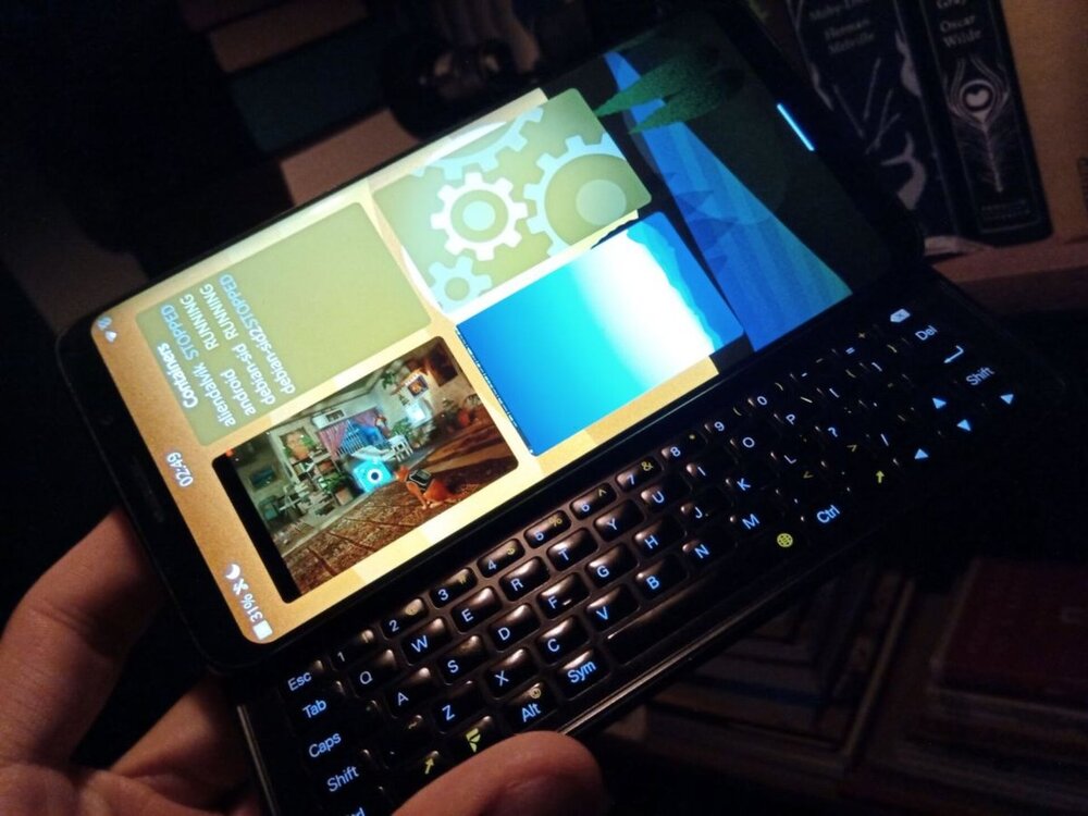

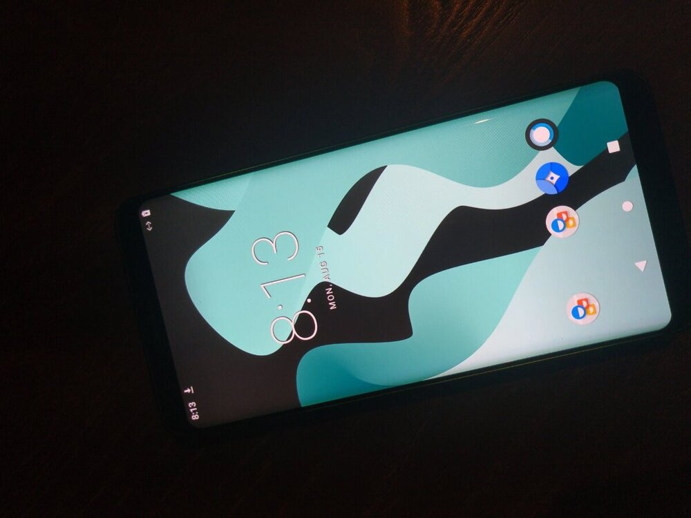

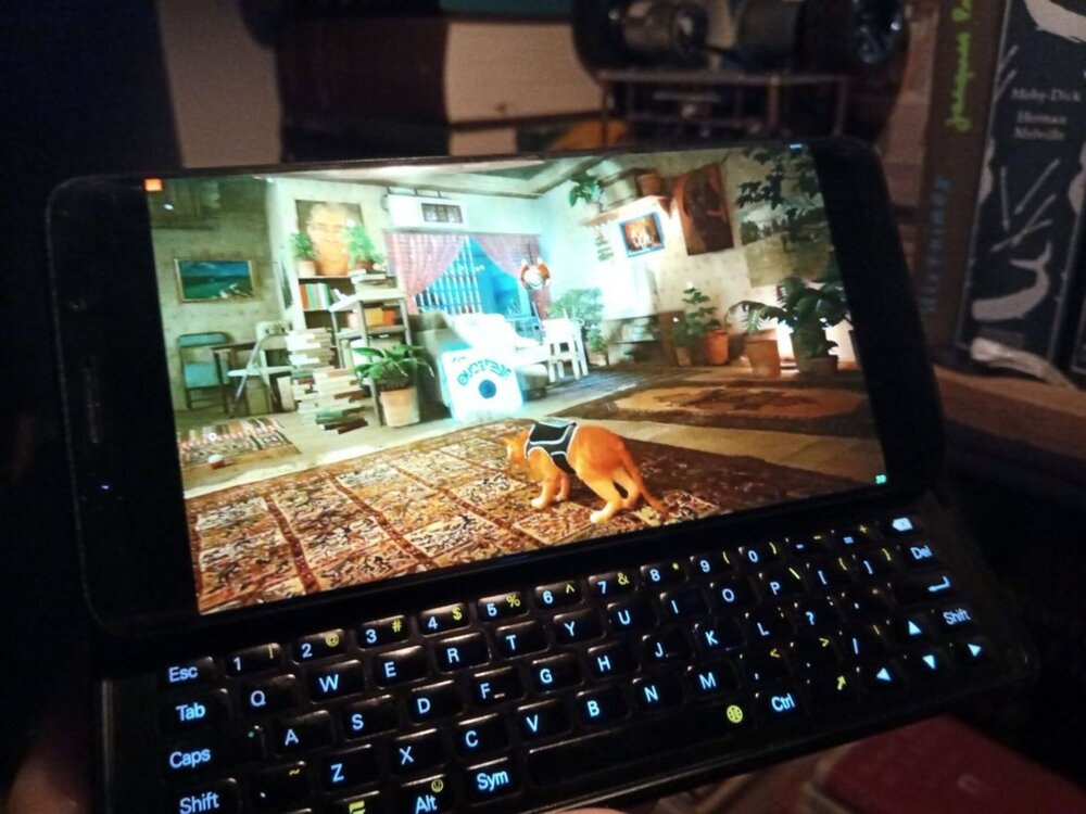

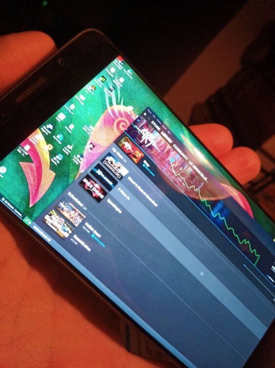

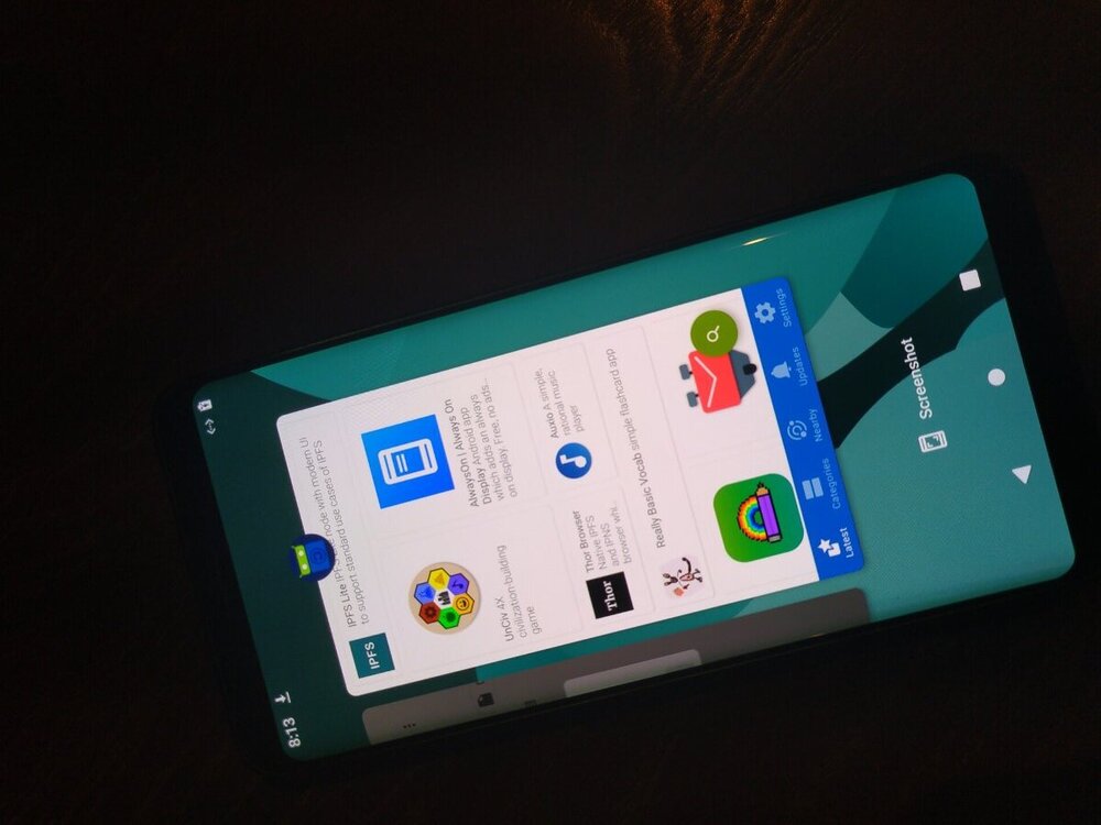

matf-kabouik 414 Posted August 15, 2022 Author Share Posted August 15, 2022 (edited) Adam helped me to get Waydroid to work! And shadow.tech works in Waydroid (no sound nor keyboard, though, so it's somewhat limited): See how to get Waydroid to run on SFOS and what doesn't work: https://github.com/sailfish-on-fxtecpro1/droid-config-halium-qx1050/issues/1#issuecomment-1215734546 The current list of issues after just one hour of use: Camera doesn't work (who cares? But it shows that some hardware is not visible to Waydroid) Vibration does not work Landscape rotation is borked (it just stretches everything) Hardware keyboard does not work (but with the landscape issue, there's little use for it anyway) Could not copy/paste text from the default browser, but text selection and copy works well in Fennec (from F-droid) Adding repos to F-droid makes the application crash; prevents installing microG, among others Closing Waydroid breaks SFOS which has to be hard rebooted However it works well enough for me to be able to install one Nneobank application (which probably doesn't have too strong requirements). Another one installed fine, but throws errors when I log in (I suppose it needs Google Services or microG). Edited August 16, 2022 by matf 2 3 Quote Link to post Share on other sites

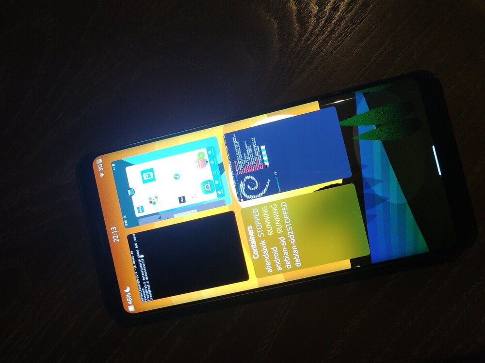

matf-kabouik 414 Posted August 18, 2022 Author Share Posted August 18, 2022 (edited) https://github.com/Kabouik/harbour-containers My PR to harbour-containers has been merged, it should now work much better than the upstream one that was using qxdisplay and, most of all, could no longer configure X in new containers properly. Instructions have been simplified, with just 3 packages to install from one single place (and hopefully from Chum app store soon, I'll submit them today), better default settings for X scaling and Onboard vkb, and most of all without the need to tweak things manually to debug container creation. - 3 packages to install from a single OBS repo, - no need to manually debug things when creating a debian-based container or work around the Xwayland compilation, - dynamic rotation, - sane default settings for X scaling and Onboard (for non-hwkb devices), - simplified instructions, - new icon :O, - no polkit prompts for nothing after boot. Unfortunately, only armv7hl and aarch64 are supported. We used to manually patch sources of Xwayland and build from that, which broke when Xwayland dropped support for autotools. I fixed that issue and the compilation step in the installation script now would work, but it appears that Xwayland sources no longer support a protocol that we need for SailfishOS, so I just plain and simple disabled that whole part of the installation (it's still there in /usr/share/harbour-containers/scripts/guest/setups/debian.sh, but commented out, if some want to play with it). That means we're back to just fetching binaries that were pre-built in 2020, and we only have armv7hl and aarch64 available sadly. I'll make another post if some important changes are made, or if this makes it to the Chum repository for easier installation. X looks like this at first boot now, which should definitely be a lot more usable (but I still advise to configure things to set up as many keybindings as possible to manipulate the WM): Edited August 19, 2022 by matf-kabouik 2 Quote Link to post Share on other sites
