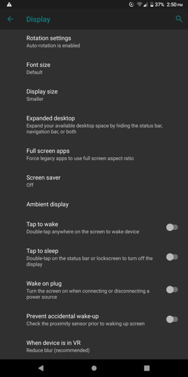

Kabbone 36 Posted February 25, 2020 Share Posted February 25, 2020 first of all, thanks for all your effort you put in this, great work @tdm! I'm not sure if this is still an standard option in the vanilla LOS, but it was available some time ago that you can lock your device by double tapping the notification bar, is this still a thing or is there any other way to lock it without the power button? I'm using mine as a daily driver, that's why I'm still waiting a bit before changing, otherwise I would just have tested this myself. 1 Quote Link to post Share on other sites

Craig 1,435 Posted February 25, 2020 Share Posted February 25, 2020 (edited) 41 minutes ago, Kabbone said: lock your device by double tapping the notification bar, There are settings like that... Edited February 25, 2020 by Craig Quote Link to post Share on other sites

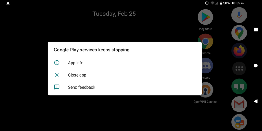

Craig 1,435 Posted February 26, 2020 Share Posted February 26, 2020 (edited) I just installed test7, and gapps not happy. This also happened when I flashed test6, and to fix I flashed mindthegapps again (and then reinstalled each google app i tried one by one cuz they immediately crashed when I ran them after doing so, but flashing mindthegapps got rid of the play services stopping). I'll leave it like this overnight incase there's something I can do to debug it to help others, but phone not very usable in this state cuz even if i click close app, or waiting ~10sec for it to disappear by itself, it just pops back up. Edited February 26, 2020 by Craig Quote Link to post Share on other sites
david 929 Posted February 26, 2020 Share Posted February 26, 2020 How about clearing the cache and data on the play services and the google apps? Quote Link to post Share on other sites
Craig 1,435 Posted February 26, 2020 Share Posted February 26, 2020 (edited) Certainly worth a shot, thanks for the idea David. Other than the fact I somehow bricked myself before I had a chance to try! While it was complaining about google, I used adb root shell to copy over an updated keymap file without extra white space, to see if that solved my F6-F12 issue. Then I used the power button to select reboot. I planned to test function keys, update earlier post about keymap, and call it a night and deal with google tomorrow, perhaps after reading some advice. But it wouldn't boot. Just splash then never-ending boot animation. So I held power button, and when it finally powers off it, it turns itself back on a second later and repeats. So then I tried to get it into bootloader by holding power til it turned off then pushing voldown+power before it turned itself back on. Kept missing the timing and tried a few times (I much prefer to type adb reboot bootloader or select reboot to bootloader from the LOS advanced power menu than try these key combinations btw) and one time when I powered down, it stayed off. And wont come back on. Literal brick. If I wasn't sure I had a half full battery when I took the previous screenshot I might think no juice. I've also tried plugging it into power, nothing. Not even charge LED. Completely dead. edit: resolved As David suggested, I held buttons down a long time and it turned back on. Flashed mindthegapps and it boots again. Edited February 26, 2020 by Craig 1 Quote Link to post Share on other sites
david 929 Posted February 26, 2020 Share Posted February 26, 2020 (edited) Ugh. That sucks. Maybe try holding power and volume down for about 20 or 30 seconds to see if that brings it back to life. I don't know enough about how the LOS build is set up. Can you do any file copying with ADB when you are in recovery? If you can get into recovery, you could possibly mount system in recovery and use ADB to copy the previous version of the keyboard file over. I don't remember if I tried to read anything from /system with ADB when I was in recovery and connected to my computer, so I don't know that is accessible with the stock recovery. Alternatively, have these images changed anything with the fastboot mode to allow ADB through that? (doubtful) If you can get back into fastboot, then you can obviously reflash image files to the various partitions. This all assumes you can get it to boot again into recovery or fastboot mode. If not, it seems you'd have to use @tdm's EDL tool to get it back in working order? Oh, and regarding the boot loop stuff and trying to get back into fastboot mode, I think if you hold power and volume down until it powers down, you can then keep holding down volume down, but release the power button. That assumes it bounces back and powers on automatically. If it is in a mode where it isn't powering on automatically, then you can keep holding both of them, or just keep volume down pressed and press and release the power button to turn it on, but sneak in ahead of anything that is happening too fast for you to get the volume down key pressed in time (since it will have been pressed from before the power on/restart event). Edited February 26, 2020 by david 1 Quote Link to post Share on other sites
