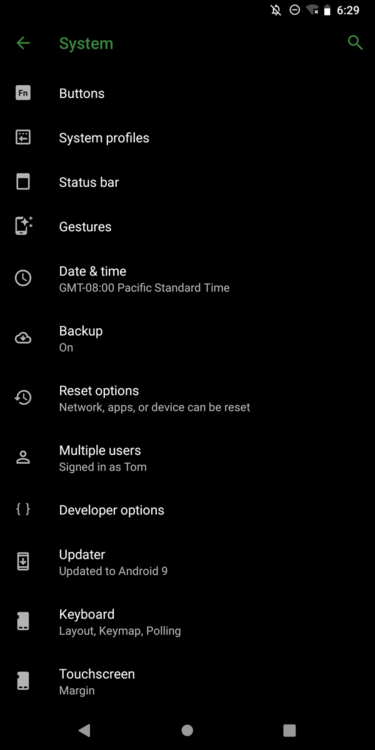

tdm 2,322 Posted February 28, 2020 Author Share Posted February 28, 2020 test8 is up, you know the drill by now. * a2dp should be working. * Added touchscreen margin/deadzone. * Added settings UI for keyboard and touchscreen (Settings -> System -> Advanced). NOTE: if you use a custom keymap (looking at you @Craig) note the keymap file has moved. The reason is that /persist should only be used for things specific to the device that are invariant, eg. physical properties. So it is now read from "/data/system/keyboard/keymap". The file contents are the same, just "mv" the file over to the new location (creating the directory first, of course). But I think I've implemented the stuff that you use as options anyway, so you may be able to just delete the file. Also, UI is not my strong suit. If you have any suggestions on improving how it looks, I'm all ears. 🙂 8 Quote Link to post Share on other sites

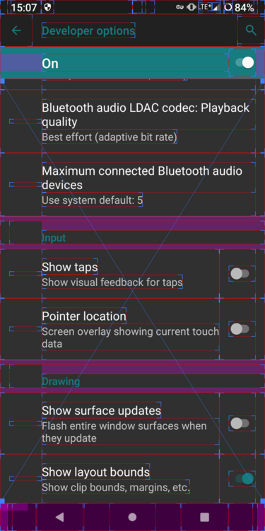

EskeRahn 5,598 Posted February 29, 2020 Share Posted February 29, 2020 How do I activate the new touchscreen margin? I can not find the settings UI for keyboard and touchscreen BTW interesting option in DevOps for testing Quote Link to post Share on other sites
tdm 2,322 Posted February 29, 2020 Author Share Posted February 29, 2020 21 minutes ago, EskeRahn said: How do I activate the new touchscreen margin? I can not find the settings UI for keyboard and touchscreen You should see the options in the system section when you select "advanced". 2 Quote Link to post Share on other sites

EskeRahn 5,598 Posted February 29, 2020 Share Posted February 29, 2020 2 hours ago, tdm said: You should see the options in the system section when you select "advanced". AH! Thanks! Looked around a bit but did not find it. The setting-search does not list them either, is it limited to the build in Lineage stuff, or does it require manually adding keywords? Just curious, what does "Fast poll" do? OH, a TINY request: In the new Margin selection screen, A text saying something like "Restart to activate changes". 1 Quote Link to post Share on other sites
tdm 2,322 Posted February 29, 2020 Author Share Posted February 29, 2020 1 minute ago, EskeRahn said: AH! Thanks! Looked around a bit but did not find it. The setting-search does not list them either, is it limited to the build in Lineage stuff, or does it require manually adding keywords? I believe there is supposed to be code to add those settings into the search results. But I just copy-pasted it from an example and I do not understand it at all. I can investigate. 1 minute ago, EskeRahn said: Just curious, what does "Fast poll" do? That is for the keyboard polling. When no keys are down, the keyboard driver relies on interrupts to detect key presses. But due to the way the hardware is designed, this doesn't work for certain key combinations when a key is already pressed. So, in order to detect two keys down at once, it is necessary to poll for changes. The faster you poll, the quicker the response time and the more CPU is used. So there is a balance to be struck. The default is 40ms, but @netman likes 20ms for gaming, so "fast poll" switches to 20ms. 1 minute ago, EskeRahn said: OH, a TINY request: In the new Margin selection screen, A text saying something like "Restart to activate changes". You need not restart, the change should be immediate. If it is not, there is a bug. Quote Link to post Share on other sites
