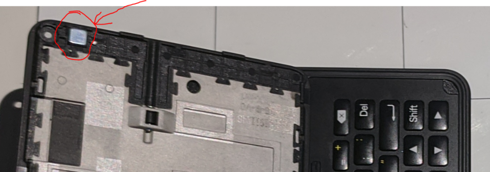

SCĪRECROW 57 Posted October 8, 2020 Share Posted October 8, 2020 @Slion Can I request a user override for the physical keyboard position sensor? My phone has a hardware issue where physical keyboard position sensor is malfunctioning. The phone detects that the physical keyboard is open when it's closed. I can get the keyboard sensor to work by putting a bit of pressure onto a cable (or object) inserted into the USB-C port, so there's probably some kind of connection issue. I really don't want to send my phone in for repair....I can live with a manual toggleĀ open/close for the keyboard. BTW, I'm running LOS and can see that the debug option in Fx Service does detect keyboard open/close changes. 1 Quote Link to post Share on other sites
Slion 1,201 Posted October 9, 2020 Author Share Posted October 9, 2020 8 hours ago, SCĪRECROW said: The phone detects that the physical keyboard is open when it's closed. So I guess what you would need is easy access to:Settings > System > Languages & input > Physical keyboard > Show virtual keyboard. I could possibly add a Quick Settings Tile for it. I could also add an option to turn it on when in portrait and turn it off when in landscape so that you would hardly ever notice your issue anymore. Sounds like a simple enough fix but I can't tell if and when I will get around implementing that feature. 8 hours ago, SCĪRECROW said: I really don't want to send my phone in for repair It took them 10 weeks to replace mine. I know it is annoying thoughĀ taking advantage of the warranty before it expires is probably smart. I reckon they would just replace it. 8 hours ago, SCĪRECROW said: BTW, I'm running LOS and can see that the debug option in Fx Service does detect keyboard open/close changes. So it confirms that your keyboard sensor is malfunctioning? 1 Quote Link to post Share on other sites
VaZso 1,999 Posted October 9, 2020 Share Posted October 9, 2020 9 hours ago, SCĪRECROW said: @Slion Can I request a user override for the physical keyboard position sensor? My phone has a hardware issue where physical keyboard position sensor is malfunctioning. The phone detects that the physical keyboard is open when it's closed. I can get the keyboard sensor to work by putting a bit of pressure onto a cable (or object) inserted into the USB-C port, so there's probably some kind of connection issue. I really don't want to send my phone in for repair....I can live with a manual toggleĀ open/close for the keyboard. BTW, I'm running LOS and can see that the debug option in Fx Service does detect keyboard open/close changes. Maybe I don't understand you well regarding what you press towards what part and when it works - I think debug option is also works for you only when you apply a pressure. Anyway, there is a small, cube-shaped magnet in the display part and the sensor is in the bottom part which is not moving. You may try to open the keyboard and test the function using a magnet - so the magnet above the display may also be in wrong position. You may find this magnet at top-left corner of the phoneĀ hereĀ (the silver one), so this gives the position where you may try the magnet at its bottom side. (so where it would be in closed position). 2 Quote Link to post Share on other sites
Slion 1,201 Posted October 9, 2020 Author Share Posted October 9, 2020 44 minutes ago, VaZso said: top-left corner of the phoneĀ hereĀ Is it not more like top right corner of the phone and top left corner on that image? Quote Link to post Share on other sites
EskeRahn 5,598 Posted October 9, 2020 Share Posted October 9, 2020 35 minutes ago, VaZso said: so the magnet above the display may also be in wrong position. Yes it could be mounted upside-down 1 Quote Link to post Share on other sites
Slion 1,201 Posted October 9, 2020 Author Share Posted October 9, 2020 2 minutes ago, EskeRahn said: Yes it could be mounted upside-down That should be an easy fix. 1 Quote Link to post Share on other sites
EskeRahn 5,598 Posted October 9, 2020 Share Posted October 9, 2020 12 minutes ago, Slion said: Is it not more like top right corner of the phone and top left corner on that image? The corner of the camera button and the usb-plug, to avoid confusion on how you hold it talking top, left etc... 1 Quote Link to post Share on other sites
VaZso 1,999 Posted October 9, 2020 Share Posted October 9, 2020 7 minutes ago, Slion said: Is it not more like top right corner of the phone and top left corner on that image? I have tried to mentionĀ its position based on the image linked. So I was speaking based on the photo. š 1 1 Quote Link to post Share on other sites
