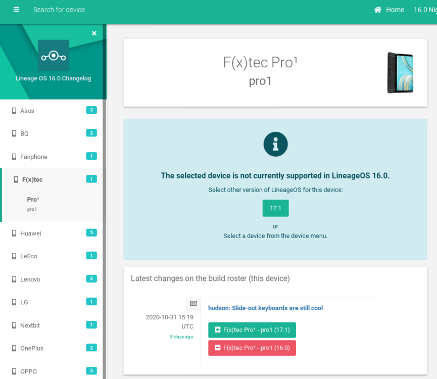

claude0001 1,424 Posted November 9, 2020 Share Posted November 9, 2020 (edited) Wondering why no new OTA updates had been offered for a while, I checked https://www.lineageoslog.com/16.0/pro1 There it says: "The selected device is not currently supported in LineageOS 16.0": As one sees, it is also suggested that only LineageOS 17.1 is supported on the Pro1. However, a stable build of that does not seem to be available yet, as far as I know. Have updates of 16.0 been abandoned in the process of porting 17.1 to the pro1? Edited November 9, 2020 by claude0001 Quote Link to post Share on other sites

claude0001 1,424 Posted November 9, 2020 Share Posted November 9, 2020 (edited) 1 hour ago, Wheeljack said: Something seems to be borked with the scheduler [...] Well, on October 31 the target "pro1 userdebug lineage-17.1" was added to the build system while "pro1 userdebug lineage-16.0" was removed. That does not seem like a malfunction, it was done on purpose. See the diff here: https://review.lineageos.org/c/LineageOS/hudson/+/290451/ Until the respective target is re-added, the build system will not compile 16.0 for our device anymore. Independently of that, the build(s?) for 17.1 seem(s?) to have failed last Monday, as a patch to fix a build error was introduced on Monday evening: https://review.lineageos.org/c/LineageOS/android_hardware_qcom_media/+/288323/ IMHO it would be good to keep building 16.0 for the Pro1 until 17.1 is known to be a fully stable replacement for it ... Edited November 9, 2020 by claude0001 1 2 Quote Link to post Share on other sites
EskeRahn 5,596 Posted November 9, 2020 Share Posted November 9, 2020 Yes, it does indeed seem to have been in a limbo for the last few weeks. I guess they were a little hasty stopping the 16.0 builds Quote Link to post Share on other sites
claude0001 1,424 Posted November 10, 2020 Share Posted November 10, 2020 On 11/9/2020 at 12:00 PM, claude0001 said: [...] Have updates of 16.0 been abandoned in the process of porting 17.1 to the pro1? [...] Bumping my question from above as the silence about this worries me a little bit. After all, LineageOS 16 is the very topic of this thread. I was hoping to keep LOS 16 on my device for a while, not expecting it to be abandoned so quickly. I worry that 17.1 will not work as a drop-in replacement for me due to the absence of AddonSU, which was a nicely integrated and low-profile root-management solution. I require permanent root access for several things (SSH server, Debian Chroot, cross-system file management), but I obviously do not want random apps to be able to su all the time. I read about magisk of course, but it is not an "official" solution and a much heavier application - two facts I worry about in such a (safety-) critical system component. Also -- from what I read at least -- it is much more tricky to install (does not work with Lineage recovery, I guess) and integrates less nicely into Lineage (does not survive OTA updates?). So ... could anyone with background knowledge comment on the future of 16.0? Do I have to prepare for the transition already? @tdm, maybe? Quote Link to post Share on other sites
Wheeljack 212 Posted November 10, 2020 Share Posted November 10, 2020 I'm only seeing the 17.1 build in the queue for today. I don't know if there were cases where 16 and 17 builds for the same device were run side by side. On another note... I'm running 16.0 with MindTheGapps. What are my options when upgrading to 17.1 (since OpenGapps is recommended now)? Quote Link to post Share on other sites
