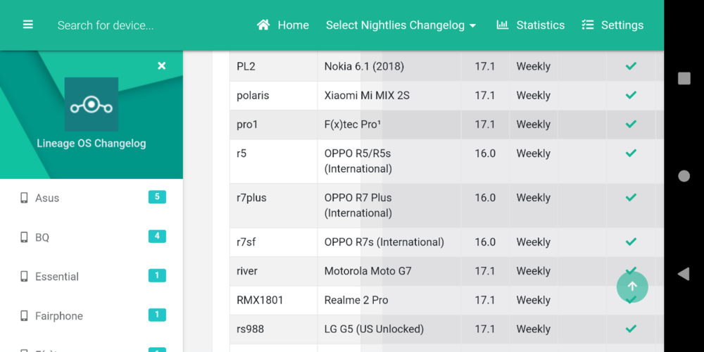

FlyingAntero 871 Posted November 2, 2020 Share Posted November 2, 2020 Lineage OS 17.1 for Pro1 can be seen from the scheduler. https://www.lineageoslog.com/build/scheduler 4 3 Quote Link to post Share on other sites
