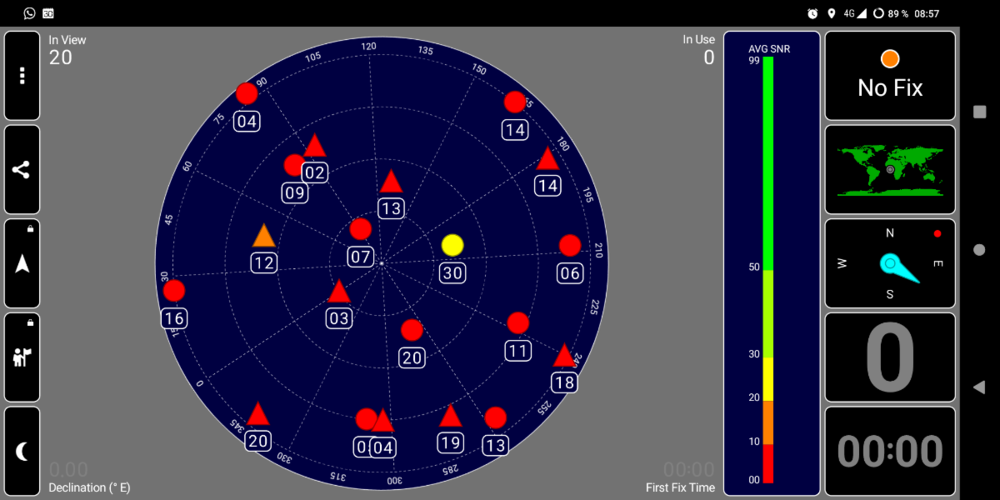

SchattengestaIt 563 Posted December 18, 2023 Share Posted December 18, 2023 Hey there, since a few days, I have huge issues with my GPS signal and it seemingly get worse. I am expecting either interference with some other component, a broken or detached antenna (if it uses an antenna) or a broken GPS receiver. What I have done is to delete and clear all GPS assist data and cache from all apps that use GPS. Where could I start troubleshooting? Does anybody know where the GPS sensor is located so I can take a closer look? Quote Link to post Share on other sites
EskeRahn 5,608 Posted December 19, 2023 Share Posted December 19, 2023 Hmm sounds bad. Any difference at all inside versus outside? This may be a silly question, but does it have the correct time?? I know from my automower, that if it is just a few minutes off the geolocation gets totally messed. When all cache wiped, it can take a while to get a first fix. Does the App whine if you turn Location back off, before leaving the app? (I'm fishing after if the app for some reason is not allowed to access the GPS, but does not report it correctly) I seem to remember that we have had a similar issue long back, where the solution was to enter something in a file.... But I can not remember the thread, And a search for GPS fails, as it requires at the least four chars.... Quote Link to post Share on other sites

SchattengestaIt 563 Posted December 19, 2023 Share Posted December 19, 2023 Thank you @EskeRahn for merging the threads. I couldn't find anything while searching the forum. I've had great GPS signal all the time. Never had any issues with delays or anything, it was always a strong and good signal. It wouldn't matter if inside or outside. From one day to another, it basically stopped working (outside and inside). The signal is extremely poor and Google Maps only manages to get my location every 5-30 minutes for a few seconds. I currently navigate swiping over my display and checking, where my route goes next... What I've tried so far: - GPS Off / On - All services Off / On, including airplane mode - Reboot - Deleted all cache in apps that are allowed to use GPS including Google Play services - Uninstalled and reinstalled Google Maps - Tried in different locations - I don't use a phone case - Power saving mode is not enabled - Additional GPS settings including high security Off / On - Cleared and reloaded all AGPS data using the app GPS test - Cleared and reloaded all AGPS data using the app GPS status and toolbox --> now I don't get any sattelites at all... not even in red Either the app screwed it up completely or it is a hardware defect. But how can I test that? As far as I know, there is no safe mode in LineageOS and I would like to prevent resetting my phone by any means. 1 Quote Link to post Share on other sites
