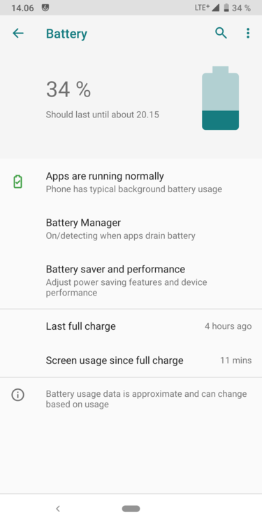

auvo.salmi 135 Posted March 5, 2020 Share Posted March 5, 2020 Is there any known issues with charging/battery indicator? At least for me it looks like the device charges very slowly/not at all (I have been using slow charge). Today morning I had 30% remaining when flashed test9. Then put the phone to wall charger and went to sleep for 3h, after that I had battery percentage of 34% and it is really discharging (dropping from there logically). Quote Link to post Share on other sites

EskeRahn 5,598 Posted March 5, 2020 Share Posted March 5, 2020 9 minutes ago, auvo.salmi said: Is there any known issues with charging/battery indicator? At least for me it looks like the device charges very slowly/not at all (I have been using slow charge). Today morning I had 30% remaining when flashed test9. Then put the phone to wall charger and went to sleep for 3h, after that I had battery percentage of 34% and it is really discharging (dropping from there logically). I have also had cases where it did not pull power from a PC-port, I thought it was the magnetic cable that had not been attached properly. When attached to a port offering 5W (or more) I have seen no issues. Quote Link to post Share on other sites
