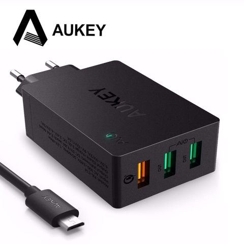

EskeRahn 5,598 Posted August 13, 2020 Share Posted August 13, 2020 Unfortunately QC chargers does not come with a simple switch to select normal or quick charge (I have not found one yet). BUT you can easily find QC 3.0 chargers with two or more slots, where only one is QC. This is a very handy thing. Use the normal slots normally and only the QC3.0 one when you are really in need of it. See also this I use one found on ebay that provides 5W in two slots and 20W QC3 in the last one. it is 2.5cm thick, and 5x5cm excluding plug (85mm including EU plug) so not much bigger than other chargers. 2 Quote Link to post Share on other sites
agent008 248 Posted August 13, 2020 Share Posted August 13, 2020 (edited) 13 minutes ago, EskeRahn said: Unfortunately QC chargers does not come with a simple switch to select normal or quick charge (I have not found one yet). BUT you can easily find QC 3.0 chargers with two or more slots, where only one is QC. This is a very handy thing. Use the normal slots normally and only the QC3.0 one when you are really in need of it. See also this I use one found on ebay that provides 5W in two slots and 20W QC3 in the last one. it is 2.5cm thick, and 5x5cm excluding plug (85mm including EU plug) so not much bigger than other chargers. I bought one of those for travelling. I think the brand is AUKEY. It is rather large and heavy (which unconsciously makes us think it's a "quality" item...). So maybe not the first choice for someone who travels really light, but it has 2 2.1A green ports and one QC orange port. It lives in my travel briefcase. For everyday use my BB Priv's charger is plugged beside my bed and I connect the phone to it every night. There's and old dual-2.1A Moto X charger at the office should the need arise. And in the car I have a QC charger plugged on the cigarette lighter, but that guy hardle ever sees any use (compared to when I had the Priv which for long trips I had to keep plugged and near the A/C outlet all the time...) EDIT: It is indeed an AUKEY PA-T14. Edited August 13, 2020 by agent008 Charger model 2 Quote Link to post Share on other sites
EskeRahn 5,598 Posted August 14, 2020 Share Posted August 14, 2020 11 hours ago, EskeRahn said: I use one found on ebay that provides 5W in two slots and 20W QC3 in the last one. it is 2.5cm thick, and 5x5cm excluding plug (85mm including EU plug) so not much bigger than other chargers. The one I currently use is this one. Do not get confused on the "2.1A" print it only delivers 1A - and this is exactly what I want from it *LOL* Quote Link to post Share on other sites

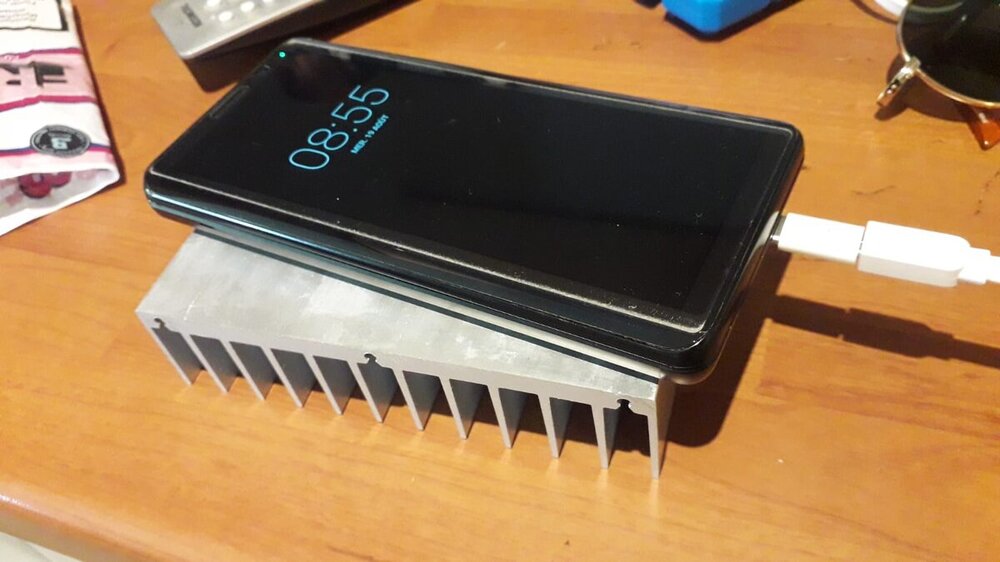

raymo 183 Posted August 19, 2020 Share Posted August 19, 2020 (edited) I use a 500mA chargers, with 1A it is always swapping between low\fast charging, and I guess it's not good for battery and controller. In fast charging the phone is quite hot as a cooktop. With 500mA it takes about 5-6 hours for plenty charging, I also use a DIY-adjustable-timing power socket, so I usually never reach 100% charging. I also use an electronic heat sink (from an old audio power amplifier) it works great as the pro1 has a metal case cover. See the picture. Edit : normal functionning (no charging), with #sudo dumpsys battery, 35°C. With dissipator 27°C...35° seems to be hot but maybe it's normal, I don't know. What I know is less heat in battery = more durability. Edited August 19, 2020 by raymo 1 2 Quote Link to post Share on other sites
