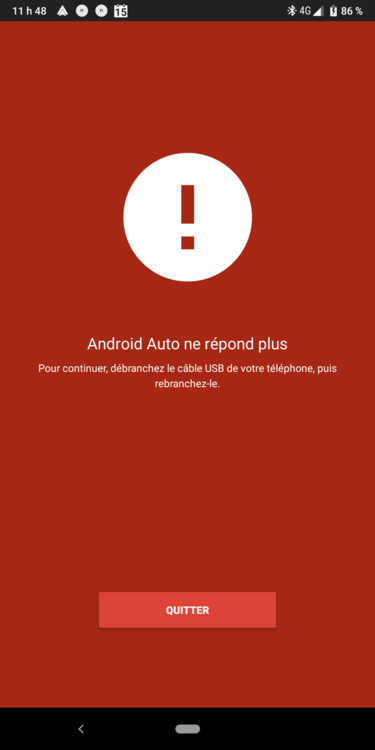

foxfreejack 60 Posted February 16, 2020 Share Posted February 16, 2020 Hi all, Today I tried to connect my Pro1 on my Pioneer AVH-4100NEX head unit, but failed with the message in the included image. Tried to reconnect a few times giving the same message, but after few times the message no longer came up. I restarted the head unit and reconnected the Pro1, the error message came up again the two time I tried to connect it. The Pro1 was freshly started a few minutes before. Pro1 is on the current firmware. The radio unit is on its latest firmware v1.11 built on December 8, 2018. Message is in french: Android Auto is not responding. To continue, disconnect the USB cable from the phone, and reconnect. 1 Quote Link to post Share on other sites
EskeRahn 5,604 Posted February 16, 2020 Share Posted February 16, 2020 Others can use Android Auto, see e.g. this or this So could be some settings or specific protocol that are teasing you? Quote Link to post Share on other sites
Slion 1,201 Posted February 16, 2020 Share Posted February 16, 2020 Android auto works just fine here but my car setup is much simplier than yours. Mostly just connecting to car audio output over bluetooth. 1 Quote Link to post Share on other sites
foxfreejack 60 Posted February 18, 2020 Share Posted February 18, 2020 The stand alone app works well, with bluetooth, no surprise here. I'll try to get debug/log messages to assess if the issue is around the head unit or the Pro1. 1 Quote Link to post Share on other sites
windraver 63 Posted February 18, 2020 Share Posted February 18, 2020 (edited) try a different cable. I had this issue with some other phones being extremely sensitive to what cable I used. My Pro1 works with 4 different heatunits I've tested on. Edit: I should also note that the usb-c port is a bit loose so in some cases, bumps will cause the cable to disconnect android auto. It could also be the cable at fault but it is my observation. Edited February 18, 2020 by windraver Quote Link to post Share on other sites
foxfreejack 60 Posted February 19, 2020 Share Posted February 19, 2020 3 hours ago, windraver said: try a different cable. I had this issue with some other phones being extremely sensitive to what cable I used. My Pro1 works with 4 different heatunits I've tested on. Edit: I should also note that the usb-c port is a bit loose so in some cases, bumps will cause the cable to disconnect android auto. It could also be the cable at fault but it is my observation. Thank you, I will try this. However the USB connector being at the back of the unit, this is no quick task. With my Z2 Force it does work all the time with the cable currently in place. In the mean time, I've captured logs while connected to my head unit, so knowledgeable people can take a look at it. While I do some programming, I've barely touched Android programming for now. 20200218-pro1-androidauto-logsextract.txt 1 Quote Link to post Share on other sites
foxfreejack 60 Posted February 27, 2020 Share Posted February 27, 2020 (edited) Hi all, I have made a test with another USB cable and it worked. But I tried to go back to the previous cable and it also worked... This said, there was a different behavior on the device: I tried right away with the new cable with my head unit, and the phone asked to allow location while Android Auto was loading. Not sure why it wasn't asking this on my first tries the other day. Once this was done, using either cable loaded AA normally. I say "normally", but I also found out that the previous cable had an issue, at least one contact isn't perfect with the Pro1, but good enough for my other device. Edited February 27, 2020 by foxfreejack 1 1 Quote Link to post Share on other sites
