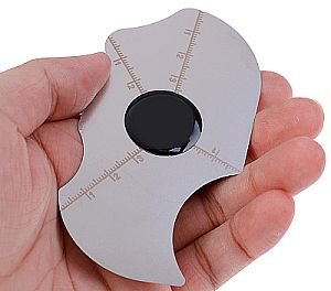

daniel.schaaaf 177 Posted August 30, 2021 Share Posted August 30, 2021 2 hours ago, SchattengestaIt said: Did this fix your problem or isn't the phone reassembled yet? I removed the camera protector with a thin steel prying tool like this one: Â There's no need to disassemble the phone. It did not quite fix my problem, but it got better. Now that the sun is out, I am unsure whether removing the adhesive tape made it better, or whether it was moving the camera a little with a tooth pick. I attached a picture that I resized slightly. The focus was on the birch tree. The background is still out of focus. But it is better than it was before, when anything further away than 50 cm would be blurry. I tried the manual focus in Open Camera. The trees in the background were least blurry with the focus set to 500 m. Obviously, they are not that far away (maybe 15 m?). Increasing the focus distance was impossible because the focus jumps from 500 m to infinity. I saw the trees in focus briefly somewhere in between... Quote Link to post Share on other sites
