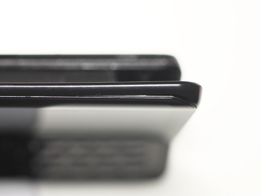

VaZso 1,999 Posted February 19, 2022 Share Posted February 19, 2022 (edited) 18 minutes ago, Rob. S. said: and still the lower right corner doesn't stick perfectly; next time I'll take more care especially with the corners. ...that does not sound good because there is a ribbon cable at the bottom of display and if it is physically able to move (as part of imperfect gluing of a corner) that will break again relatively soon. If it breaks, you will notice similar problem depending on the part where ribbon breaks - it will lead to either touch-related problem or screen-related problem. Especially the bottom part of the display should be fixed well to eliminate similar problems what some of us experienced with touch screen issue... that is the most sensitive part of the whole display because here comes a wide ribbon cable from glass edge to the back of display which contains all the raw wires of display and touch connections. Edited February 19, 2022 by VaZso 1 Quote Link to post Share on other sites

Rob. S. 1,667 Posted March 25, 2022 Share Posted March 25, 2022 16 hours ago, VaZso said: I have found I can move the problematic (lower-right) edge a bit by applying force, so still it was not properly glued That's where my self-replaced screen has developed a gap between the casing, too, after it had been the same with an earlier replacement that had been done by a repair shop. Looking at the phone closely, I now found that the casing bends backwards there. I suppose the usual glue (I've used T-7000) just isn't strong enough to resist the separating force applied by the bent casing. That said, I've never had any problems yet with touch-insensitive parts of the screen or something similar. Quote Link to post Share on other sites
VaZso 1,999 Posted March 25, 2022 Share Posted March 25, 2022 3 minutes ago, Rob. S. said: That said, I've never had any problems yet with touch-insensitive parts of the screen or something similar. Mine does not look to be that detached... However, there are two ribbon cables coming from bottom, one wide which is the display and a narrow which is the touch signal. The connection of the ribbon cable and glass is a sensitive part but also ribbon cable can break but usually at places where it is bent wrongly. I would think the connection between this ribbon cable and "glass" what can be detached more easily causing touch-related problems. Quote Link to post Share on other sites
