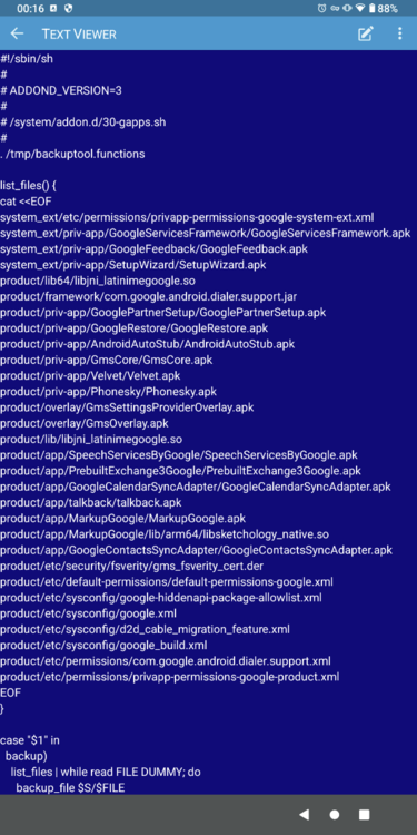

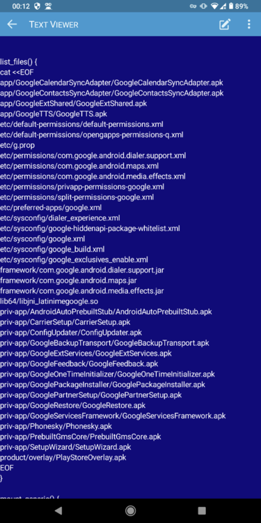

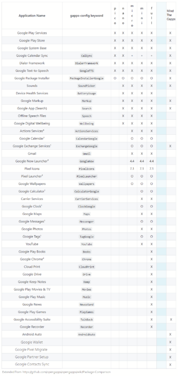

EskeRahn 5,596 Posted June 8, 2022 Share Posted June 8, 2022 11 hours ago, Rob. S. said: Is there any easy way to check which GApps it is that I've installed? Mindthegapps on 19.1 has a /system/addon.d/30-gapps.sh of 2.2Kb size that looks quite different from the similar 70-gapps.sh I see on AICP with OpenGapps (10.8K) Here collage of the interesting parts (in above order) 2 Quote Link to post Share on other sites
