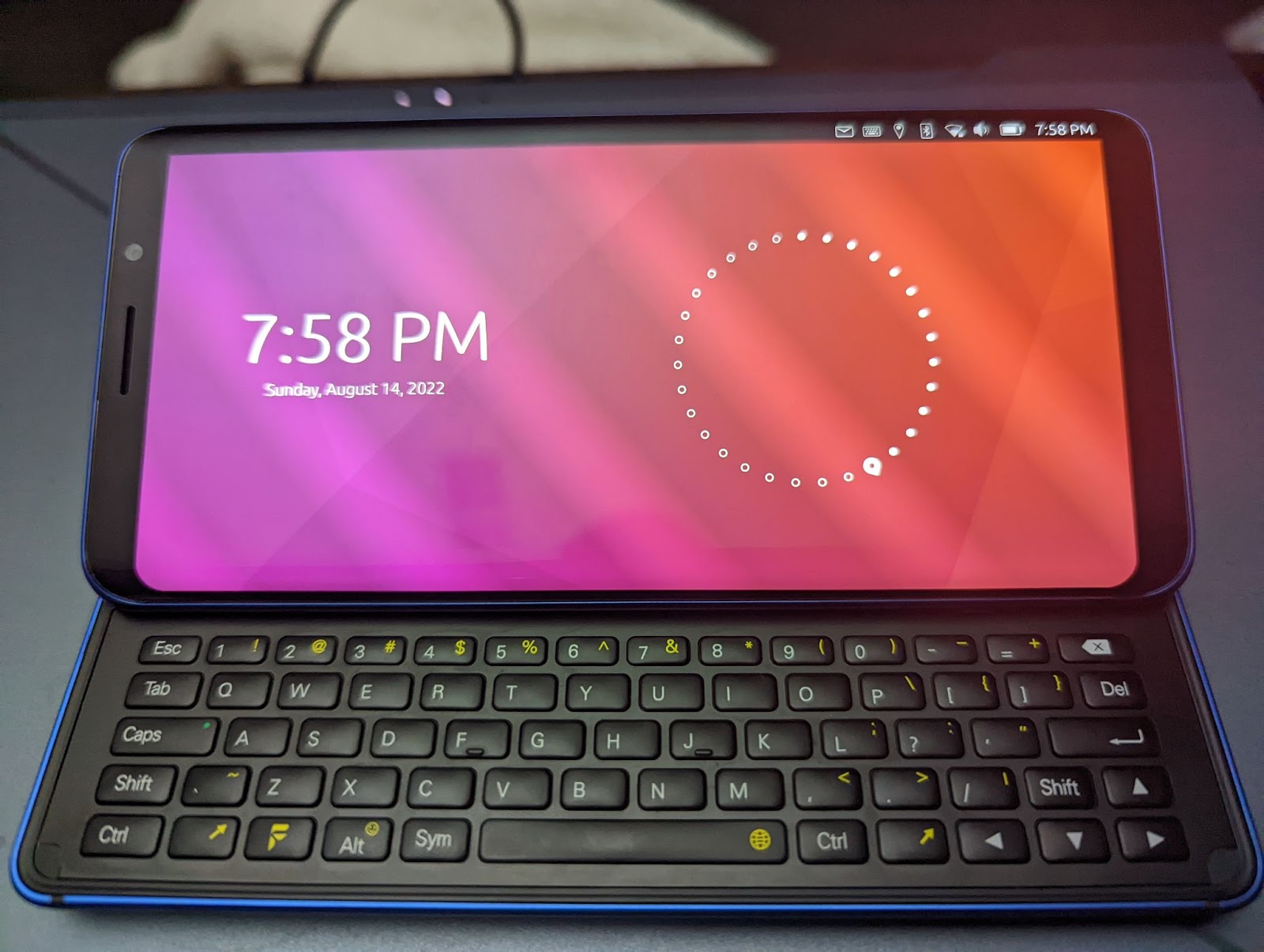

matf-kabouik 414 Posted August 17, 2022 Share Posted August 17, 2022 (edited) On 7/31/2022 at 6:06 AM, esialb said: I was able to install and use Ubuntu Touch on my Pro1-X after locating the fastboot images on their development server: Jobs · UBports / Porting / Community Ports / android11 / Fxtec Pro1-X / fxtec-pro1x · GitLab. Unzip artifacts.zip for the most recent build, which will have out/boot.img and out/userdata.img. To install: unzip artifacts.zip cd out fastboot flash boot_a boot.img fastboot set_active a fastboot flash userdata userdata.img fastboot set_active a fastboot continue So far it's pretty decent. My intended use for the Pro1-X is pocket computer, not primary phone, and I don't think Ubuntu Touch would make sense as a primary phone. AT&T blocks my SIM if it's inserted in the Pro1-X anyway, so I can't test phone stuff until I get a T-Mobile SIM. Mouse and keyboard work over usb-c, but I haven't figured out how to get DP-alt mode working. Physically, the device solid and well constructed. The small keyboard is fine for now. On 8/15/2022 at 3:08 AM, seven said: Here are the notes I saved for myself, in case it helps anyone: How To Flash Ubuntu Touch OS from windows 10: Download Google USB driver from https://developer.android.com/studio/run/oem-usb#InstallingDriver Extract driver, edit android_winusb.inf and add the following lines, save, close. ;F(x)tec Pro1 %SingleAdbInterface% = USB_Install, USB\VID_18D1&PID_D00D %SingleBootLoaderInterface% = USB_Install, USB\VID_18D1&PID_D00D Enable Windows Test Mode to allow modified driver by running this cmd: bcdedit /set testsigning on Reboot windows Enable Developer mode on phone Open cmd and change to Android adb platform-tools folder Plug in phone to pc Run adb devices to confirm phone is listed & authorized Run adb reboot bootloader Open Device Manager in Windows and confirm you see Android Device > Android Bootloader Interface Download latest ubuntu touch os images from here:https://gitlab.com/ubports/porting/community-ports/android11/fxtec-pro1x/fxtec-pro1x/-/jobs/artifacts/halium-11.0/download?job=devel-flashable Extract the out folder and place in android platform-tools folder Run these commands: fastboot format:ext4 userdata fastboot --set-active=a fastboot flash recovery out/recovery.img fastboot reboot fastboot fastboot flash system_a out/system.img fastboot flash boot_a out/boot.img fastboot flash dtbo_a out/dtbo.img fastboot reboot The phone reboots. Unplug from USB. Run this command to disable Window Test Mode: bcdedit /set testsigning of Initial setup on phone, then ran system settings updates to update to latest version of Ubuntu Touch OS. It failed, decided this was good enough. Links used:https://community.fxtec.com/topic/3597-pro1-x-with-ubuntu-touch/https://gitlab.com/ubports/porting/community-ports/android11/fxtec-pro1x/fxtec-pro1xhttps://slions.net/threads/lineage-os-for-f-x-tec-pro1.90/https://community.fxtec.com/topic/3410-fastboot-devices-doesnt-show-my-device/?tab=comments#comment-58694https://developer.android.com/studio/run/oem-usb#InstallingDriverhttps://gitlab.com/ubports/porting/community-ports/android11/fxtec-pro1x/fxtec-pro1x/-/jobs Could you please both add a warning at the top of your guides, along those lines? First and foremost, backup your "persist" partition. Better safe than sorry. Instructions are in other guides, Please, do not skip that step, there is no other way back to the vanilla persist partition. We are seeing more and more users losing their attestation keys because they didn't backup their vanilla partitions before flashing alternate OSes, and some data have been shown to be unique to devices and not auto-regenerated when flashing stock. I'm not saying they come from these guides specifically, but it's really necessary to have a warning on top of each flashing guide until we know if there is a way to regenerate the keys (so far, no). Edited August 17, 2022 by matf-kabouik 2 Quote Link to post Share on other sites

Milky_Pimms 10 Posted January 6, 2023 Share Posted January 6, 2023 Can some let me know please if i need to enter recovery mode to format userdata than follow steps? Reboot to bootloader, format userdata (if switching from Android) and flash recovery.img from the build artifacts, then reboot to fastbootd mode: fastboot format:ext4 userdata fastboot --set-active=a fastboot flash recovery out/recovery.img fastboot reboot fastboot Flash system.img and boot.img, then reboot: fastboot flash system_a out/system.img fastboot flash boot_a out/boot.img fastboot flash dtbo_a out/dtbo.img fastboot reboot fastboot format:ext4 userdata not working for me. fastboot format:ext4 userdata Warning: userdata type is f2fs, but ext4 was requested for formatting. /usr/lib/android-sdk/platform-tools/mke2fs failed with status 1 fastboot: error: Cannot generate image for userdata Thanks (M_P) Quote Link to post Share on other sites
Milky_Pimms 10 Posted January 6, 2023 Share Posted January 6, 2023 @esialb On 7/31/2022 at 12:06 PM, esialb said: unzip artifacts.zip cd out fastboot flash boot_a boot.img fastboot set_active a fastboot flash userdata userdata.img fastboot set_active a fastboot continue In the current GitLab release there is no userdata.img only: boot.img, dtbo.img, recovery.img, systerm.img Could you please have a second look. I can't install UBports at this stage. (M_P) Quote Link to post Share on other sites
Milky_Pimms 10 Posted January 9, 2023 Share Posted January 9, 2023 (edited) Hi all, Can someone please explain the differences between devel-flashable-focal and devel-flashable I flashed devel-flashable-focal no UBports app repo store and terminal 🤔 I followed the steps on GitLab page. On Fedora used sudo for fastboot commands, USB 2 port on a ROG micro ATX (B550-i) the BIOS USB flash back port. Using Fedora on a x570 no USB ports would work, no USB 2 ports only headers on board (it would connect and give the sense it should). Firehose for flash back was the same. Thanks for all for the help (M_P) Edited January 9, 2023 by Milky_Pimms spelling Quote Link to post Share on other sites
zstas 6 Posted January 9, 2023 Share Posted January 9, 2023 focal is a port to ubuntu 20.04 (which is named Focal) the regular build is based on 16.04 IIRC for me focal looked better but wifi was broken 😞 sometimes after the flashing I haven't seen the application and I fixed that by doing factory reset with UBPorts Recovery. 1 Quote Link to post Share on other sites
Milky_Pimms 10 Posted January 10, 2023 Share Posted January 10, 2023 (edited) Thanks @zstas #2985035568 devel-flashable-focal Helium 11 20220806 UBports Recovery failed the format data/factory reset. How did you flash regular the build is based on 16.04 IIRC once ubuntu 20.04 was all ready installed? WiFi is broken, no back light for keyboard, no mobile data, no terminal, no UBport app shop. I see there a some fixes but no terminal to use and no mobile/data or WiFi to download.. SSH or adb to fix ahhhh... I'm not that smart. I will try maybe. 🤕 (M_P) Edited January 10, 2023 by Milky_Pimms I'm a noob Quote Link to post Share on other sites
Milky_Pimms 10 Posted January 10, 2023 Share Posted January 10, 2023 (edited) DO NOT USE #2985035568 devel-flashable-focal Re-flashed and works well so far used #2985035565 devel-flashable https://gitlab.com/ubports/porting/community-ports/android11/fxtec-pro1x/fxtec-pro1x/-/jobs Reboot to bootloader, format userdata (if switching from Android) and flash recovery.img from the build artifacts, then reboot to fastbootd mode: sudo fastboot format:ext4 userdata sudo fastboot --set-active=a sudo fastboot flash recovery out/recovery.img sudo fastboot reboot fastboot Flash system.img and boot.img, then reboot: sudo fastboot flash system_a out/system.img sudo fastboot flash boot_a out/boot.img sudo fastboot flash dtbo_a out/dtbo.img sudo fastboot reboot Terminal, WiFi, location, bluetooth, app store, are there No moblie data out of the box (should be a easy fix) will update (Update) just change APN settings to suit carrier and good to go. Edited January 10, 2023 by Milky_Pimms update moblie data working 1 Quote Link to post Share on other sites
Milky_Pimms 10 Posted January 11, 2023 Share Posted January 11, 2023 (edited) FX Pro1x No support for Waydroid and anbox is no longer maintained at this stage, (adb, anbox-tool come pre-installed and are in UBport repo.) On #2985035565 devel-flashable 16.04 I can not use adb, anbox, waydroid. https://forums.ubports.com/category/102/waydroid (M_P) Edited January 11, 2023 by Milky_Pimms spelling 1 Quote Link to post Share on other sites
Milky_Pimms 10 Posted January 11, 2023 Share Posted January 11, 2023 (edited) Can confirmed Libertine works after making image writable (UT Tweak Tool). Libertine allows you to use standard desktop applications in Ubuntu Touch.To install applications you can use the Settings interface on your Ubuntu Touch device, or the command-line. https://docs.ubports.com/en/latest/userguide/dailyuse/libertine.html (M_P) Edited January 11, 2023 by Milky_Pimms more info Quote Link to post Share on other sites
