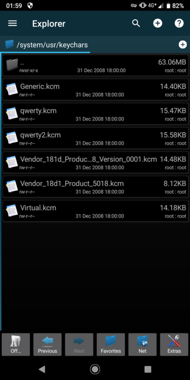

EskeRahn 5,598 Posted January 6, 2020 Share Posted January 6, 2020 47 minutes ago, shani said: How/where you can you assign that? Thanks in advance. 🙂 https://source.android.com/devices/input/key-layout-files https://source.android.com/devices/input/key-character-map-files 1 1 Quote Link to post Share on other sites
SchattengestaIt 563 Posted January 8, 2020 Share Posted January 8, 2020 On 1/6/2020 at 4:21 PM, shani said: How/where you can you assign that? Thanks in advance. 🙂 Thanks Eske! I don't have my Pro1 yet, so I can't tell you where the files are exactly located. But when you find them (I think they ended with ".kcm", but I'm too lazy to check that), they are pretty easy to understand. Especially with the links Eske provided (which I didn't know at the time I manipulated the files). You'll also find possible locations of the files with the link, but you probably will need a root explorer which can display system files. Quote Link to post Share on other sites
EskeRahn 5,598 Posted January 8, 2020 Share Posted January 8, 2020 9 hours ago, SchattengestaIt said: Thanks Eske! I don't have my Pro1 yet, so I can't tell you where the files are exactly located. But when you find them (I think they ended with ".kcm", but I'm too lazy to check that), they are pretty easy to understand. Especially with the links Eske provided (which I didn't know at the time I manipulated the files). You'll also find possible locations of the files with the link, but you probably will need a root explorer which can display system files. You do not need root to get to the files, but as normal users we are not able to overwrite/edit them (without root). /system/usr/keylayout and I think vendor_181d_product_5018_version_0001.kl /system/usr/keychars and I think vendor_181d_product_5018_version_0001.kcm (the .kl file is a 100% copy of the generic generic.kl , unused entries not removed) Vendor_181d_Product_5018_Version_0001.kl Vendor_181d_Product_5018_Version_0001.kcm 3 Quote Link to post Share on other sites

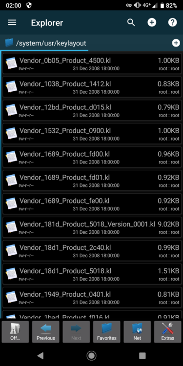

EskeRahn 5,598 Posted January 8, 2020 Share Posted January 8, 2020 2 hours ago, EskeRahn said: You do not need root to get to the files, but as normal users we are not able to overwrite/edit them (without root). /system/usr/keylayout and I think vendor_181d_product_5018_version_0001.kl /system/usr/keychars and I think vendor_181d_product_5018_version_0001.kcm (the .kl file is a 100% copy of the generic generic.kl , unused entries not removed) Vendor_181d_Product_5018_Version_0001.kl 9.02 kB · 1 download Vendor_181d_Product_5018_Version_0001.kcm 14.48 kB · 0 downloads I do not know where the LANGUAGE definitions are though?? Anyone that can supply any input here? Especially the "German" that should be used for the qwertZ print. (If FinQwerty is not used) 1 Quote Link to post Share on other sites

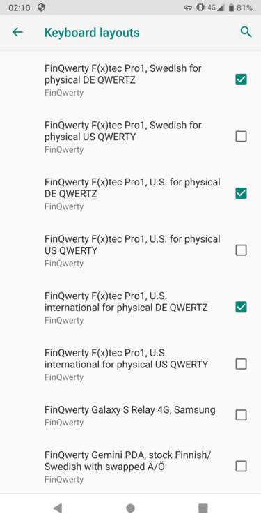

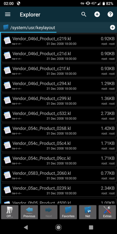

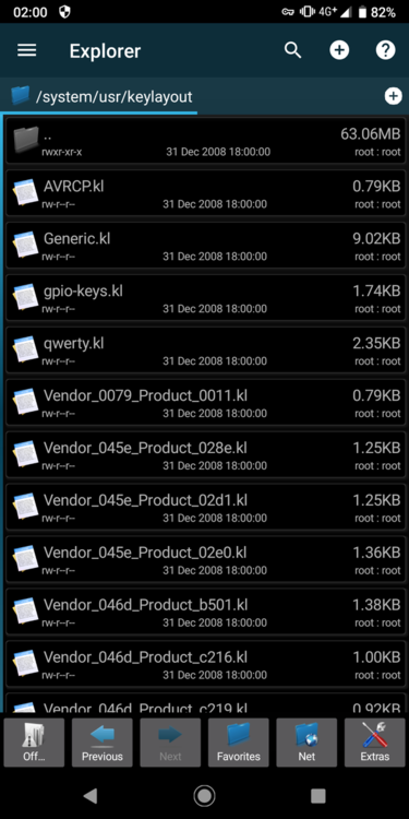

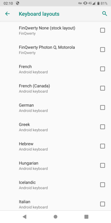

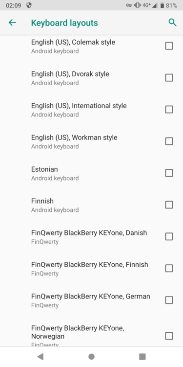

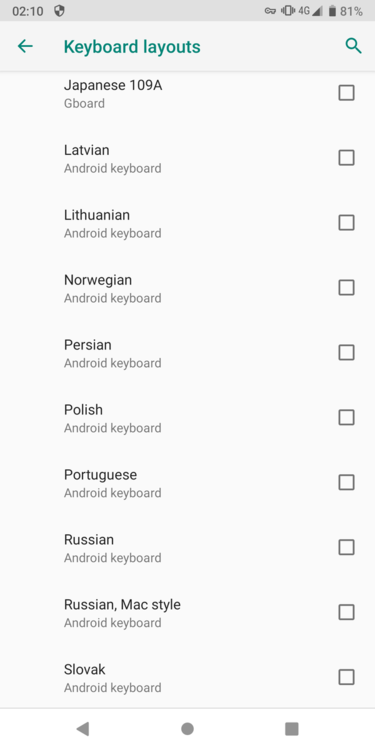

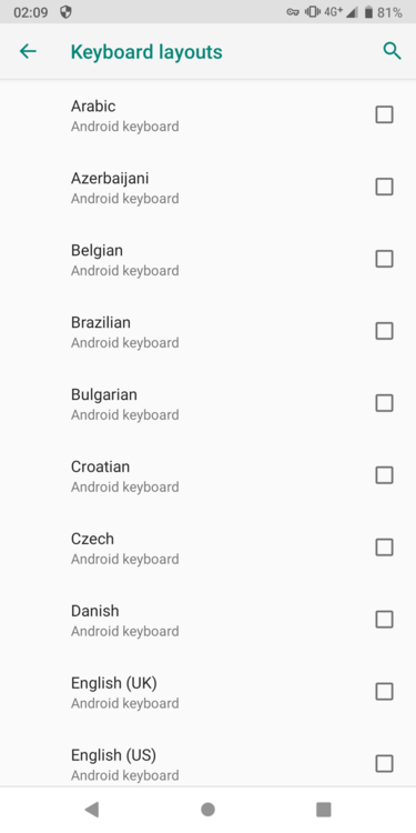

EskeRahn 5,598 Posted January 9, 2020 Share Posted January 9, 2020 7 minutes ago, SchattengestaIt said: Are there no other files in /system/usr/keylayout/ and /system/usr/keychars/ ? If there are, it would be great if you could post them. There are, but they are not relevant. Opened each of them.... here a few dumps. Note the size, most are way to small to have anything substantial, as they all start with some blah blah. (046Dh is Logitech BTW) 1 1 Quote Link to post Share on other sites

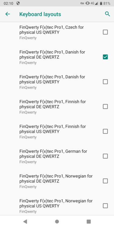

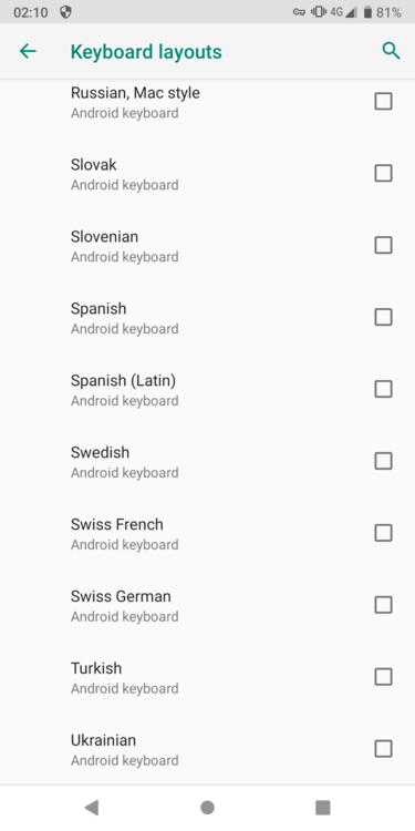

EskeRahn 5,598 Posted January 9, 2020 Share Posted January 9, 2020 ...And the phone got all these hardware keyboard layout (skipped most of the FinQwerty ones not relevant here) They must be defined in one or more files somewhere, but I've been unable to guess what to look for, scanned the device for .kl and .kcm files, and only found in the two subdirectories above, so most likely they are called something else. Also looked for .idc noticed that most, except the Japanese, have the app name "Android keyboard" under it so maybe they are buried in an APK? 1 1 Quote Link to post Share on other sites
SchattengestaIt 563 Posted January 9, 2020 Share Posted January 9, 2020 I think, it all makes sense. So far, we are supposed to select specific keyboard layouts, even if we live in another country. I'd guess that they have finished 5-6 keyboard layouts for the major language settings and the other ones are untouched. Normally, you let those empty, but maybe those other language files do tell the system which layout to use (just a guess since I can't look into the files). In my view, every ~15kB file is a full language and the rest is uncompleted. Those 8kB are maybe half completed (or irrelevant stuff like gamepad commands were deleted - maybe community layouts?). To prove this, you could try uncommon layouts. South african, arabian and so on. I'm pretty sure you'll get some standard layout. Though, I do not like these junk names. It wouldn't have been too difficult to call them "qwertz_de", "qwerty_es" and so on. Seems like they didn't do this by hand. Quote Link to post Share on other sites
EskeRahn 5,598 Posted January 9, 2020 Share Posted January 9, 2020 6 minutes ago, SchattengestaIt said: I think, it all makes sense. So far, we are supposed to select specific keyboard layouts, even if we live in another country. I'd guess that they have finished 5-6 keyboard layouts for the major language settings and the other ones are untouched. Normally, you let those empty, but maybe those other language files do tell the system which layout to use (just a guess since I can't look into the files). In my view, every ~15kB file is a full language and the rest is uncompleted. Those 8kB are maybe half completed (or irrelevant stuff like gamepad commands were deleted - maybe community layouts?). To prove this, you could try uncommon layouts. South african, arabian and so on. I'm pretty sure you'll get some standard layout. Though, I do not like these junk names. It wouldn't have been too difficult to call them "qwertz_de", "qwerty_es" and so on. Seems like they didn't do this by hand. The ONLY one that make sense to select is the German one, the rest are stock android (well all the ones I tried....), not fitting the hardware (Neither the qwertZ nor the letter shifted qwertY) properly. The two 'lists' of screen-dumps are NOT related, so the big question is where all these named language layouts are actually defined, when not in the .kl and .kcm? Note that the ones from FinQwerty on the selection list is not part of stock, and should be ignored in this context. Quote Link to post Share on other sites
SchattengestaIt 563 Posted January 9, 2020 Share Posted January 9, 2020 5 hours ago, EskeRahn said: The ONLY one that make sense to select is the German one, the rest are stock android (well all the ones I tried....), not fitting the hardware (Neither the qwertZ nor the letter shifted qwertY) properly. The two 'lists' of screen-dumps are NOT related, so the big question is where all these named language layouts are actually defined, when not in the .kl and .kcm? Note that the ones from FinQwerty on the selection list is not part of stock, and should be ignored in this context. What you could try is to move the kcm/kl files (or just rename the folder and create a second one) so the folder would be empty. I could imagine that some languages are defined internally and every additional language file would be read out of the folder. I know a couple of programs and games that have done it this way, but I won't know for certain until I get my Pro1. Quote Link to post Share on other sites
EskeRahn 5,598 Posted January 9, 2020 Share Posted January 9, 2020 4 hours ago, SchattengestaIt said: What you could try is to move the kcm/kl files (or just rename the folder and create a second one) so the folder would be empty. I could imagine that some languages are defined internally and every additional language file would be read out of the folder. I know a couple of programs and games that have done it this way, but I won't know for certain until I get my Pro1. I have tried to open all the files and look at the content, and they are RO for a non rooted device anyway. 1 Quote Link to post Share on other sites
