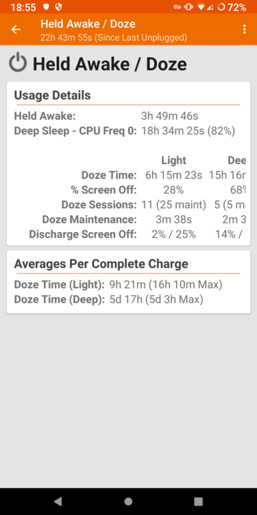

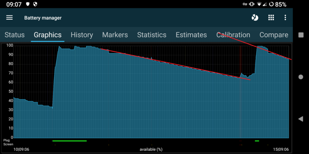

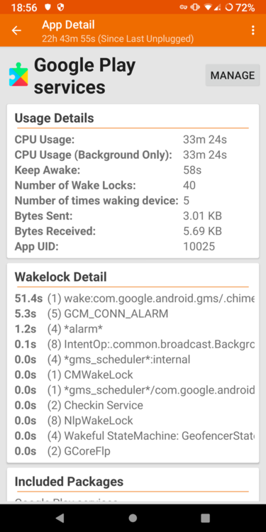

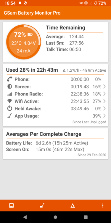

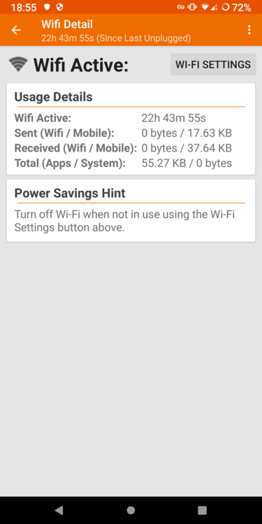

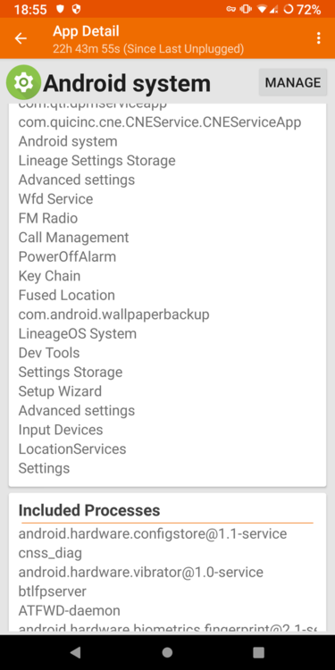

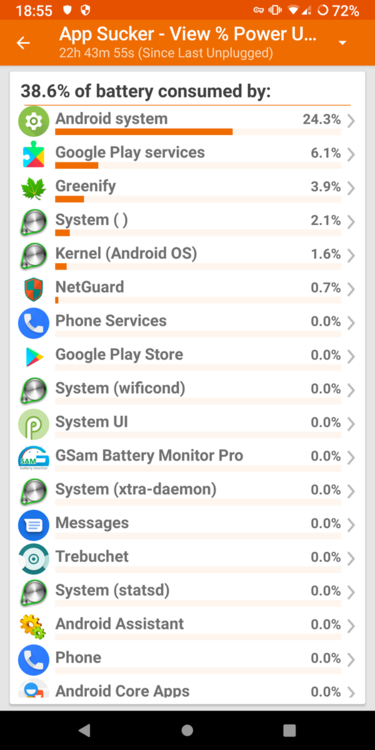

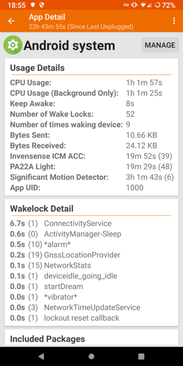

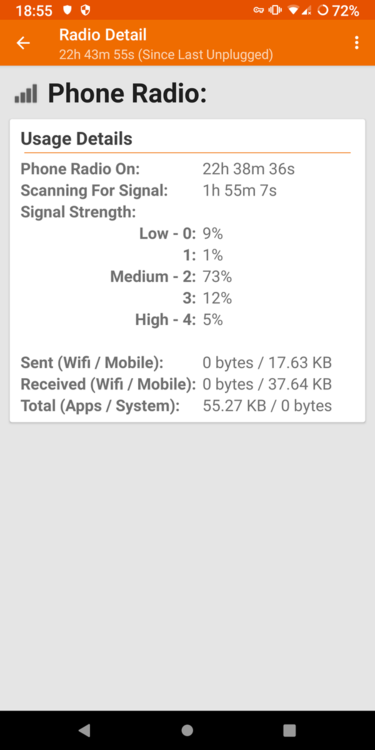

npjohnson 33 Posted July 15, 2020 Share Posted July 15, 2020 8 hours ago, EskeRahn said: Despite the more aggressive power management, to my surprise the Test21 is substantially MORE power-hungry than Test20?!? see below from 3C All-in-one toolbox. (It looks similar on the rooted) - note also the x on the WiFi, Mobile data, the screen dump is taken shortly after unlocking with fingerprint. Roughly at ratio 7:4 or a factor 175% And no, there aren't additional stuff running. I checked with Greenify and Android Assistant and only a few user and system apps I explicitly have white-listed are running This screenshot makes me think you have a persistent VPN (blockada or similar?) can you try without that? Recent QCACLD merge may be the issue - I've heard of issues with persistent VPN's after that. Quote Link to post Share on other sites
EskeRahn 5,598 Posted July 15, 2020 Share Posted July 15, 2020 1 minute ago, npjohnson said: This screenshot makes me think you have a persistent VPN (blockada or similar?) can you try without that? Recent QCACLD merge may be the issue - I've heard of issues with persistent VPN's after that. Well I have NetGuard active all the time, It will be a show stopper for Lineage for me if that no longer works. Quote Link to post Share on other sites
tdm 2,322 Posted July 15, 2020 Author Share Posted July 15, 2020 4 minutes ago, npjohnson said: This screenshot makes me think you have a persistent VPN (blockada or similar?) can you try without that? Recent QCACLD merge may be the issue - I've heard of issues with persistent VPN's after that. Please take a look at the kernel history on my github. There was no rebase between test20 and test21 so the kernel history is linear and both tags appear in a simple log. The qcacld merge was complete for test20. 1 Quote Link to post Share on other sites
npjohnson 33 Posted July 15, 2020 Share Posted July 15, 2020 (edited) 2 minutes ago, EskeRahn said: Well I have NetGuard active all the time, It will be a show stopper for Lineage for me if that no longer works. I understand - I want to get it working - I'm asking purely for testing purposes. If you can't I likely can try some stuff today. Edited July 15, 2020 by npjohnson Quote Link to post Share on other sites
EskeRahn 5,598 Posted July 15, 2020 Share Posted July 15, 2020 13 minutes ago, npjohnson said: I understand - I want to get it working - I'm asking purely for testing purposes. If you can't I likely can try some stuff today. Well to give you some valid data I would have to flash a phone with Test20, without the VPN, wait a day or so, and then flash Test21, wait a day or so... So it will clearly be faster to see if someone else without VPN have a battery monitor installed, and see the same difference switching from Test20 to Test21. Quote Link to post Share on other sites
npjohnson 33 Posted July 15, 2020 Share Posted July 15, 2020 31 minutes ago, EskeRahn said: Well to give you some valid data I would have to flash a phone with Test20, without the VPN, wait a day or so, and then flash Test21, wait a day or so... So it will clearly be faster to see if someone else without VPN have a battery monitor installed, and see the same difference switching from Test20 to Test21. Additionally, can we get your greenify stats? Quote Link to post Share on other sites

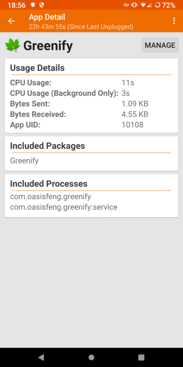

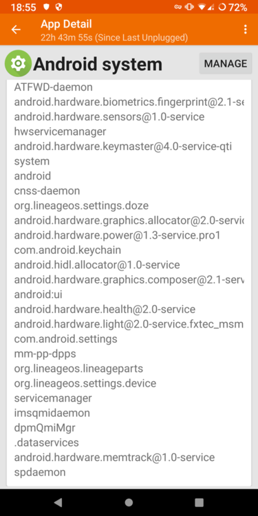

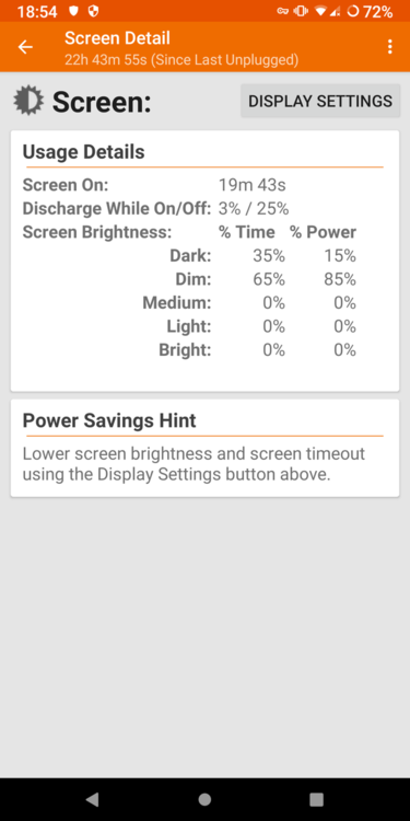

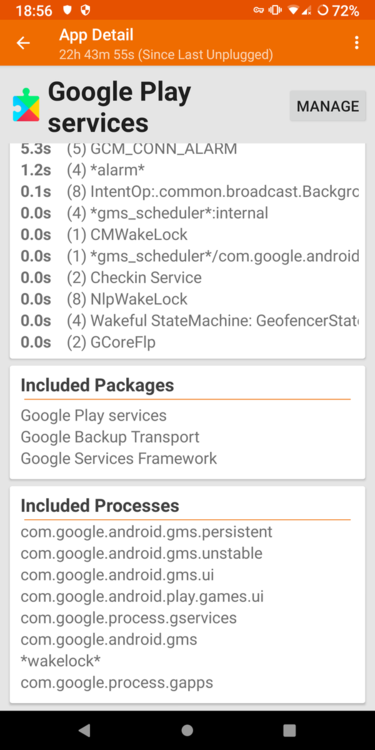

npjohnson 33 Posted July 15, 2020 Share Posted July 15, 2020 4 minutes ago, EskeRahn said: Sure, how do I pull those? I suppose whatever compilation of data between the app you screenshotted and greenify that provides: - percentage drain over time - Suspend time - Wake-locks - And anything else you think might be of pertitnence Quote Link to post Share on other sites
EskeRahn 5,598 Posted July 15, 2020 Share Posted July 15, 2020 Just now, npjohnson said: I suppose whatever compilation of data between the app you screenshotted and greenify that provides: - percentage drain over time - Suspend time - Wake-locks - And anything else you think might be of pertitnence I have no idea how to pull that info. At best I can give you what GSAM can tell... Quote Link to post Share on other sites
EskeRahn 5,598 Posted July 15, 2020 Share Posted July 15, 2020 ....sorry for the random order it ended in. Note that GSAM has a bug, so any traffic through VPN is logged as WiFi, even if you turn off WiFi completely. Quote Link to post Share on other sites
