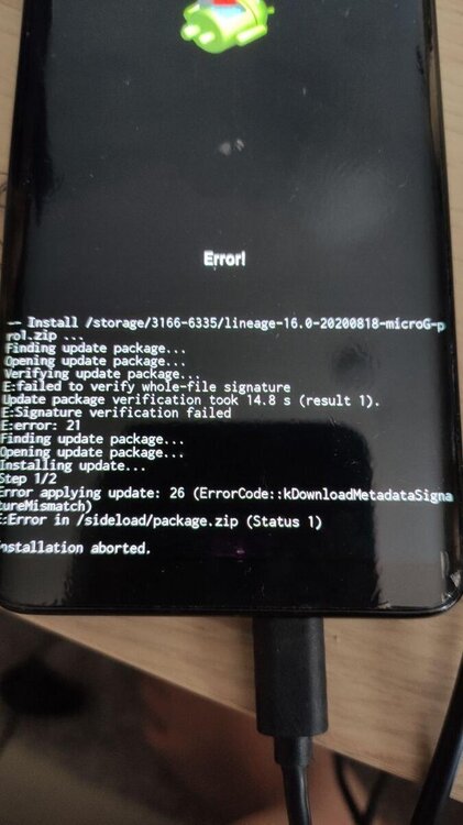

mcdinner 375 Posted August 19, 2020 Share Posted August 19, 2020 On 8/2/2020 at 8:13 PM, dicer said: I am also building it myself. It is quite easy actually with the docker container: https://gist.github.com/dicer/3543ef27cbee845c0cbba9cf3f15242a You just need a lot of RAM (I think 16GB?) and disk space (>100GB). You won't get OTAs though. You will have to rebuild yourself once in a while Regarding the boot image: You can just use the one from TDMs website as far as I know. There is also a way to extract them from the generated zip files but I forgot how, since you only need to do that once as a base. You install the boot image in slot A, boot to its recovery and install your self-compiled recovery/boot-image and system into slot B. After the next reboot, slot B will be selected and your self-compiled boot image will be used. Thanks to you tutorial I managed to build lineage for microg but I have a problem installing it with lineage recovery and sideload. After confirming to install with failed signature verification I get an error. Happens with test recovery from tdm, official recovery and with official build microg and my own one. Any Ideas what to do? Quote Link to post Share on other sites
tdm 2,322 Posted August 19, 2020 Author Share Posted August 19, 2020 1 hour ago, mcdinner said: Thanks to you tutorial I managed to build lineage for microg but I have a problem installing it with lineage recovery and sideload. After confirming to install with failed signature verification I get an error. Happens with test recovery from tdm, official recovery and with official build microg and my own one. Any Ideas what to do? If you boot to the boot/recovery that you built (by using fastboot to flash it), you should have no signature issues with the package. Just a guess, but perhaps the microg signature spoofing is getting in the way of the metadata signatures? The easiest solution might be to fastboot flash your built images instead of using recovery to install them. You'll probably need boot, system, vbmeta, vendor. You can find them in out/target/product/pro1 under your build tree. 1 2 Quote Link to post Share on other sites
mcdinner 375 Posted August 19, 2020 Share Posted August 19, 2020 2 hours ago, tdm said: If you boot to the boot/recovery that you built (by using fastboot to flash it), you should have no signature issues with the package. Just a guess, but perhaps the microg signature spoofing is getting in the way of the metadata signatures? The easiest solution might be to fastboot flash your built images instead of using recovery to install them. You'll probably need boot, system, vbmeta, vendor. You can find them in out/target/product/pro1 under your build tree. Thanks for the hints, I'll start the build again as build artifacts got cleaned as I can see... Add Thank you so much for all the work with Lineage!! 1 1 Quote Link to post Share on other sites
mcdinner 375 Posted August 19, 2020 Share Posted August 19, 2020 8 hours ago, tdm said: If you boot to the boot/recovery that you built (by using fastboot to flash it), you should have no signature issues with the package. Just a guess, but perhaps the microg signature spoofing is getting in the way of the metadata signatures? The easiest solution might be to fastboot flash your built images instead of using recovery to install them. You'll probably need boot, system, vbmeta, vendor. You can find them in out/target/product/pro1 under your build tree. using my own boot image did the trick :) Install works smooth now, but after boot settings app and others just crash all the time and the system is not really working. I deleted cache and userdata so I guess there is a problem with the build itself now 1 Quote Link to post Share on other sites
mcdinner 375 Posted August 20, 2020 Share Posted August 20, 2020 So, i just started from scratch and now it works like a charm. :) 3 Quote Link to post Share on other sites
