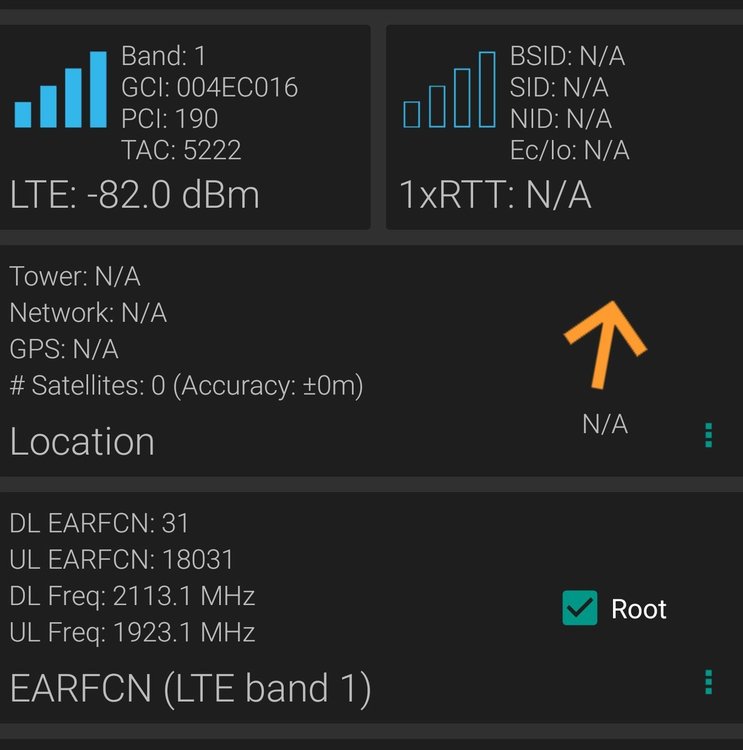

Alright, I downloaded LTE Discovery app which is VERY helpful, so thank you zurvan2.
According to that app, they are both connected to the same band (LTE band 4) and the same tower (I think?) but one has 4 bars and one has zero.  The dBm measurements are not THAT different, at least not what I believe would enough to warrant 4 bars vs zero...
But when I, for example, throw it in my local faraday cage (aka unplugged Microwave) the Blackberry goes to -118 dBm on band 4 and reports 2 bars of signal, whereas the Pro1, when on -104 dBm says zero bars.
So does the bars relation to dBm change on a per phone basis?  Is my Blackberry lying to me about how strong the signal is?  Or is the Pro1 being very picky about how strong the signal is?

On 1/30/2020 at 3:36 PM, Pete said:
The only discrepancy I can see is the Band 66, which IS listed alongside Band 4 in a lot of places, so maybe my blackberry is ACTUALLY connected to band 66 even though it says 4 in LTE Discovery app?
Band 66 encompasses all of Band 4 (it can be thought of as Band 4 + an extension).  However, the working groups, and thus the phone radio hardware manufactures, consider them distinct bands.  There has also been totally different EARFCN values (used to obtain the actual RF uplink/downlink frequencies) assigned to each band.  For whatever reason, the LTE Discovery app often reads these values incorrectly, then displays the wrong band, and often (depending on if the bands overlap) the wrong uplink and downlink frequencies.  A long while back, I brought this to one of their developer's attention and he attempted to correct this, but was never able to fix it completely.  An example of this happens in my area using my Droid 4 (which only supports LTE band 13 as it's ancient -I still use one as a daily driver and, because of this, am connected to Verizon's CDMA 99% of the time).  The app shows I'm on Band 1 (which isn't even a US band), and, again, one which my phone definitely doesn't support (even outside of the US).
I just attempted to use the app to post an example in pic form, but am unable to connect to any of Verizon's LTE sites because they are using bands other than 13 in my area.  Thus, the snapshot below is from a few months back when my family visited Hoover Dam.  Again, you can see it shows LTE Band 1, but in reality it absolutely had to be Band 13, or the radio in my phone wouldn't be able to use it (I did verify the phone was using LTE data, and had a very strong signal while there).
Note: I'm replying to this separately as they are totally different issues...
-99dBm is awful signal (becoming borderline unusable) and there is no way the BB should be showing 4 bars!  -107 beyond horrible and probably mostly unusable (meaning tons of packet retries).
Nonetheless, the BB appears to have a much better receiver (than the Pro1) in that site 148 has a 6 dBm improvement (over the Pro1), and site 149 has a full 10 dBm improvement (over the Pro1).  As I'm sure you know, it's a logarithmic scale where 3 dBm refers to a doubling of the power and 10 dBm would be a ten fold increase.  This is a massive difference!  Of course, before we write off the Pro1 as having a poor radio, it should be noted that the phones shouldn't be this close together (for various reasons, but germane to this discussion is) because the local oscillators, and transmitted RF energy can negatively affect each other.  That said, it has piqued my interest as there is also a WiFi thread about weak WiFi signal, so when I have a moment I'll look into this matter comparing the Pro1 to other phones known to have good or poor transceivers.

6 hours ago, Pete said:
Thanks for the info, Polaris.  I was suspicious that the Blackberry may be lying to me about 4 bars.  I will say that this photo is the only time they were that close together while I was testing this.  Otherwise I would walk around the roof of our building with one phone or the other and these values really wouldn't change much, though the dBm reading on the Blackberry was generally slightly better than the Pro1.  I feel like regularly the Pro1 would get up to -99.0 dBm and still only show maybe 1 bar, so I'm still confused about the relationship between bars and phones and dBm.
My pleasure.  The relationship is purely a logical software one.  It reads the RSRP (received power) & RSRQ (received quality) and then converts it to a bar graph and numerical and/or percentage.  Simple as that.  The Pro1 is being more honest about things, not sure if there is intent to deceive with the BB or not, but it's not even close to being accurate with 4 bars.
If you're saying that it is possible that the LTE Discovery app is lying about band 4, or that it just shows band 66 as band 4 anyways, that may be the culprit.  It still doesn't feel right and I don't know what to trust in that app or if any of that info is even useful based on what you said.  Regardless, the data and voice connections seem to be fine even when the Pro1 is on zero bars, so I guess it's not THAT big of a deal.  I'll have to pay more attention to the bars (and maybe the LTE Discovery app?) as I'm around LA to see if I can't find an example of an area where the Pro1 shows full signal (which I feel I would see regularly on the BlackBerry) or check the signal if I find an area where data or voice reception is poor or choppy.
I don't think lying is the correct phrase to be used with the LTE Discovery app (as lying implies intent), but the app is often incorrect, and most people don't know because they don't really have any other way of testing this aspect.  In my case, once I suspected things were wrong due to my ancient phone (which I love dearly) not even supporting the band, I then confirmed it with a spectrum analyzer.  It was very clear that the phone was actually in band 13 (again, the only LTE band it supports) from the analyzer's display.
You might want to check out another app which provides it's own interpretation of RSPR & RSRQ.  I haven't used it in a while, but back when I was messing with this, and discussing it with the LTE Discovery developer, it was helpful.  It is called SignalCheck Lite.  The app uses color coded bars to graphically represent the signal strength, and always seemed to be rather accurate.

34 minutes ago, VaZso said:
I hope antennas are tuned appropriately on each frequencies, but I think which you notice is most likely related to not supported frequency/band(s) at your location and not an imperfect antenna system.
I wouldn't jump to this conclusion so quickly.  @Pete has pictures of his two phones, they are both in band and the Pro1's received power is significantly less than with the BB.  Not by just a little, but by quite a bit (see his dBm readings above).
Sorry if I misunderstood that, but wasn't it potentially related to improper band feedback inside that application?
Yes, the application does report incorrect bands at times, but that's not the issue at hand (with regard to antenna design or how "hot" the receiver is in the Pro1).  Even if the app gets the band wrong, the phones won't, and they are clearly in service and seeing various cell sites (and voting to park on one).  Every one in view shows a received power that is weaker on the Pro1.  Regardless of the band the app is reporting, these numbers wouldn't change (my guess is the band is correct, if I had his rough address I could verify that, but B4 is indeed in use by Verizon in a large part of the country).
