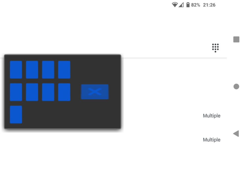

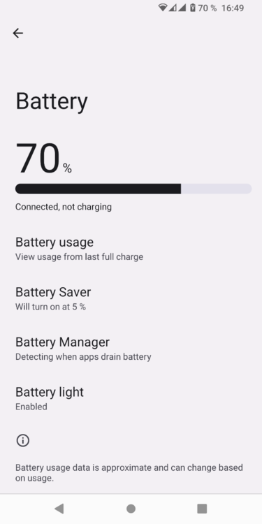

DieBruine 397 Posted July 7, 2022 Share Posted July 7, 2022 I've been running 19,1 since I got my phone back, for about two weeks now. Last version I installed was 19-20220704-NIGHTLY-pro1. I just use the auto-updater. - SwiftKey combo doesn't really work that well with Google Chat and Signal. - Charging issue remains. I must reboot, otherwise it won't charge. - Bluetooth signal and/ or background processing is very bad. Multitasking while streaming Tidal will produce choppy sound and/ or intermittent connection. Even when the receiving end is within 10cm. - Unable to get a GPS fix. I can leave it on in an open field, clear skies, for hours, I won't get a fix. This is a real shame and very annoying. Yesterday is used NFC to pay, so no issues there. These are the only bugs I have noticed so far. Back to being my daily driver for the last two weeks. 1 Quote Link to post Share on other sites

DieBruine 397 Posted July 14, 2022 Share Posted July 14, 2022 On 7/11/2022 at 10:22 AM, EskeRahn said: (lineage-19.1-20220711-nightly-pro1-signed.zip on June 5 security patch installed smoothly using adb sideload and MindTheGapps-12.1.0-arm64-20220605_174313) Since flashing this version, I haven't had a single issue with charging. Up until this version a reboot was required every single time! Bluetooth and GPS still suck though. Unable to get a fix and BT connection is limited in distance and stability) 1 Quote Link to post Share on other sites
EskeRahn 5,598 Posted July 14, 2022 Share Posted July 14, 2022 1 hour ago, DieBruine said: Since flashing this version, I haven't had a single issue with charging. Up until this version a reboot was required every single time! Bluetooth and GPS still suck though. Unable to get a fix and BT connection is limited in distance and stability) I hope you are right 😁 Though we never found a way to consistently trigger the bug, so hard to say for sure.Has anyone that updated to 20220711 seen the charging-bug since? Bad news: Just managed to trigger it...... (at 67%) What I did was: In unlocked state, Plugged, unplugged and replugged a few times Locked, waited three minutes (while it was charging on a table). Picked it up and unlocked the device with fingerprint Unplugged and replugged Tried to do exactly the same after a reboot, but it did NOT trigger it again, so not a consistent method, Tried to repeat it trice.... 1 Quote Link to post Share on other sites
DieBruine 397 Posted July 16, 2022 Share Posted July 16, 2022 Today I purposely let it drop to >10%. Hooked it up to several chargers and it started cycling through the voltages (QC). I tried two different BaseUs chargers 65 GaN, two power banks, a Samsung max 9V charger and my regular Unihertz 5V 1.5A charger. Only the non-QC charger is able to charge it. I always suspected the QC-handshake process to be culprit. This seems to confirm it. 1 1 Quote Link to post Share on other sites
