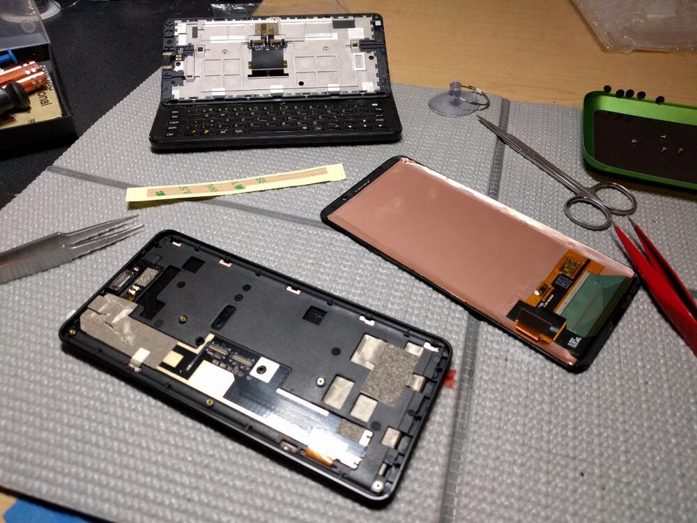

SCΛRECROW 57 Posted July 12, 2021 Share Posted July 12, 2021 Got aliexpress replacement display and replaced the faulty one successfully. Can confirm, no more ghost touches. Such a relief to get the keyboard back. 3 Quote Link to post Share on other sites

tomthegeek 4 Posted July 14, 2021 Share Posted July 14, 2021 The issue has been fixed after installing the screen that arrived today. Ordered two so I have a spare. Pretty easy replacement, but I am having issues with the screen sticking. I used the 3m strips all the way around but doesn't seem to be working. Will leave some weight on it overnight. 1 1 Quote Link to post Share on other sites
SCΛRECROW 57 Posted July 14, 2021 Share Posted July 14, 2021 52 minutes ago, tomthegeek said: The issue has been fixed after installing the screen that arrived today. Ordered two so I have a spare. Pretty easy replacement, but I am having issues with the screen sticking. I used the 3m strips all the way around but doesn't seem to be working. Will leave some weight on it overnight. I'm having the same problem, used the 3M tape, left it under a couple of heavy books for 2 days but one corner is still popping up. 1 1 Quote Link to post Share on other sites
EskeRahn 5,608 Posted July 14, 2021 Share Posted July 14, 2021 @tomthegeekand @SCΛRECROW. Maybe a silly question, but did you remove all residues of the old strip and put the new adhesive strips the same places? It could be hat you are supposed to cut it to fit? 1 Quote Link to post Share on other sites
tomthegeek 4 Posted July 14, 2021 Share Posted July 14, 2021 6 hours ago, EskeRahn said: @tomthegeekand @SCΛRECROW. Maybe a silly question, but did you remove all residues of the old strip and put the new adhesive strips the same places? It could be hat you are supposed to cut it to fit? I pulled all the black stuff off yes. However just realized now ATT won't activate my SIM in this phone even though the towers are still up until Feburary??? This 5G shit has me really worried. We've never been forced to upgrade before and now phones have to be approved instead of just the SIM card. That is a huge change in policy, before I could move the sim to any unlocked phone that was compatible with the towers and it would work. Now there's a specific list of phones that I can use. Time to finally start looking for a new carrier although it wouldn't surprise me in the least if all of them are going to be exactly the same way. Because of course there are no small independent carriers left. 1 1 Quote Link to post Share on other sites
VaZso 1,999 Posted July 14, 2021 Share Posted July 14, 2021 (edited) @tomthegeek, @SCΛRECROW, I suggest you to find a better (but removable) glue which is able to hold the display without allowing it to move. There is a ribbon cable at the bottom of the display (if I remember well) which is better to remain in fixed position. If that ribbon cable breaks, it may lead to ghost touches, display distortion, etc. Sometimes there is another glue comes with a display (maybe B-7000 for example), it seems to hold it good enough. Do not allow the display to move in the frame. Edited July 14, 2021 by VaZso 4 Quote Link to post Share on other sites
SCΛRECROW 57 Posted July 15, 2021 Share Posted July 15, 2021 16 hours ago, EskeRahn said: @tomthegeekand @SCΛRECROW. Maybe a silly question, but did you remove all residues of the old strip and put the new adhesive strips the same places? It could be hat you are supposed to cut it to fit? Yes, indeed, removed the old strip and cleaned the frame with isopropyl alcohol before applying the new adhesive tape, which was also cut to size. 1 hour ago, VaZso said: Sometimes there is another glue comes with a display (maybe B-7000 for example), it seems to hold it good enough. Thanks for the tip, I'll give the B-7000 glue a shot. 1 Quote Link to post Share on other sites

tomthegeek 4 Posted July 22, 2021 Share Posted July 22, 2021 Re-did the screen tape tonight. I used some really thin tape I have for RC stuff instead of the included tape. The other thing I did different was to use just a dab of Shoo Goo in the 4 corners and tape in the middle not just the edges. The screen is much better fixed in place and I think the shoe goo will hold when temps get really hot. I suppose RTV silicon would work just as well. 1 Quote Link to post Share on other sites
SCΛRECROW 57 Posted August 15, 2021 Share Posted August 15, 2021 Managed to find some time to re-glue the screen with B-7000, which works nicely. Left the phone under a stack of books overnight and just rubbed the overflowed glue residue off with my fingers. Also, I forgot who had the idea of adding a diffuser to the notification LED window, but thank you. I added a bit of magic tape to it and it's a much better look now. 2 Quote Link to post Share on other sites
