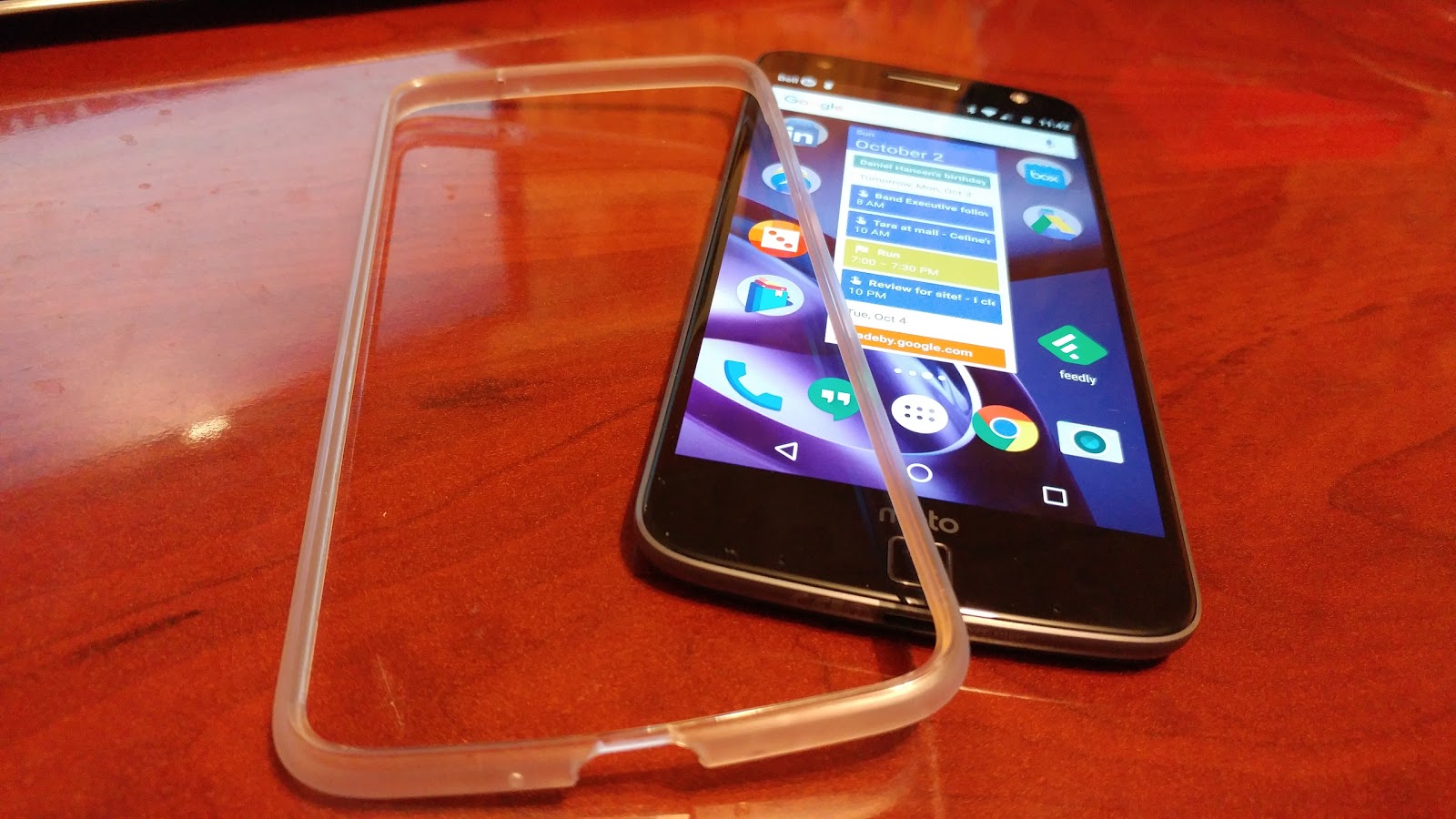

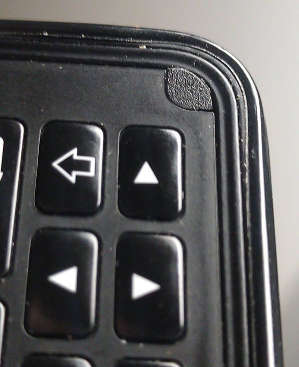

david 929 Posted January 20, 2020 Share Posted January 20, 2020 4 hours ago, Keyahnig said: The front part is definitely not perfect yet. It even covers the notification LED How does it hold onto the front part? For that matter, how does the bottom part hold on? Do you tape them in place? Quote Link to post Share on other sites
Keyahnig 80 Posted January 20, 2020 Share Posted January 20, 2020 23 minutes ago, david said: How does it hold onto the front part? For that matter, how does the bottom part hold on? Do you tape them in place? It's basically the same like every soft case. There's a small lip that holds onto the gap between keyboard and display. There's no tape or anything and both parts didn't slip of yet so it holds on pretty good. The sides on the front part are pretty thin and fiddly though. 2 Quote Link to post Share on other sites

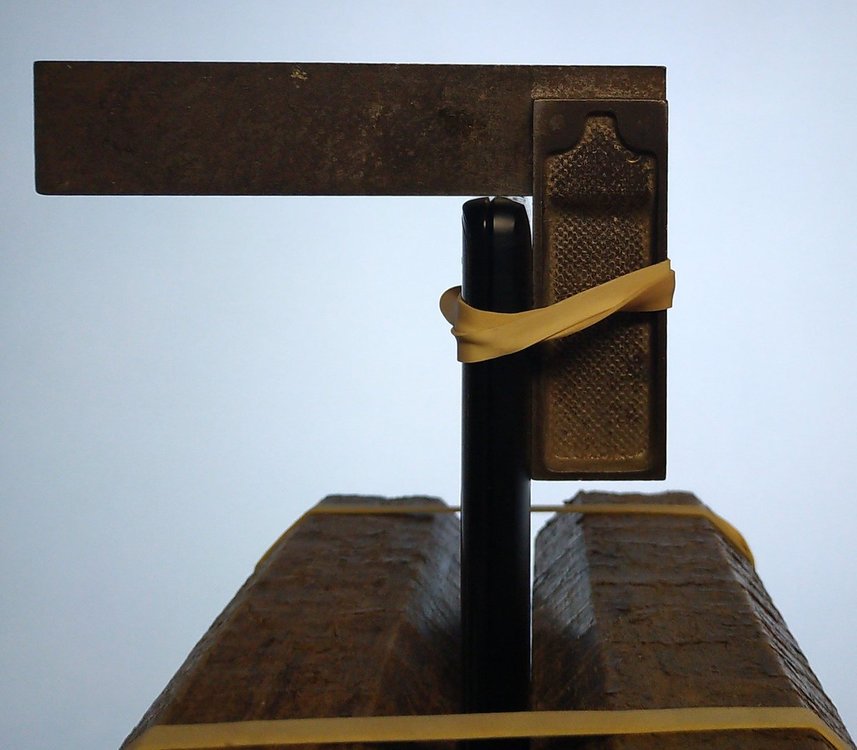

Bloodhoundje 78 Posted January 20, 2020 Share Posted January 20, 2020 (edited) Just finished a quick sketch of the bottom part of the protective cover: Will run a test print tonight to get first dimensions with hard plastic to see how the shell fits, then adjust and further develop. The plan is that the fit should be about 0.5-1mm too tight. That way silicone will grab itself onto the enclosure :). The holes for the switches are temporary for allignment, on the end design these will be filled in with silicone aswell, that way the entire bottom is enclosed and the rockers will go slightly heavier from pressing the silicone layer between them. Edited January 20, 2020 by Bloodhoundje 10 Quote Link to post Share on other sites
EskeRahn 5,596 Posted January 20, 2020 Share Posted January 20, 2020 2 hours ago, Bloodhoundje said: Just finished a quick sketch of the bottom part of the protective cover: Looks good! Though I think the flat part is a bit wider, that is the curved part is less. I would say about similar to your drawing but on the other side of the flash. And I think you should try to narrow it a bit towards the top, that is not a straight side. ADD: tried to take a picture against a grey screen, with the other Pro1, stock camera-software, slightly rotated and cropped. 3 Quote Link to post Share on other sites
Bloodhoundje 78 Posted January 20, 2020 Share Posted January 20, 2020 57 minutes ago, EskeRahn said: Looks good! Though I think the flat part is a bit wider, that is the curved part is less. I would say about similar to your drawing but on the other side of the flash. And I think you should try to narrow it a bit towards the top, that is not a straight side. ADD: tried to take a picture against a grey screen The chamfer is about 1-2mm. Right now I have taken the most outer dimension. Once I remove 1mm from that the silicone will fill in the empty space considering it will be stretched "over" it. +1 for the great photo btw! 1 Quote Link to post Share on other sites

EskeRahn 5,596 Posted January 20, 2020 Share Posted January 20, 2020 1 hour ago, Bloodhoundje said: The chamfer is about 1-2mm. Right now I have taken the most outer dimension. Once I remove 1mm from that the silicone will fill in the empty space considering it will be stretched "over" it. +1 for the great photo btw! Ah I see. If you rely on straight edges being held by the stretch and friction, I think the conic shape might trick you. That is preventing all the hard cases and hard cases with soft inner shell i tried in staying on. Of course they ALSO have the problem that the bottom is stiff, and that helps pulling them off I believe the reason why the soft TPU and Silicon cases for Huawei P20 Pro and Samsung Note 7 fit so well is because they are made for a rounded shape so the top of the shell is going inwards, and this just catches the phased edge of the lower part. BUT these cases/shells are taking more than half of it. so it is going to be hard to get both halves to grip at the same time, without interfering with the slide.IF that fails, you just might consider having the lower part gripping on the long edges, and the top part on the short edges! So the top long edges comprises sort of a rubber band connecting the two end-parts. Below is a close up of P20 Pro flip-case grip. It is only the outermost that is part of the case ( @abielins please don't look too close, at has not been sterilized ) 2 Quote Link to post Share on other sites
david 929 Posted January 20, 2020 Share Posted January 20, 2020 6 hours ago, Keyahnig said: It's basically the same like every soft case. There's a small lip that holds onto the gap between keyboard and display. There's no tape or anything and both parts didn't slip of yet so it holds on pretty good. The sides on the front part are pretty thin and fiddly though. Can you define thin and fiddly? :-) I guess, besides fit, the other thing we'll want to consider is how much cushioning something like this will provide. I would imagine, with a 3D printer, you could create air pockets in the outer walls of the case parts. With the mold approach, that's not possible. Quote Link to post Share on other sites
