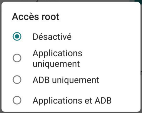

Hook 3,317 Posted June 19, 2020 Share Posted June 19, 2020 33 minutes ago, tdm said: The root access setting is dynamic. By default it only shows disabled and adb. When you install the su add-on, it adds the "apps and adb" option. Okay, so it seems to me that you are talking about a different "SU add-on" than Magisk as Magisk gives me root but does not add options for the root setting in developer settings. Are you talking about (formerly Chainfire's) SuperSU, which I've always used before, or is there another SU add-on you are referring to. I'm assuming the kernel trick works with what you are referring to and not with Magisk. I actually have no pressing need to hide root, but I am curious about how you are doing root just so I can learn the options. Quote Link to post Share on other sites
tdm 2,322 Posted June 19, 2020 Author Share Posted June 19, 2020 Just now, Hook said: Okay, so it seems to me that you are talking about a different "SU add-on" than Magisk as Magisk gives me root but does not add options for the root setting in developer settings. Are you talking about (formerly Chainfire's) SuperSU, which I've always used before, or is there another SU add-on you are referring to. I'm assuming the kernel trick works with what you are referring to and not with Magisk. I actually have no pressing need to hide root, but I am curious about how you are doing root just so I can learn the options. No, I am talking about the Official(tm) LineageOS superuser add-on from here. I do not use or endorse any other su package, and I absolutely don't touch magisk at all. 1 2 Quote Link to post Share on other sites
Hook 3,317 Posted June 19, 2020 Share Posted June 19, 2020 1 minute ago, tdm said: No, I am talking about the Official(tm) LineageOS superuser add-on from here. I do not use or endorse any other su package, and I absolutely don't touch magisk at all. Thanks, I never knew that existed. I'll have to give it a try. I'm not a big fan of Magisk, but the only instructions on this forum were for Magisk. Is the right one Arm64 or Arm? 2 Quote Link to post Share on other sites
tdm 2,322 Posted June 19, 2020 Author Share Posted June 19, 2020 1 minute ago, Hook said: Thanks, I never knew that existed. I'll have to give it a try. I'm not a big fan of Magisk, but the only instructions on this forum were for Magisk. Is the right one Arm64 or Arm? The Lineage version is 16.0 and the device is arm64. So you want "addonsu-16.0-arm64-signed.zip". 3 Quote Link to post Share on other sites

Hook 3,317 Posted June 19, 2020 Share Posted June 19, 2020 Beautiful, so far. Manually sideloaded Test 15, MindTheGapps and the su addon, changed theroot setting to apps and adb and gave permission to Root Explorer and Titanium Backup and away I go. I'll let you know if I get any more phone turning off, but tbh, that hasn't happened in a few days anyway. Lol. I think it's time to buy @tdm another 6-pack. 🍻 2 2 Quote Link to post Share on other sites

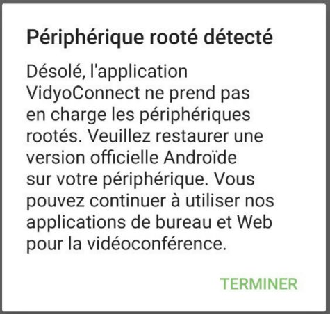

Jordi 72 Posted June 20, 2020 Share Posted June 20, 2020 I installed the last version of LOS and in the developer options, I deactivate root but when I try to install the app which require a non-rooted device it keeps telling me that my device is rooted. A reboot did not help. Anything I'm doing wrong? Quote Link to post Share on other sites
EskeRahn 5,598 Posted June 20, 2020 Share Posted June 20, 2020 1 hour ago, Jordi said: I installed the last version of LOS and in the developer options, I deactivate root but when I try to install the app which require a non-rooted device it keeps telling me that my device is rooted. A reboot did not help. Anything I'm doing wrong? I think the error message is inaccurate. I get the same on a LineageOS 16.0 Test15 that has NOT got the root addon installed. Maybe it is trying to say that the device is not certified or that it does not pass the SafetyNet test. ADD: Checked that It opens without this on Certified Stock even with an OTA not passing SafetyNet. (So the important part of the message is the next that it expects an "official Android") 1 Quote Link to post Share on other sites
Wheeljack 212 Posted June 20, 2020 Share Posted June 20, 2020 Had pretty much the same happening with the app from the insurance "Signal Iduna" with all unrooted Lineage test versions I used so far. The app just said my device was rooted and wouldn't start for security reasons. So either their check is wrong or their message is lazy. 1 Quote Link to post Share on other sites

tdm 2,322 Posted June 20, 2020 Author Share Posted June 20, 2020 Regarding root detection and the su-hide patch... The kernel su hide patch was intended for a specific purpose: someone claimed that Lineage su was insecure but refused to provide any details except that it could be exploited even when root access was disabled in settings. The su-hide patch was my response. It is impossible to exploit something that does not exist. 🙂 The patch was never intended to prevent apps from detecting the device has been rooted. That is a cat-and-mouse game and I don't play. If an app insists that it run on an un-rooted device or does anything else that is hostile to the user (such as SafetyNet checks), I don't install it. The way to determine if the su-hide patch is working is as follows: disable root access in settings and then try to access su from a non-root shell (either adb or a terminal app). If the su binary is accessible, the patch is broken. If not, the patch is working. If you want to run an app that does checks which are hostile to the user, please do feel free -- it's your device. You can run xposed and magisk and whatever else you like. But this is not my concern and I will not support either the hostile apps nor the apps which try to hide from them. 1 3 Quote Link to post Share on other sites

Jordi 72 Posted June 20, 2020 Share Posted June 20, 2020 Ok, so the answer to my question: On 6/19/2020 at 1:59 PM, Jordi said: Is there a safe way to hide root in LineageOS? Some apps I use require a non-rooted device. could be found in the direction of Xposed or Magisk. Does anyone has any experience with this? Quote Link to post Share on other sites
