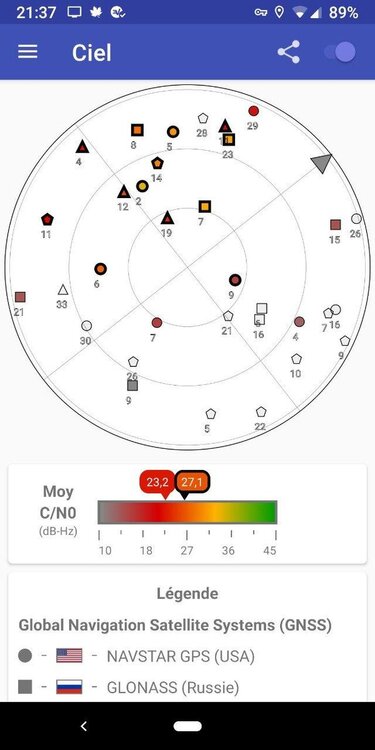

marmistrz 93 Posted July 25, 2020 Share Posted July 25, 2020 I have recently updated from test16 to test22 and today I noticed I can no longer get a GPS fix. SatStat sees a couple of satellites, but marks them red. I attached logcat. I tried clearing the data for com.qualcomm.location and FusedLocation, but it doesn't help. I haven't updated to the official releases yet, but since test22 and current official are mostly the same, this shouldn't matter. Let me know if I should try it. I'd prefer to avoid wiping everything for obvious reasons. gpslogcat.txt Quote Link to post Share on other sites
tdm 2,322 Posted July 25, 2020 Author Share Posted July 25, 2020 26 minutes ago, marmistrz said: I have recently updated from test16 to test22 and today I noticed I can no longer get a GPS fix. SatStat sees a couple of satellites, but marks them red. I attached logcat. I tried clearing the data for com.qualcomm.location and FusedLocation, but it doesn't help. I haven't updated to the official releases yet, but since test22 and current official are mostly the same, this shouldn't matter. Let me know if I should try it. I'd prefer to avoid wiping everything for obvious reasons. gpslogcat.txt 16.53 kB · 0 downloads I can get a fix -- possibly a bit slow, but it works. Any one else having issues? Quote Link to post Share on other sites

marmistrz 93 Posted July 25, 2020 Share Posted July 25, 2020 I'm always using SatStat and OsmAnd. 1 Quote Link to post Share on other sites

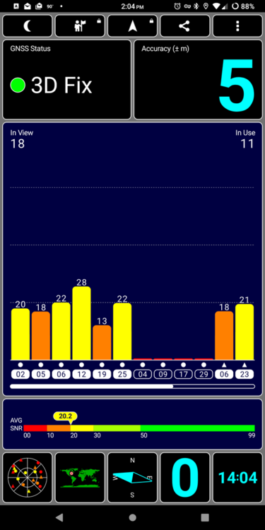

Hook 3,315 Posted July 25, 2020 Share Posted July 25, 2020 (edited) SatStat just confused the heck out of me. 😄 GPS Test showed a quick first fix time (00:05 the first time, 00:08 the second) with about 9-11 sats in use out of 18 in view. Most are yellow and orange, occasionally turning green briefly. On the Average SNR slider, floating around 18. I take all this to mean connection is quick but signal is not strong? I'm past my pay grade here, lol. Sorry, I'm not all that technical so it is hard for me to help. Edited July 25, 2020 by Hook 1 Quote Link to post Share on other sites

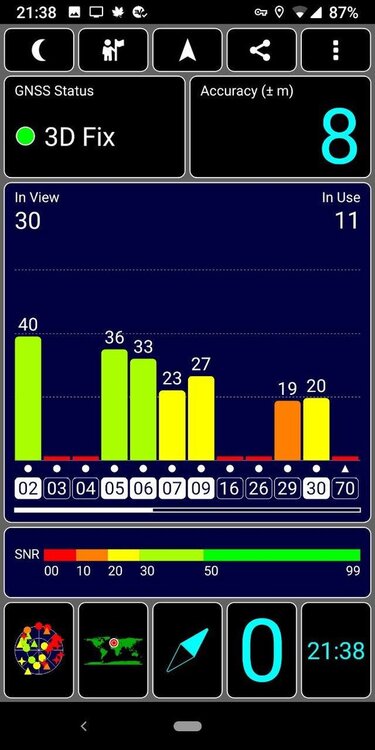

Jordi 72 Posted July 25, 2020 Share Posted July 25, 2020 (edited) Tested on my balcony, clear sky (LOS Nightly): a cold fix is obtained in 10 - 12 seconds (AGPS). Hot fix: less than 5 seconds. Accuracy varies between 5 and about 20 m. There seems to be satellites on (almost) all sides. Edited July 25, 2020 by Jordi 1 Quote Link to post Share on other sites
