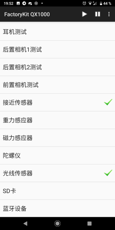

divstar 164 Posted January 27, 2020 Author Share Posted January 27, 2020 (edited) Okay so the good news is: the sensors appear to be working. The bad news is: my phone does not switch in WhatsApp for example to the ear speaker when close to the ear as it used to do... hm.. Edit: seems fixed after restarting the phone... now apps recognize proximity and brightness sensors. Sorry for the hussle. Edited January 27, 2020 by divstar 1 1 Quote Link to post Share on other sites

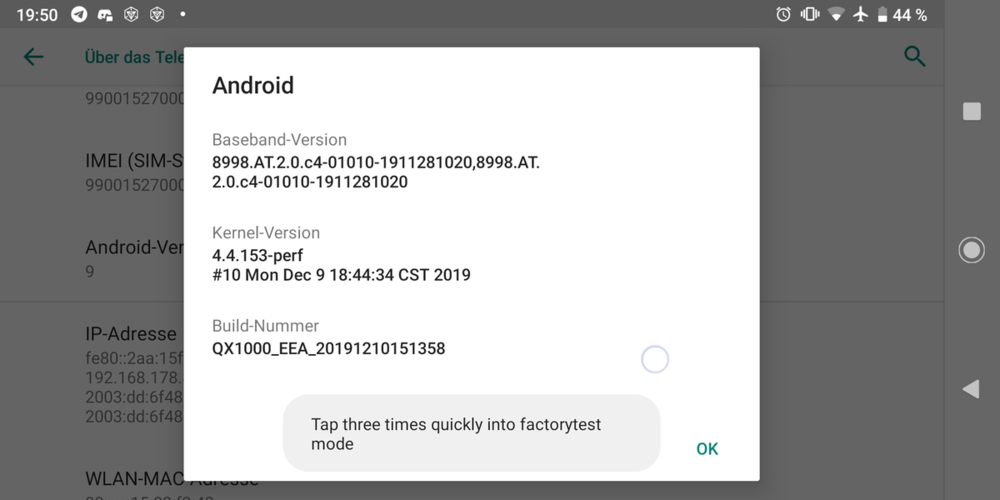

Noir 114 Posted January 27, 2020 Share Posted January 27, 2020 (edited) 59 minutes ago, divstar said: Okay... so.. I guess I have one more issue after screen replacement, though I must confess I am unsure whether this feature even used to work at all, namely automatic dimming of the screen. What I know for sure, is, that it does not work anymore. And I can't access the sensor programmatically to tell if the sensor(s) even work. Can any of the pro1 users check? Does someone have an idea of how to verify light- and proximity sensors? Sure. To access the factory test tool (within the stock rom of course), enter Settings -> About Phone -> Anroid Version. You will be presented with a popup, scroll down there and tap 3 times quickly on the build number: The options below are proximity- and Ambient light sensor test. To you and others: be careful with the others. One option dials emergency without any further warning! The two matching tests are checked on my screenshot: edit: You ninja-edited your post. have you tried turning it off and on again? Edited January 27, 2020 by Noir 3 Quote Link to post Share on other sites
divstar 164 Posted February 14, 2020 Author Share Posted February 14, 2020 On 1/27/2020 at 7:58 PM, Noir said: Sure. To access the factory test tool (within the stock rom of course), enter Settings -> About Phone -> Anroid Version. You will be presented with a popup, scroll down there and tap 3 times quickly on the build number: The options below are proximity- and Ambient light sensor test. To you and others: be careful with the others. One option dials emergency without any further warning! The two matching tests are checked on my screenshot: edit: You ninja-edited your post. have you tried turning it off and on again? Thank you a lot for your post! I currently have an odd problem: my screen keeps turning into landscape mode even though I haven't opened my keyboard. Perhaps the gyrosensor or a sensor responsible for it broke? Do you know which of these tests I can try to find out if the responsible sensor is broken? Quote Link to post Share on other sites
EskeRahn 5,598 Posted February 15, 2020 Share Posted February 15, 2020 9 hours ago, divstar said: Thank you a lot for your post! I currently have an odd problem: my screen keeps turning into landscape mode even though I haven't opened my keyboard. Perhaps the gyrosensor or a sensor responsible for it broke? Do you know which of these tests I can try to find out if the responsible sensor is broken? That would be the "Hal_a" sensor. See also this Quote Link to post Share on other sites
