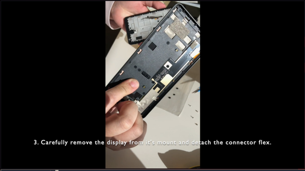

lawliett 77 Posted March 10, 2021 Share Posted March 10, 2021 Here's an image of him holding the display after removing it from the pro1. Can anyone tell what components are part of the display from this image? Quote Link to post Share on other sites
DieBruine 397 Posted March 10, 2021 Share Posted March 10, 2021 (edited) No way they send you 'just the screen'. Sometimes the people at support power down their brain momentarily. This causes an idiotic response, which triggers panic in the community. FxTec has never sent 'just a screen' to any Pro1 owner. It is always the upper part of the phone. Just the screen refers to the fact you receive half a phone. Choosing which color (colour for my British friends 🙃) indicates a frame around "just the screen". If they were to send you "just a screen" it would involve you prying the old one from its frame, cleaninout glue residue, applying new glue, replacing the screen and putting it all back together without causing any damage yourself. I honestly believe <25% of Pro1-owners is capable of doing just that. Even the technicians who assemble this thing in the factory make mistakes (three screen issues myself). So in short, you will be receiving the upper half including the frame. Your assumption is based on the answer given to you by an employee who's brain at the time was partially operational. This in turn could be caused by your question 👹. Edited March 10, 2021 by DieBruine 1 Quote Link to post Share on other sites
EskeRahn 5,604 Posted March 10, 2021 Share Posted March 10, 2021 3 hours ago, DieBruine said: It is always the upper part of the phone From the images it would be more accurate to describe it something like "The upper part, less the plate with the hinge-mechanism". But let us await an official answer to be sure. Quote Link to post Share on other sites
