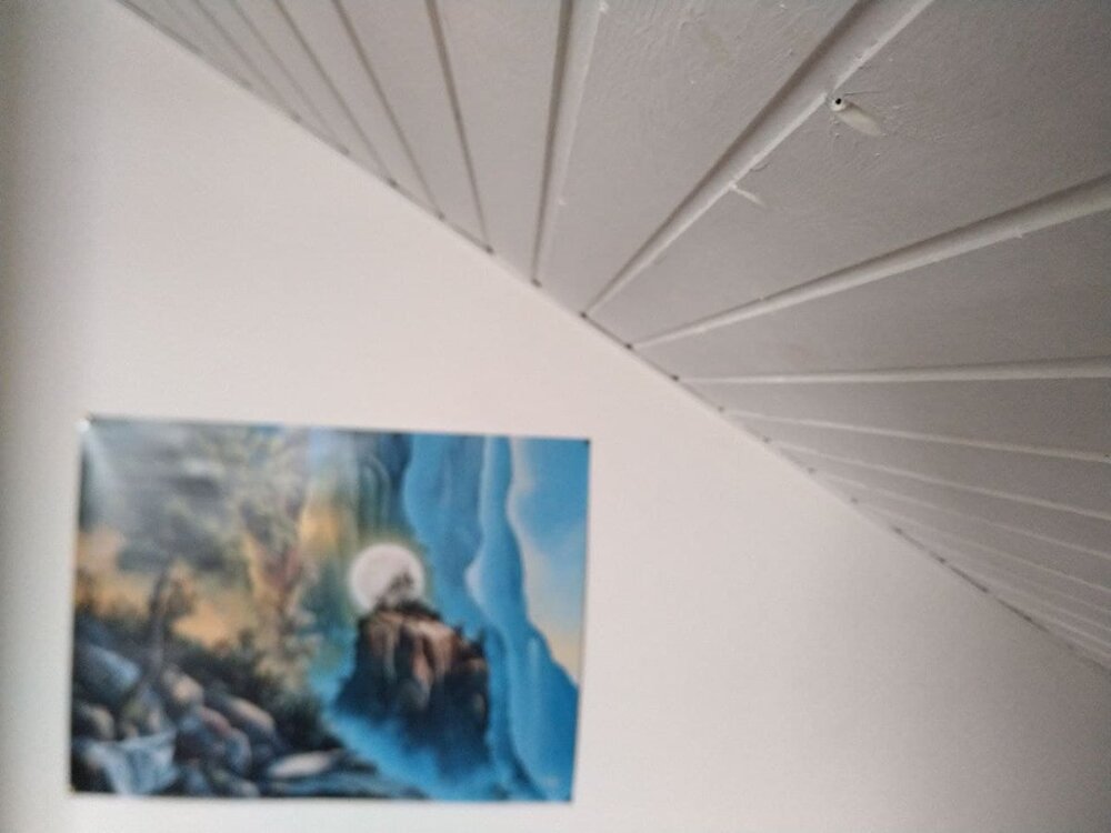

Jacob_S 128 Posted February 10, 2021 Share Posted February 10, 2021 (edited) I am now convinced, that it is indeed a hardware problem. Look at those two pictures. I stood straight in front of the wall and fixed the focus to the best I can aquire. Only change between those photos is that I turned my phone by 180°. And on one photo the ceiling is sharp and the picture very blurred, on the other photo the side of the picture is almost sharp and the ceiling is slightly blurry. Edited February 10, 2021 by Jacob_S clarification Quote Link to post Share on other sites

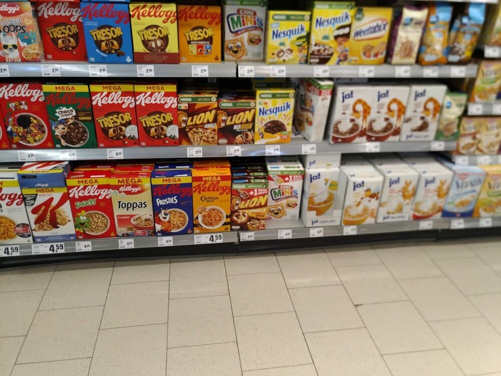

Jacob_S 128 Posted February 10, 2021 Share Posted February 10, 2021 If you look at this picture I took on Stock Android, you can also clearly see it, even though the image overall is more sharp. Back then I thought, that it was just the Snapdragon camera software misbehaving. 1 Quote Link to post Share on other sites
Jacob_S 128 Posted February 10, 2021 Share Posted February 10, 2021 Can somebody else of those having focus problems do a similar test? Because I'm not entirely sure, if it's not maybe two different problems and I just have the luck of having both at once. Quote Link to post Share on other sites
Rob. S. 1,667 Posted February 10, 2021 Share Posted February 10, 2021 (edited) I don't even have the Pro1 yet, but I'm quite sure that the image of that cereals shelf is proof enough that it's not a focus problem, it's that the camera's lens is decentered, internally slanted. There's no way a correctly adjusted lens on such a small sensor (with such a large depth of field) could see the left part of the shelf (halfway) in focus and the right part, which is only marginally further away, already totally out of focus. I'm sorry to say this has to be a defective camera. Edited February 10, 2021 by Rob. S. 2 Quote Link to post Share on other sites
fxtec-preorder-47xx 39 Posted February 13, 2021 Author Share Posted February 13, 2021 But Kelloggs on the left are more crisp than their cheap knockoffs on the right, no surprise. 5 Quote Link to post Share on other sites
