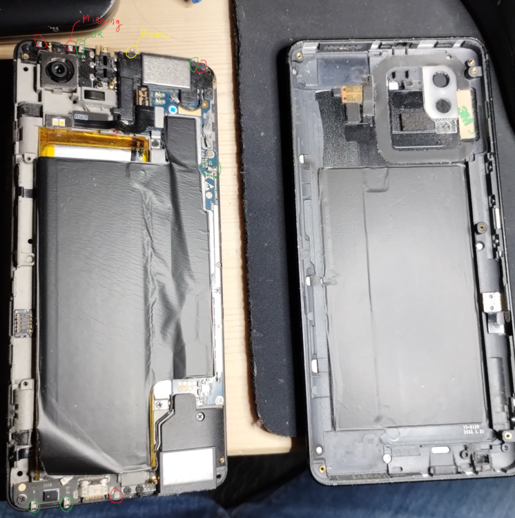

So, it appears that I was able to repair my Pro1-X's radios. Previously, telephony and mobile data wouldn't work for me, as documented earlier in this thread. WiFi, Bluetooth and GPS had always w
For anyone in Australia using 3G and worried about the impending shutdown of Telstra's 3G network, I finally figured out how to enable VoLTE. I am with Aldi Mobile (Telstra) and have been using the  "
It's hard to say whether these antenna connectors were broken when shipped, or due to disassembly on your part. Have  you've heard the antenna rattle inside the phone when you first received it? Would
Posted Images
Previously, telephony and mobile data wouldn't work for me, as documented earlier in this thread. WiFi, Bluetooth and GPS had always worked perfectly.
It turned out that my Pro1X was missing most of its "antenna" connector springs. My main antenna (aka. USB) board was missing two of its three connectors, and the last one broke off while I was diagnosing the problem. See picture attached.
It appears these things are really fragile.  Also my "diversity" antenna board was missing one connector, which I found rattling in a different place of the device.
So, if you have mobile connectivity issues, carefully open your Pro1X and check whether your "main" and "diversity" antenna boards look exactly like the pictures posted by @Casey here:
Long story short, I ordered both, a "main" and a "diversity" antenna board from F(x)tec. The USB/main antenna board is very easy to replace. Replacement of the diversity module requires soldering work that scared me off. So I rather re-glued the broken connector spring in place and keep the spare part ready for future repairs.
In result, the Pro1X now performs similarly to my Pro1 when it comes to mobile network connectivity.
This sounds like a very important find. I marked your post as recommended, and would love to hear some official comment on this. @Casey perhaps?
At the least that could explain why some sees this issue and some not, as it thus seems to be related to specimens, and errors in assembly (and QC).
Let's not jump to conclusions prematurely. I had opened the Pro1-X multiple times, so I cannot exclude that I broke these contacts off myself. One I definitely did, as noted above. That's also the reason why I did not try to make a warranty claim out of this.
Then again, two of the connectors seem to really have disappeared, so maybe they were missing from the start indeed. For sure the Pro1-X had its connection issues since the first time I put a SIM in it.
Lets see if others affected by the issue find the courage to open their devices, and discover similar problems.
12 hours ago, foxfreejack said:
I'm not sure why there's glue for those contacts on the board, but they should be soldered as well.
To me this means soldering wasn't great (or non existent!) to begin with and will induce all sorts of noise for cellular and wifi signal inside the phone to begin with.
Indeed, the contact springs are glued to the board. I cannot see any solder on my broken one.
I am no expert on RF signals. But I can imagine that, at the high frequencies involved, the capacitive reactance of the contact will always be very small, even if the ohmic resistance is non-zero. After all, the actual antenna is the metal body of the phone. And that is also not soldered to the circuitry, but just pressure-contacted by those springs ...

You are right we should not jump to the conclusion but it certinly sounds like a reasonable explanation why it is working for some and not for others.
And on this one
I wonder what havoc that could make, depending on where it 'lands'?. It does not have to be a 0 to 3.8V short circuit to cause trouble, could be 'anywhere' exposed.

15 hours ago, Casey said:
It's hard to say whether these antenna connectors were broken when shipped, or due to disassembly on your part. Have  you've heard the antenna rattle inside the phone when you first received it? Would that be the reason why you took apart your device to check?
Hi @Casey. Thanks for your thoughts on this problem.
Indeed, as I tried to make clear above, I cannot really exclude I did break the antenna contacts myself. One I certainly did.
No, I did not track this down because I heard something rattling inside the phone. I had previously opened the Pro1X's main body several times in the context of the battery depletion bug I had experienced, and because of the right-speaker-noise-at-full-charge issue. At that time, I did not pay much attention to the state of the contact springs (I did not even know what their purpose was). Though I do not remember breaking/loosing any, I cannot say for sure.
It was only after reading your above-cited post (where you explicitly mentioned the fragility of the contacts)
I figured this could be the reason for my long-standing mobile network problems.
I wonder how many folks affected by radio problems have actually previously opened their phones, unaware of how careful one needs to proceed, and that you should never insert your prying tool into the short sides of the phone ... The Pro1/X were much advertised as being easily maintainable. They aren't really in this respect ...
But do not get me wrong: I am not complaining. Thanks for providing me with those spare parts. For now, the Pro1X's modem seems to perform similarly to my >3-year-old Pro1's, at least in my living region. For the first time, and despite the former's remaining issues, I am actually now looking into configuring it to be a successor to the latter ...
Given how tight it fits in the shell, yes breaking something is more likely.
However, when a piece like this is soldered properly, it is more likely to peal the contact from the circuit board than break from the solder.
On your picture we can see all three contacts on the circuit board pretty much intact. Knowing enough about how radio works (not an engineer) you can have too much solder and induce other problems as well, so it's fine balance.

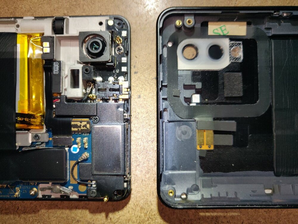

On 9/21/2023 at 11:06 AM, aaroncv3 said:
SImilar for me.  I have one of the springs that you're missing:
I will try using a small bit of metallic tape to bridge the presumed connection to case edge.  Will report back.
i 've just open mine to change screen, and see some spring are missing not, all that same like yours, and i have one spring broken (copper unstick from PCB)
Wifi was not excellent, 4G LTE not realy good (wcdma often better), and NFC not working

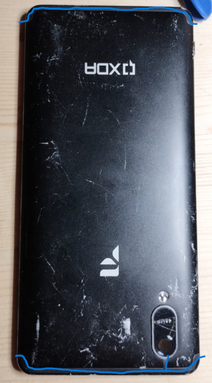

i saw somthing interessting, there is 3 metalic parts, on the back cover of the phone
One on the top, an other on the center, and last at bottom.
The black lines are not only for the beauty, this is insulation
