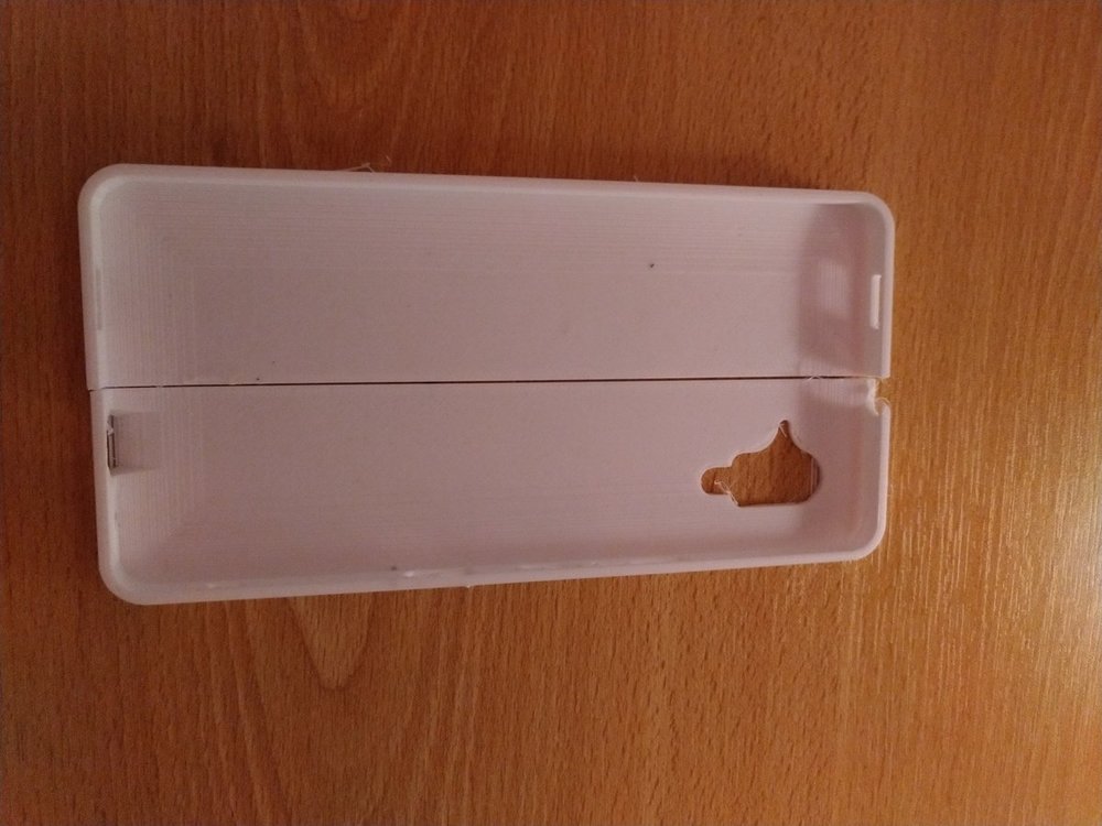

Bloodhoundje 78 Posted January 21, 2020 Share Posted January 21, 2020 (edited) First testprint made last night. I've split the bottom up in 2 parts to figure out how well the fit is. there is some slight (2mm) missalignment of the buttons and usb-c header and the camera placement is slightly off. I can now properly add the chamfer which is about 1.5mm (eyeballed, stil got to measure that tonight) and correct these errors. I expect the next version to be a perfect tight fit. from thereon I can start designing the mold and order some silicone to give it a try. @EskeRahn I will try to add a slight "edge" to the top of the cover to latch on the phone. There is some room to realize this (about 1mm). For the headphone and usb-c connectors I will likely go for an "open" approach. considering the line between the top/bottom on these is so thin that it would likely not last long anyways. as extra benefit it will be easier to get fitting connectors while the enclosure is around the phone. Also, would you guys prefer the buttons to be covered and the silicone to protect these (makes them tougher to click). Or would you prefer an open design around them with direct reach to the original buttons? p.s. Once this design is fully done I will offer the files in .STL and .STEP free of charge so anyone can print/use them if they want to 😄. Edited January 21, 2020 by Bloodhoundje Extra info 4 7 Quote Link to post Share on other sites
TeZtdevice 368 Posted January 21, 2020 Share Posted January 21, 2020 2 minutes ago, Bloodhoundje said: Also, would you guys prefer the buttons to be covered and the silicone to protect these (makes them tougher to click). Or would you prefer an open design around them with direct reach to the original buttons? First... great job! For these test print, it looks really good. +1 covered buttons with silicone. 2 Quote Link to post Share on other sites
EskeRahn 5,598 Posted January 21, 2020 Share Posted January 21, 2020 53 minutes ago, Bloodhoundje said: Also, would you guys prefer the buttons to be covered and the silicone to protect these (makes them tougher to click). Or would you prefer an open design around them with direct reach to the original buttons? Awesome job! On the buttons, I commonly see cases where the buttons are covered BUT the material is thinned around the 'block' covering the button. That is, there is a thin flex-zone that allows the button to move, . Apart from that, in my experience cutting cases for the Pro1, the opening for the fingerprint reader need to be rather large, and preferably with slanted edges towards the device Tried to make a rough and exaggerated sketch, blue button, orange case, read fingerprint reader 2 Quote Link to post Share on other sites

Sero 89 Posted January 21, 2020 Share Posted January 21, 2020 6 hours ago, Bloodhoundje said: First testprint made last night. I've split the bottom up in 2 parts to figure out how well the fit is. there is some slight (2mm) missalignment of the buttons and usb-c header and the camera placement is slightly off. I can now properly add the chamfer which is about 1.5mm (eyeballed, stil got to measure that tonight) and correct these errors. Once this design is fully done I will offer the files in .STL and .STEP free of charge so anyone can print/use them if they want to 😄. Please do! I'd be keen to print one out, or mess around with it. Cheers to @Keyahnig for the same. If I'm not mistaken, a lot of the cheap mass-produced flip cases are just a hard case glued onto a cover. Therefore with these STLs it hopefully shouldn't be too difficult to get a flip case that's good enough. And we can work from there 😄 1 Quote Link to post Share on other sites
EskeRahn 5,598 Posted January 21, 2020 Share Posted January 21, 2020 21 minutes ago, Serolfic said: If I'm not mistaken, a lot of the cheap mass-produced flip cases are just a hard case glued onto a cover. Therefore with these STLs it hopefully shouldn't be too difficult to get a flip case that's good enough. And we can work from there 😄 I can confirm that goes for the ones I have tested. 🙂 1 Quote Link to post Share on other sites

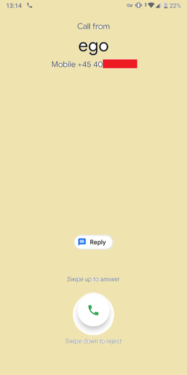

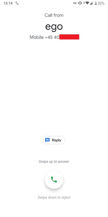

lameboyadvance 98 Posted January 23, 2020 Share Posted January 23, 2020 9 minutes ago, EskeRahn said: I doubt the window will fit, and especially not mounted up side down,,,, But could be wrong, If we are REALLY lucky then up side down small window will match the number, and the large one allow for a swipe up or down.... Is that a screenshot from a Pro1? It doesn't look the correct aspect ratio. Trying to resize that screenshot to fit this one from that site makes the screenshot way too long to fit the case in the picture. Quote Link to post Share on other sites
EskeRahn 5,598 Posted January 23, 2020 Share Posted January 23, 2020 18 minutes ago, lameboyadvance said: Is that a screenshot from a Pro1? It doesn't look the correct aspect ratio. Trying to resize that screenshot to fit this one from that site makes the screenshot way too long to fit the case in the picture. It is, after applying a red square and reducing to 40%. The Pro1 has 2:1 aspect ratio, and at least the uploaded image was 864x432. Here a fake one with a fill of the background (they use images from other phones in the listing...) Quote Link to post Share on other sites
