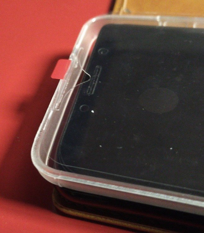

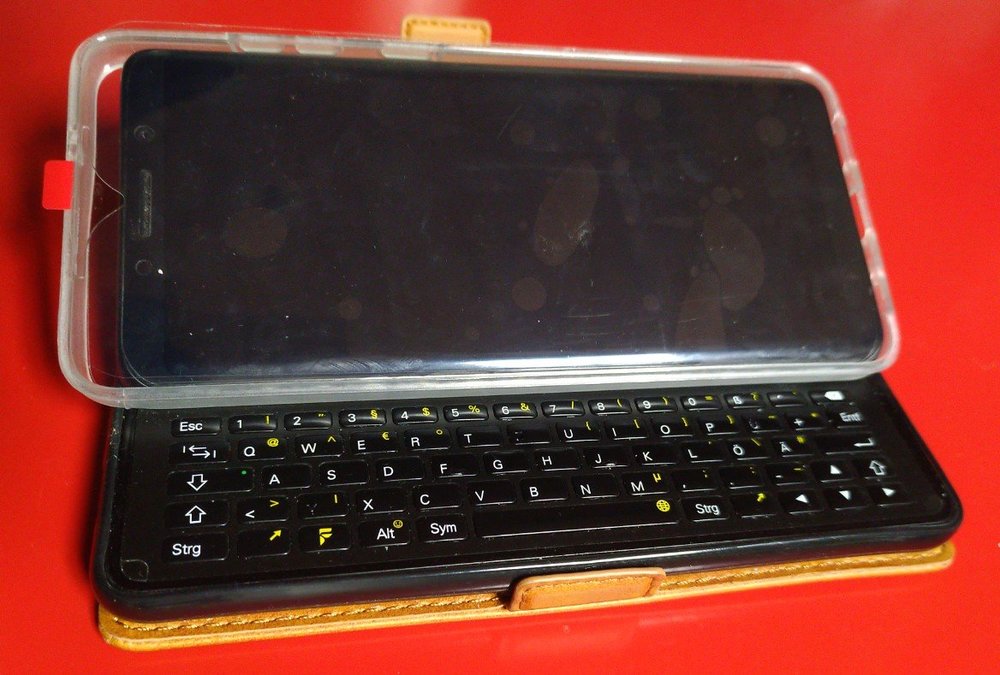

EskeRahn 5,598 Posted February 18, 2020 Share Posted February 18, 2020 As previously mentioned a S20+ full-body back-over-front case was expected to fit the screen, but too long. This morning this arrived, and well it does fit the screen sideways, and is too long, BUT it makes the edges of the screen out of reach, and that what not what I was hoping for. On the other hand the edge sticking out makes it easier to push up the screen. It is not for me, so I have not bothered to try to cut and melt it shorter.... 1 Quote Link to post Share on other sites

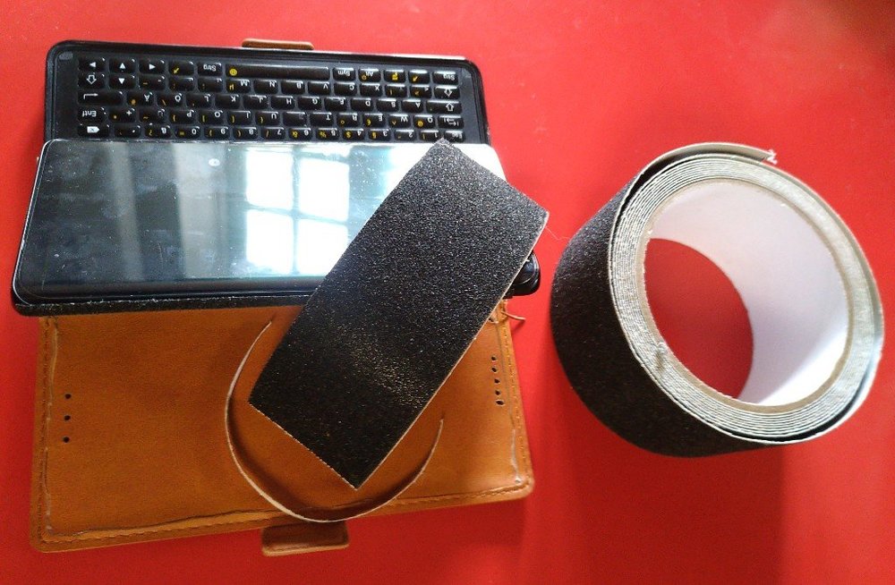

pistikem 86 Posted February 19, 2020 Share Posted February 19, 2020 like others i bought a Snakehive P20 Pro leather case but it didn't hold my Pro1 safely. i exchanged the original TPU holder with a TIYA P20 Pro TPU case which fits the Pro1 much better. one still needs to cut a hole or two into the TPU. importantly, opening the keyboard is now much easier, a klacks :) now i just need to find the right glue to bind the TPU plastic to the Snakehive leather case. i would refrain from the Spigen P20 Pro hybrid case - it just doesn't fit the Pro1, is too hard, too tight and too deep so that opening of the keyboard becomes a nightmare. 1 1 Quote Link to post Share on other sites
Slion 1,201 Posted February 19, 2020 Share Posted February 19, 2020 (edited) 11 hours ago, pistikem said: like others i bought a Snakehive P20 Pro leather case but it didn't hold my Pro1 safely Odd, mine is such a perfect fit on all 4 colour variants I own. Make sure you secure it to the bottom of the TPU housing especially if you are a pusher rather than a lifter. Pusher: people who think reading the docs is for noobs and keep insisting on opening their Pro1 by pushing the lower edge of the screen. Lifter: pretentious know-it-all people gifted with the ability to safely open a Pro1 by lifting the top edge of the screen. Usually equipped with just enough finger nail to operate. Edited February 19, 2020 by Slion 1 1 Quote Link to post Share on other sites
david 929 Posted February 19, 2020 Share Posted February 19, 2020 1 hour ago, pistikem said: i exchanged the original TPU holder with a TIYA P20 Pro TPU case which fits the Pro1 much better. one still needs to cut a hole or two into the TPU. importantly, opening the keyboard is now much easier, a klacks :) Thanks for posting. I ordered one of the TIYA cases to try out. I like the bumper corners. 1 Quote Link to post Share on other sites
david 929 Posted February 19, 2020 Share Posted February 19, 2020 (edited) 2 hours ago, Slion said: Odd mine is such a perfect fit on all 4 colour variants I own. Make sure you secure it to the bottom of the TPU housing especially if you are a pusher rather than a lifter. Pusher: people who think reading the docs is for noobs and keep insisting on opening their Pro1 by pushing the lower edge of the screen. Lifter: pretentious know it all people gifted with the ability to safely open a Pro1 by lifting the top edge of the screen. Usually equipped with just enough finger nail to operate. Nudger: People who want to make use of the nail side of their thumbs just as much as the soft typing side. Slide each thumb nail between the two halves and nudge the screen forward, easily opening. Or one thumb opening, and other hand keeping the phone from making a racket, by slowing down the screen until final impact. Edited February 19, 2020 by david 1 2 Quote Link to post Share on other sites
Slion 1,201 Posted February 19, 2020 Share Posted February 19, 2020 (edited) 3 hours ago, pistikem said: i exchanged the original TPU holder with a TIYA P20 Pro TPU case which fits the Pro1 much better I would have first tried using double sided sticky tape with the original TPU housing before going this way. That should work nicely unless you are taking your phone out of the case too often. 3 hours ago, pistikem said: now i just need to find the right glue to bind the TPU plastic to the Snakehive leather case. Do let us know how it goes as I might be considering a similar mod at some point. I was thinking of taking a Snakehive P30 Pro case, as the camera cutout works better with Pro1 and replacing the TPU housing. How did you separate the TPU housing from the leather? Is it glued on ? Edited February 19, 2020 by Slion Quote Link to post Share on other sites

EskeRahn 5,598 Posted February 19, 2020 Share Posted February 19, 2020 7 hours ago, david said: Nudger: People who want to make use of the nail side of their thumbs just as much as the soft typing side. Slide each thumb nail between the two halves and nudge the screen forward, easily opening. Or one thumb opening, and other hand keeping the phone from making a racket, by slowing down the screen until final impact. We should consider this in the how-to-open thread.... Another option is to add some of the adhesive anti-slip tape intended for stairs (black or transparent) e.g. this And cut a roughly 2-3 x 150mm piece (Use a hobby knife or similar, as the sand kills the blade, do not use a good pair of scissors...), and put along the back edge. (so it does somewhat belong in the casing thread...) This will give you a VERY easy lift. (The same material is GREAT for compact cameras with slippery surfaces like Sony RX100 III) Mine ended on 3mm+ and could/should have been less. 1 1 Quote Link to post Share on other sites

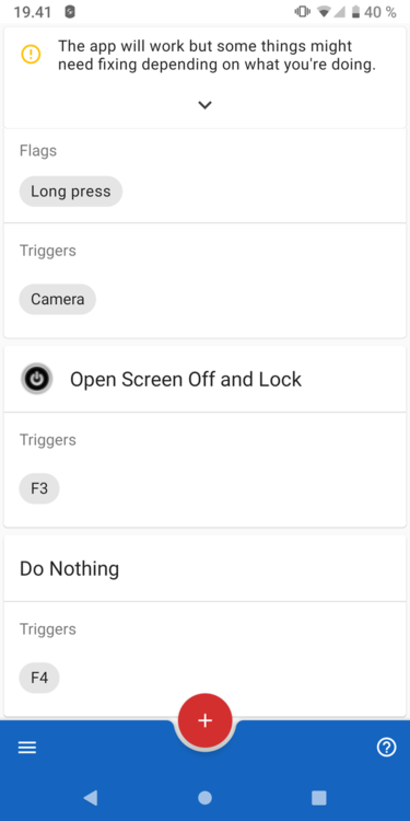

Slion 1,201 Posted February 20, 2020 Share Posted February 20, 2020 (edited) On 2/18/2020 at 5:11 PM, EskeRahn said: Then we will have to wait for F(x)tec to change F3/F4 Actually there is an easy way to get the phone to lock and wake upon closing and opening your case. Just use Key Mapper. Unfortunately, it can only lock as admin thus preventing you to use the fingerprint reader. However, the source code is available therefore we should be able to implement normal lock using accessibility service. I'm not sure if wake up could be implemented in the same way. I guess it could:https://stackoverflow.com/questions/2891337/turning-on-screen-programmatically So there you go, someone needs to jump into Key Mapper code and implement those two actions. Android is awesome!!! Edited February 21, 2020 by Slion 1 1 Quote Link to post Share on other sites

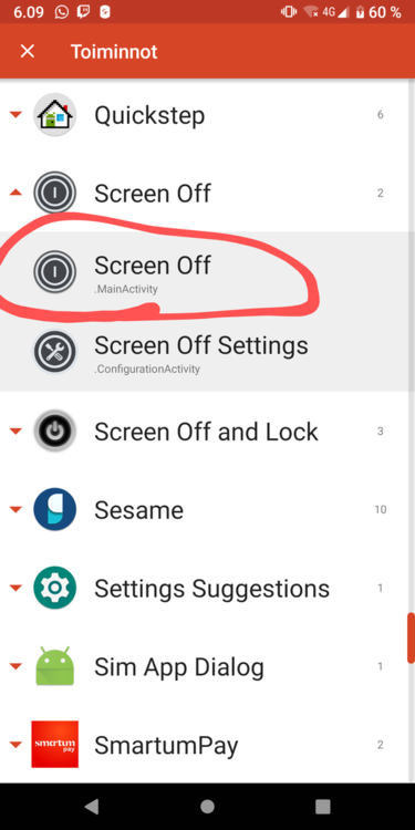

FlyingAntero 871 Posted February 21, 2020 Share Posted February 21, 2020 On 2/18/2020 at 2:34 PM, Slion said: Sadly it does not work. Whatever is sending those is bypassing the Key Mapping framework somehow and thus not taking into account overrides from KCM. I'll give it another try later but it those look like we are out of luck on that one. I didn't quite understand this so I am just asking for a confirmation. Did you try open or close the case during recording the trigger in Keyboard/Button Mapper? Because that app is able to recognize the slider movements (open&close). I can add an action to that trigger if I want. Is the other hall-probe different than the one for detecting slider open&close? Quote Link to post Share on other sites
EskeRahn 5,598 Posted February 21, 2020 Share Posted February 21, 2020 3 minutes ago, FlyingAntero said: Is the other hall-probe different than the one for detecting slider open&close? It is a different sensor,in the display part, close above the volume up. 1 Quote Link to post Share on other sites
FlyingAntero 871 Posted February 21, 2020 Share Posted February 21, 2020 (edited) 3 minutes ago, EskeRahn said: It is a different sensor,in the display part, close above the volume up. Yes, I do understand that thing. I am just thinking that is that sensor acting differently compared to the slider sensor. If Keyboard/Button Mapper can recognize the slider sensor why it cannot recognize the other one ("flip case sensor")? I can not test it right now by myself but I am planning to test it later. Edited February 21, 2020 by FlyingAntero Quote Link to post Share on other sites

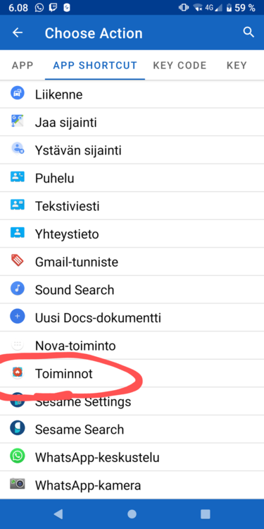

FlyingAntero 871 Posted February 21, 2020 Share Posted February 21, 2020 @EskeRahn and @Slion, I tested my phone with magnet and I was able to lock via the hall-probe sensor. I used Keyboard/Button Mapper and Screen Off and Lock apps. Mapper detect when I remove the magnet but I don't know which action could wake up the screen. 1 3 Quote Link to post Share on other sites
Slion 1,201 Posted February 21, 2020 Share Posted February 21, 2020 Looks like this app has the same problem as Key Mapper built-in lock action. It prevents you to unlock with fingerprints. Quote Link to post Share on other sites
FlyingAntero 871 Posted February 22, 2020 Share Posted February 22, 2020 (edited) 4 hours ago, Slion said: Looks like this app has the same problem as Key Mapper built-in lock action. It prevents you to unlock with fingerprints. If you want to unlock with fingerprint you need to use Screen Off - Unlock with fingerprint app. Screen Off and Lock does not support that. Also, you can't just select Screen Off - Unlock with fingerprint from Keyboard/Button Mapper. You need to install Nova Launcher and use Nova actions as an activity. Select Screen Off .MainActivity. You can still use stock launcher as a default launcher. I tested this and I am able to lock with magnet and unlock with fingerprint like normally. Edited February 22, 2020 by FlyingAntero 2 2 Quote Link to post Share on other sites
